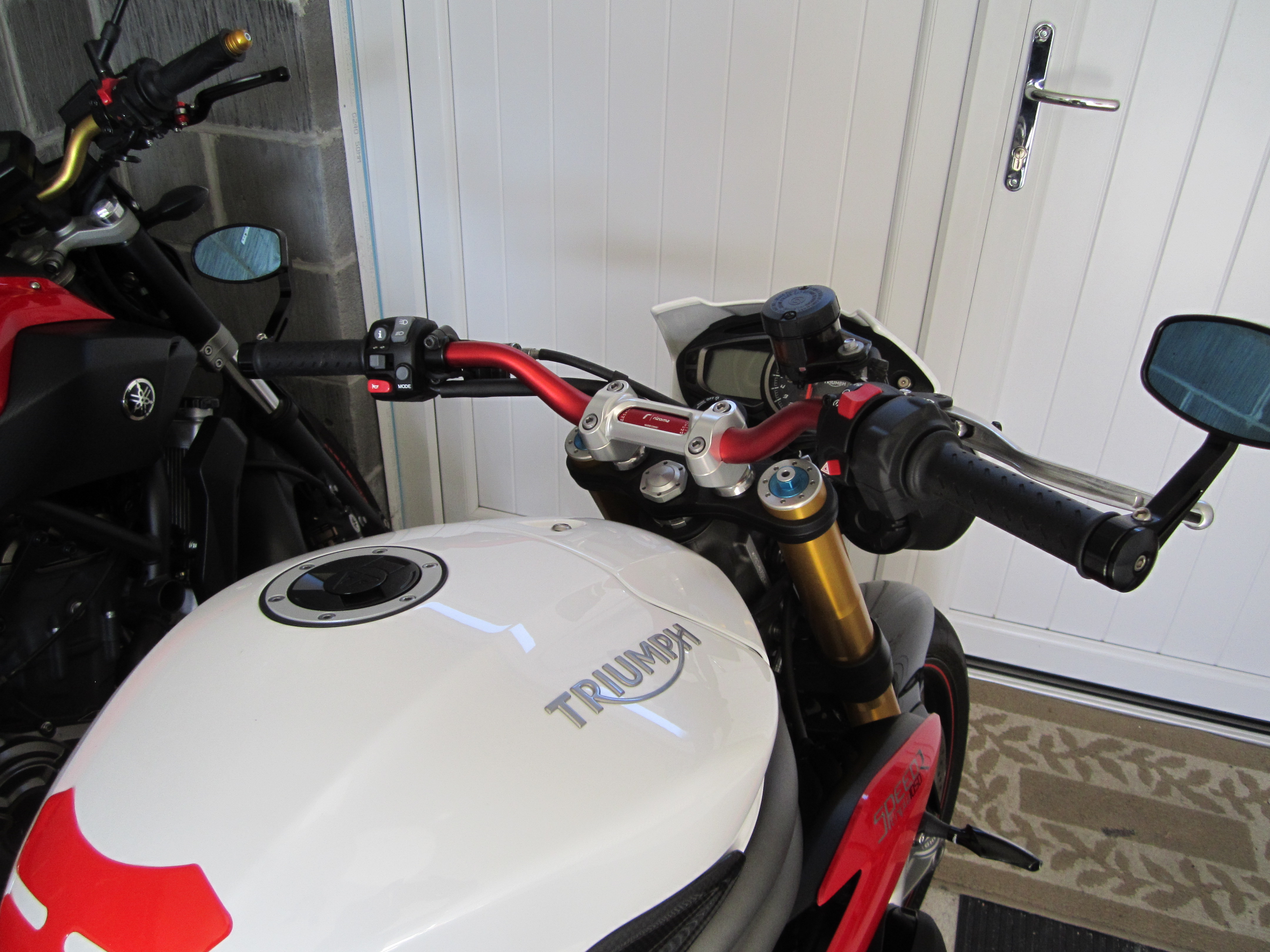

  6. darkman
    7,657
    IMG_1210.JPG Pix of 50mm bars

  8. darkman
    7,657
    Thanx Tony, i have short arms n legs and these bars allow me to pull them back another inch making a huge difference if i am pottering along :) red well you just have to lol
