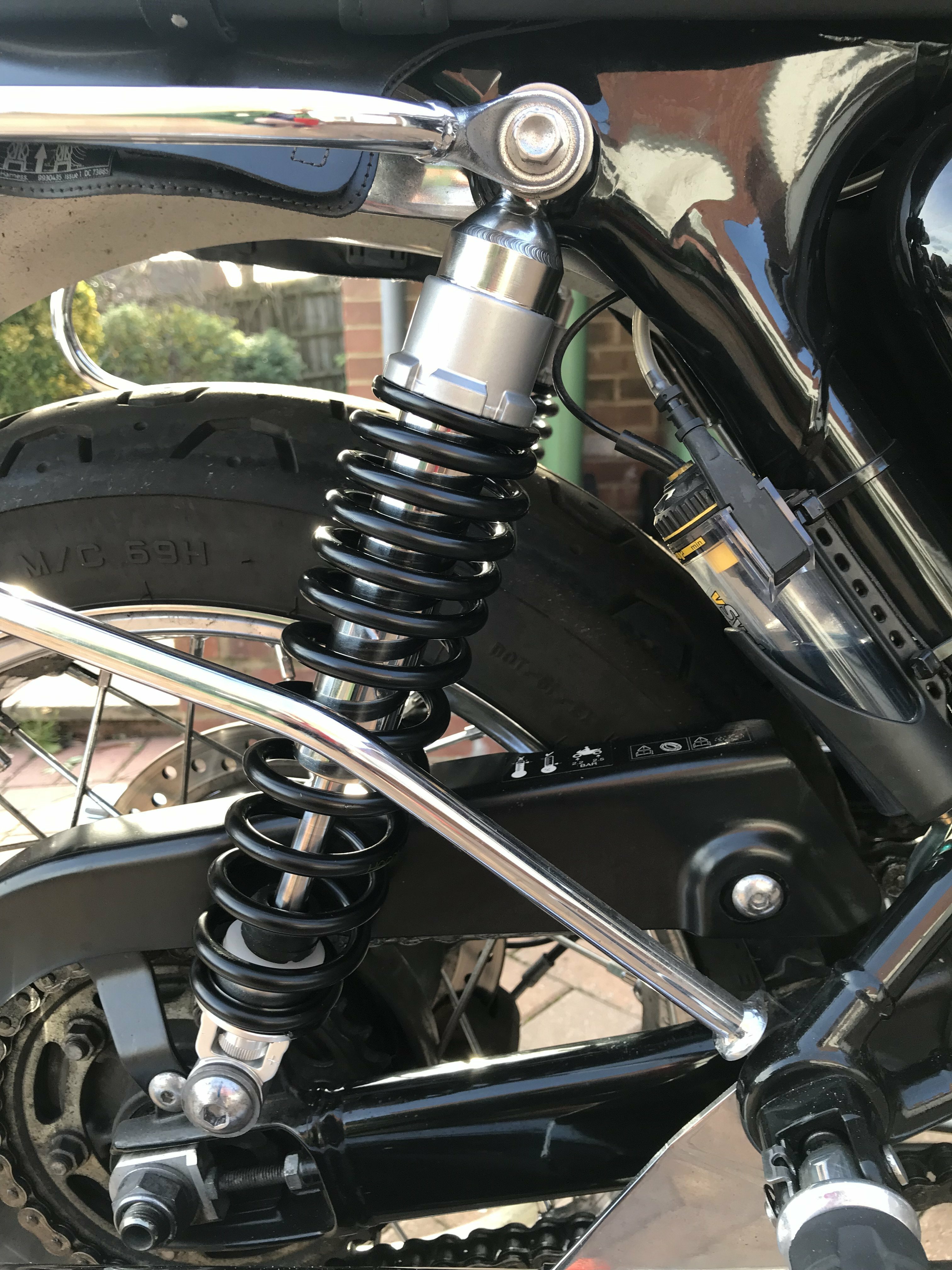

    A rare venture for me, spanner work. Having convinced myself that the handling of my T120 could be improved I decided to fit some Hagon 2810s. Not as flash as Nitros but I figured I wasn’t ever going to use their potential in the first place so I saved myself a couple of hundred quid. I rang Hagon and as been reported elsewhere they were very helpful. In fact after explaining I was a short arse we decided to try a pair which were shorter than standard. They built some that were 1cm shorter than stock and they duly arrived 2 days later.
    I’ve just fitted them today after acquiring a Norbar torque wrench from eBay. Took me about a hour to sort it all out with a bit of horsing to get them pushed on. I used a bit of wood to wedge up the rear tyre to get the height for fitting.
    Not got for a spin yet. So will let you know if they make a difference. If you don’t hear from me again it’ll be because of my spanner work and they’ve come off.

    It’s stiffer, harder, it handles better and I’ve lost 1cm...on the rear shocks that is. Just first impressions on a short run around town and I think this has been a worthwhile upgrade. I didn’t make any changes to the front end and at present I’m not planning to. I’ll give this change a bit of time first.
    First thing I noticed was the stiffness going over bumps. Not in a bad way, it was like driving a BMW when you are used to Citroen kinda thing. Noticibly quicker into corners and I can put a bit more of my feet down at junctions. The loss of 1cm in the shocks hasn’t caused anything to knock or break and I’m pleased to say my spannering was good as no bolts fell off.
    I’ve posted a picture of the shocks, you’ll notice I’ve taken the Hagon stickers off with hair dryer to get them peeling initially.
