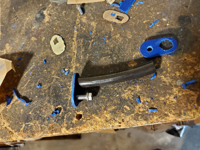

It does state that they need to be relocated, so does the hepco & becker version. What I didn't expect was the unfinished look of the relocation (I should have been clearer) - seems like several different bikes have turnsignal relocation issues, and looking at some kits for Harley's gave me an idea. Fiddled around last night and carved some oval-shaped coverplates out of some soft craft plastic I had lying around. Grabbed a piece of glossy black tubing and I think I will have a finished appearance I can accept. I will post the finished version once it's all mounted up.
Got the TEC luggage rack and signal relocation in. Thought I'd post some pics to show how I (tried) to clean up the install... I am mostly satisfied with this set up. My rack didn't seem to be misaligned, although the attachment screw for the the right side turn signal makes contact with the rear fender, which tells me the rack is slightly skewed to the left. You can sorta make it out in the last pic. The cover plates and tubing cleaned up the relocate somewhat. The first pic is from before I painted them to show what the heck I am talking about. On a whim, I cracked open the headlamp to see if the front signals could be relocated to the rear... Thought I was brilliant for a moment, as the front signals have long (too long imo) stems which would have worked perfectly in the rear. I though maybe they used the same LED boards as the rear, but as the wiring connections were different, I left them alone. I found these spacers on AJ Cycles and ordered two pairs to try them out: https://www.ajcyclesny.com/product/analog-signal-pod-25mm-spacer-kits-pair/ Unfortunately I needed ~40mm, so I will try gluing two together for 50mm extension per pod and then move them back up to the stock locations, taking them off the rack (which I still think looks kinda wonky) and hopefully keeping that right SS screw from digging into the aluminum fender too much.
