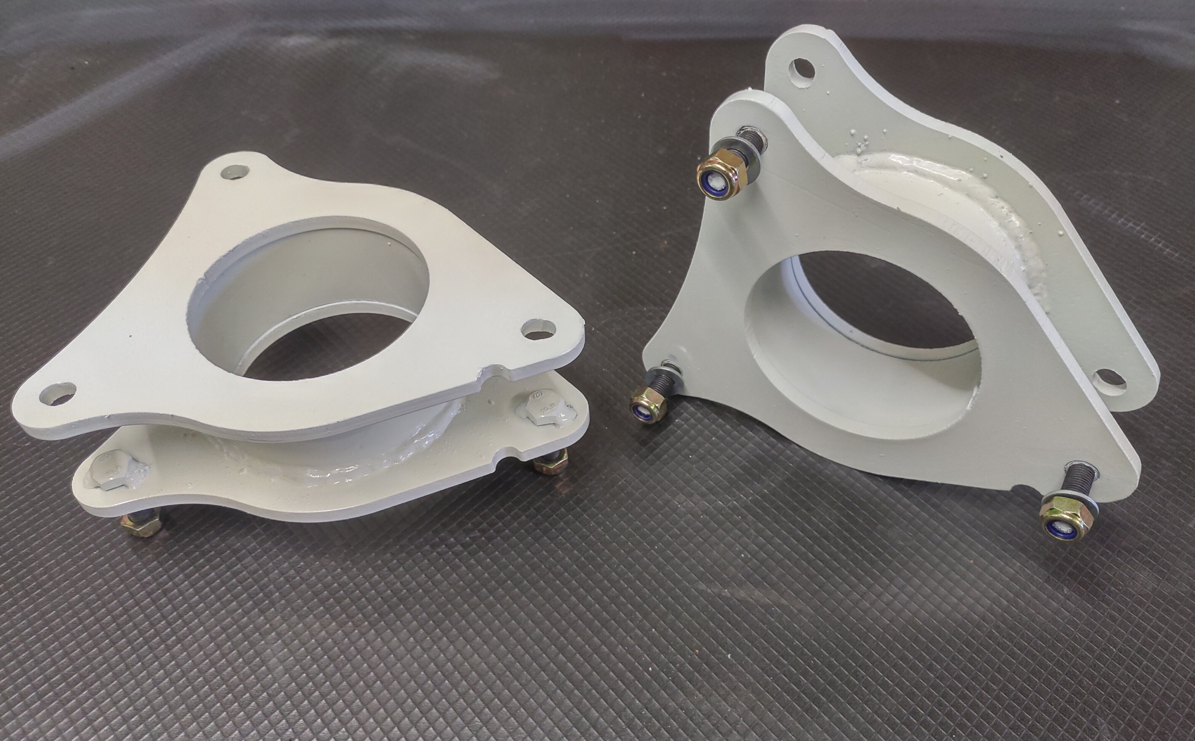

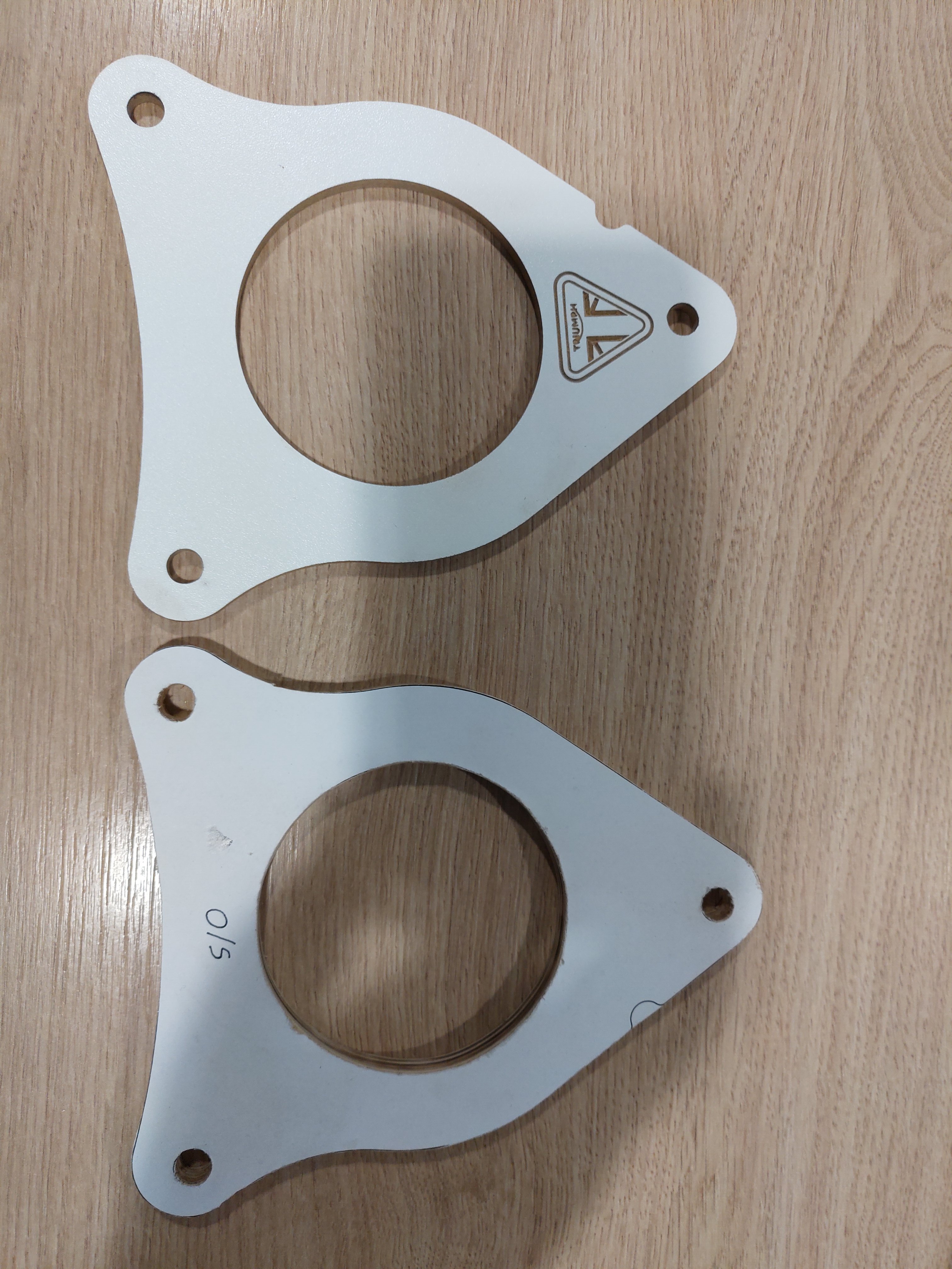

    Finally found time to get the suspension lift sorted. I've lifted the rear suspension by 20mm by adding spacers and longer bolts. Finished designs on the front, and @andyc1 drew them up for me. :kissing_heart::heart_eyes:
    Took the drawings into the Lazer profiler mate of mine, should be ready for Friday:D
  2. MrOrange
    Suspension lift made !! Only taken six months :laughing:.

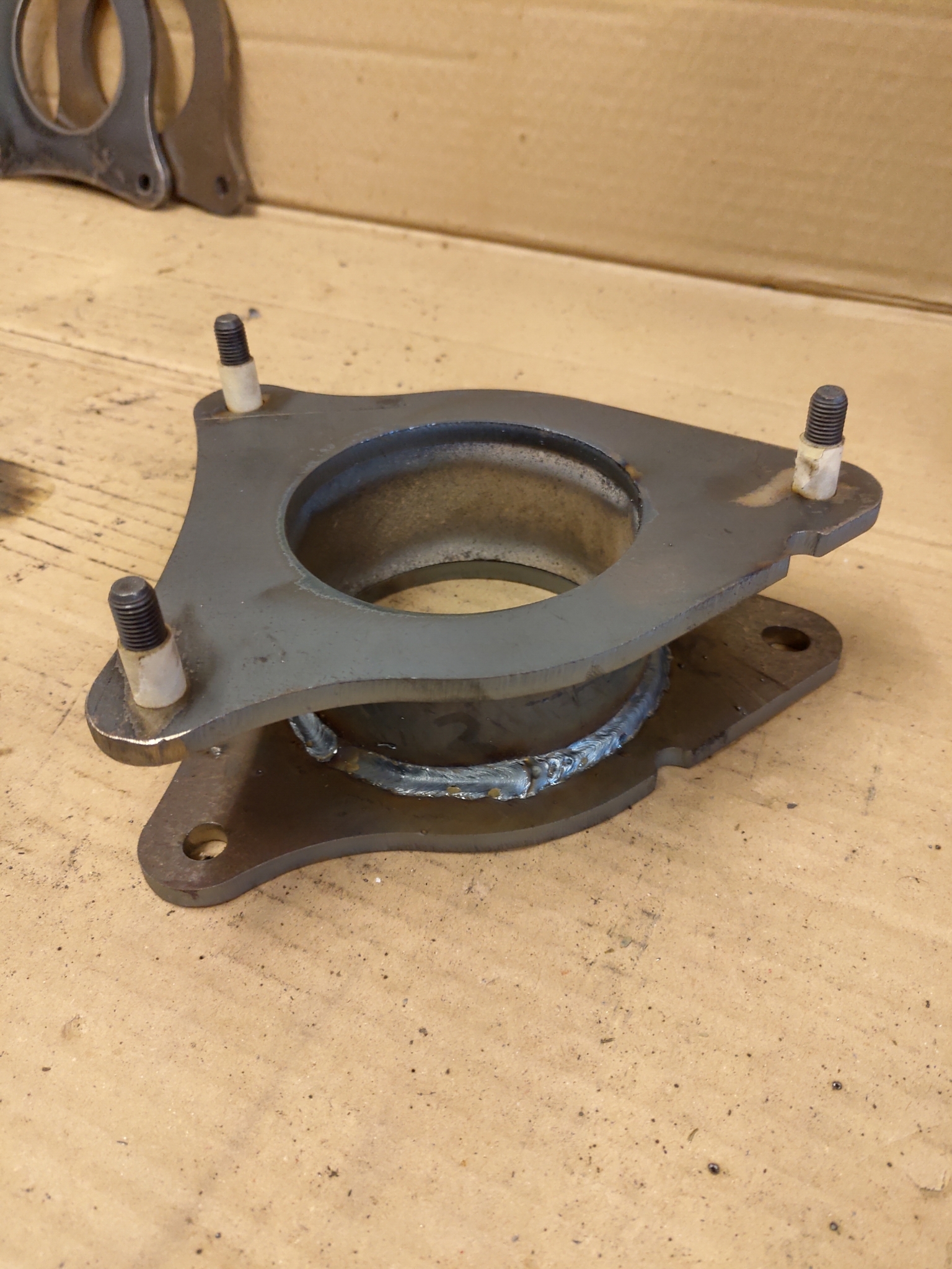

    AndyC1 did a great job of drawing up, so cheers for that bud. Got the plates eventually cut by another pal, and didn't even charge me (took 2 weeks tho:D), and an ex-pupil came round and welded them up for me. I can weld, but not to the same standard as him, so £20 well spent on his coded welding skills. Went full 2" lift, can cut them down if need be. That's easier than trying add more on. Was going to powder coat, but painted them as cutting down would be easier. If they are good, I'll take them off and get them done when I upgrade the front shocks to a pair of Bilsteins I have my eye on.

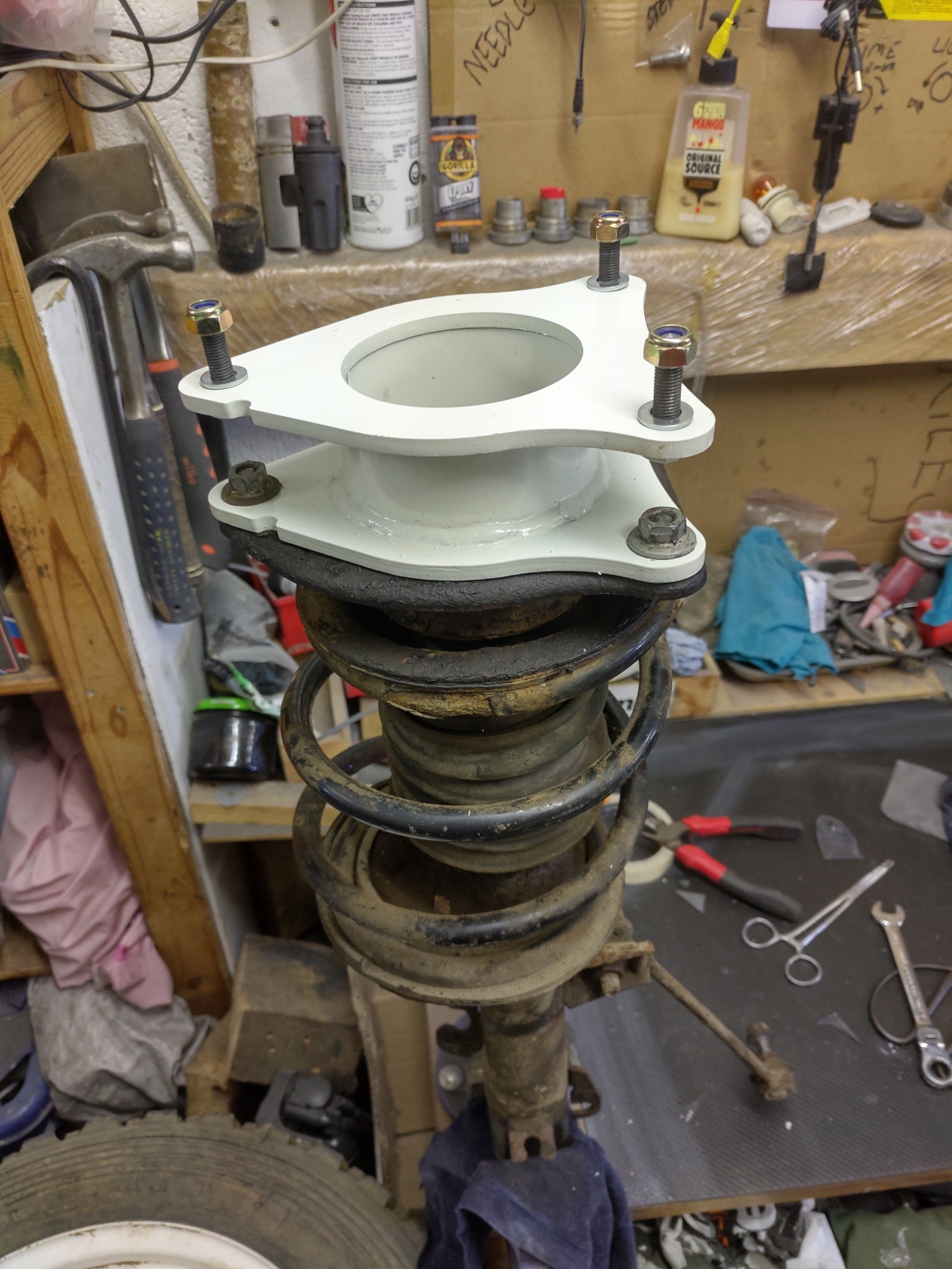

    That's her raised 2"a the front and 1" at the rear.
    Hell of a struggle getting the extended front strut in. Bottom arm wouldn't drop enough, so ended up compressing the strut to get it in,spring compressor and trolley jack to squeeze it in.
    Quick spin, everything seemed good. Could definitely feel the front raised up. Off to get it tracked this week.
