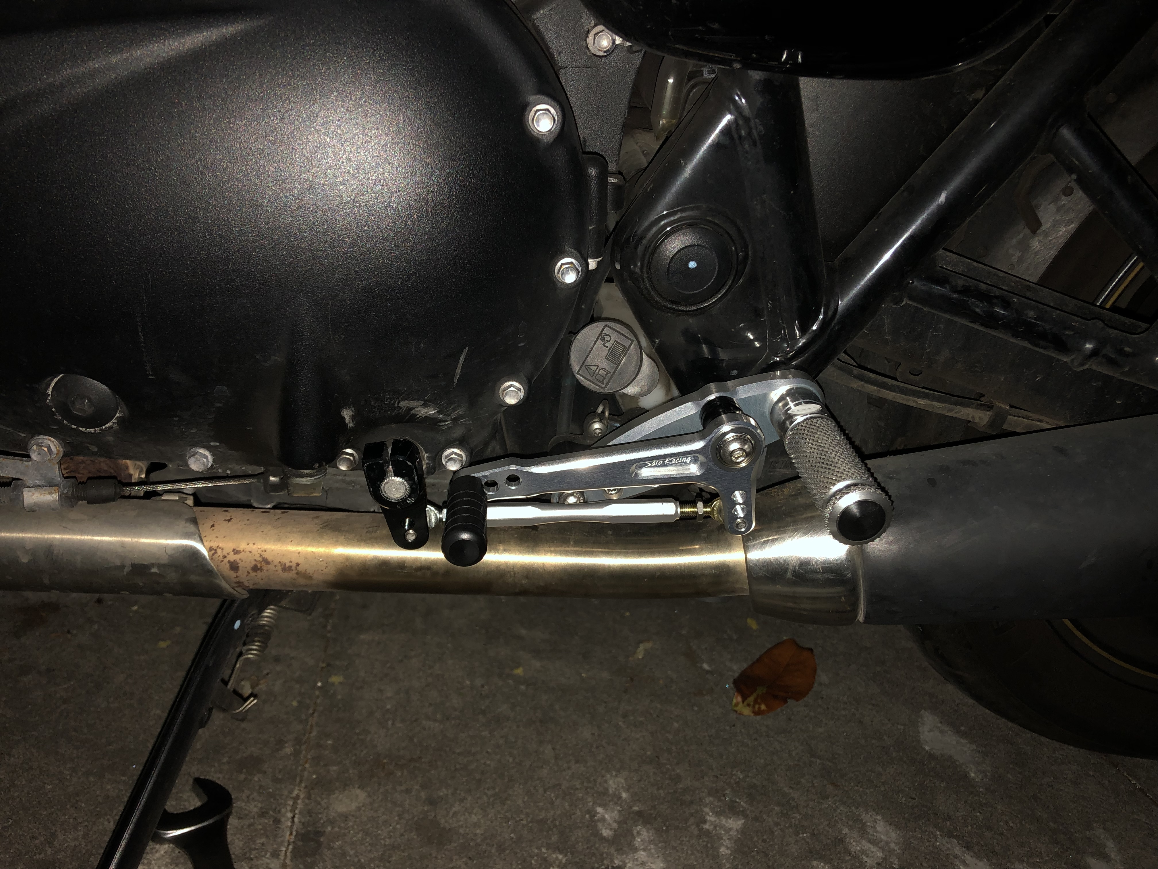

    I have recently installed the Sato Racing Rearsets pedals on my Street Cup.
    The installation was quite easy and Rearsets are well done.
    I made a test ride after the installation and everything worked fine except the position of the pedals were uncomfortable.
    I reset the pedals in a comfy position and, when I switched on the bike, i didn’t see any update info to my digital screen on speedometer. I’m able to change gear only in 1 or in neutral. I can’t change in 2nd, 3rd, 4th or 5th gear.
    Can anyone suggest me something to do before going to the dealer?

    A picture would help others assist ?

    I’ll post soon. I didn’t take any

    Sounds like the adjustment has limited the movement of your selector shaft . Is the angle between the actuator rod and the joint on the selector shaft or rearset too acute ? Maybe some pictures on here would help with some suggestions . If it was working OK then stopped after adjustment it should be a simple issue.
    Ideally you want the joints to be close to 90 degrees to the actuator rod. I hope that makes sense
    so maybe you need to rotate the joint on its splines to suit the new position ?

    Initially I mounted the actuator rod perfectly at 90 degrees and the gear worked fine. When I adjusted the actuator rod, I moved it at 60 degrees. There is no block between the selector shaft and the actuator rod. I'll be more precise when I post the pictures

    The fact you can move the lever down but not up, suggests something in the way, or your at the end of your travel.

    People I’ve solved! I removed and mounted again the actuator rod, switched on the bike and magically the gears entered properly ❤️❤️❤️
