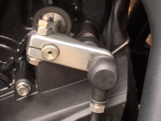

  9. Sprinter
    6,027
    Found this on ebay and cropped it
  10. crispey
    7,198
    Ok it's sorted, I should have learnt not to bother with google and stories of broken gear boxes etc!! There was a punch mark which you line up with the gap in the lever! All sorted!!
    Seemingly it's a common occurrence these things shaking loose and the fact it's screwed in from the bottom doesn't help, so to make doubly sure it doesn't happen again.....,
    Thanks for all your help!!
