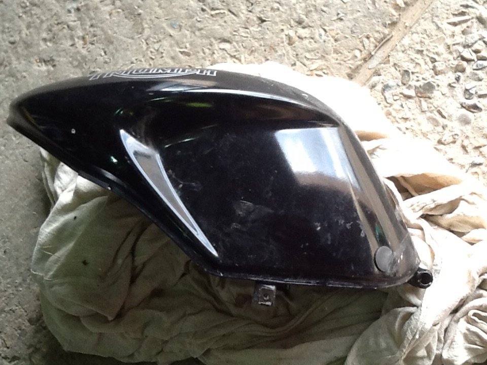

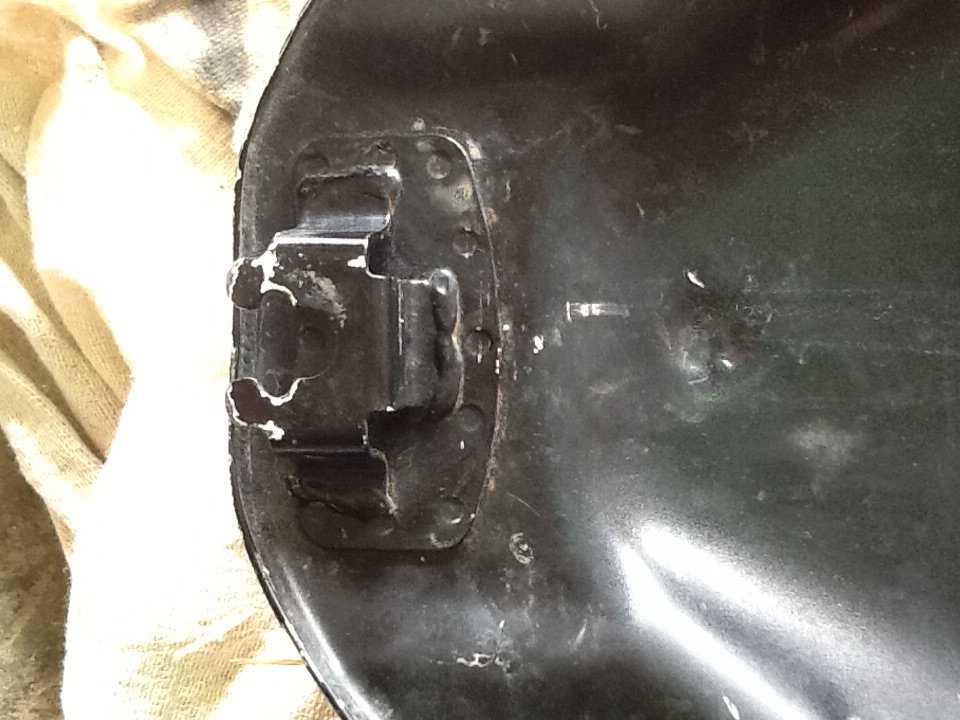

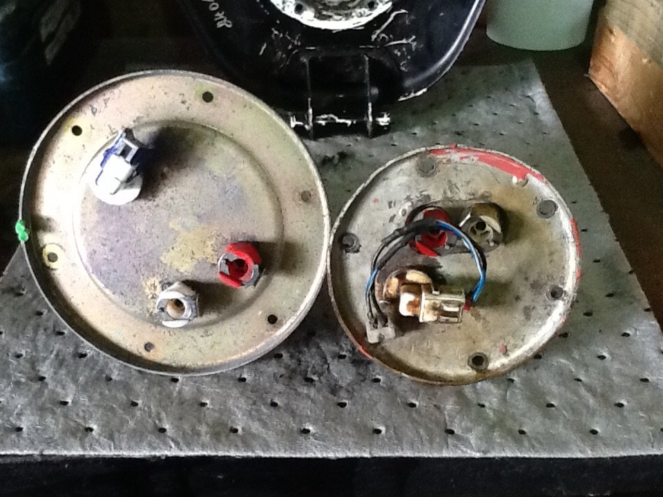

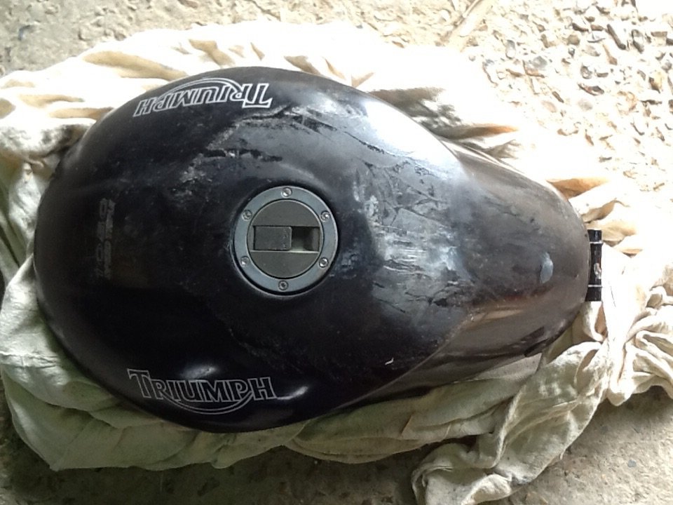

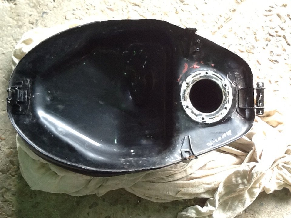

    Pics of the new pump on left from TT600 and my original pump on the right. A huge difference in diameter!
    Pics of tank from different angles and one of the front fixing.
    Any ideas regarding the pump anyone?
    My thoughts are to shotblast the original pump plate and have it electroplated and then fit the parts off the TT.
  11. thebiglad
    5,072
    Before you do any swapping of bits, have you checked to ensure that the TT600 pump actually works by connecting a 12 volt feed to it? You could do the same to the old one as well, just to confirm it's the pump at fault not the wiring/connectors??

    Just a thought, can you fit the pump from the larger plate to the smaller one if the smaller one is not working ?

    There is power to the fuel pump, the original pump was seized but is now free. I can use all of the parts off the new pump, which does work and fit it to the old base. But I'm thinking whether to buy this tank on eBay, item number 361248421950 which accepts the larger base plate.
    From the photos on the listing, it looks like it would fit.......but I think I've already made that mistake before!
