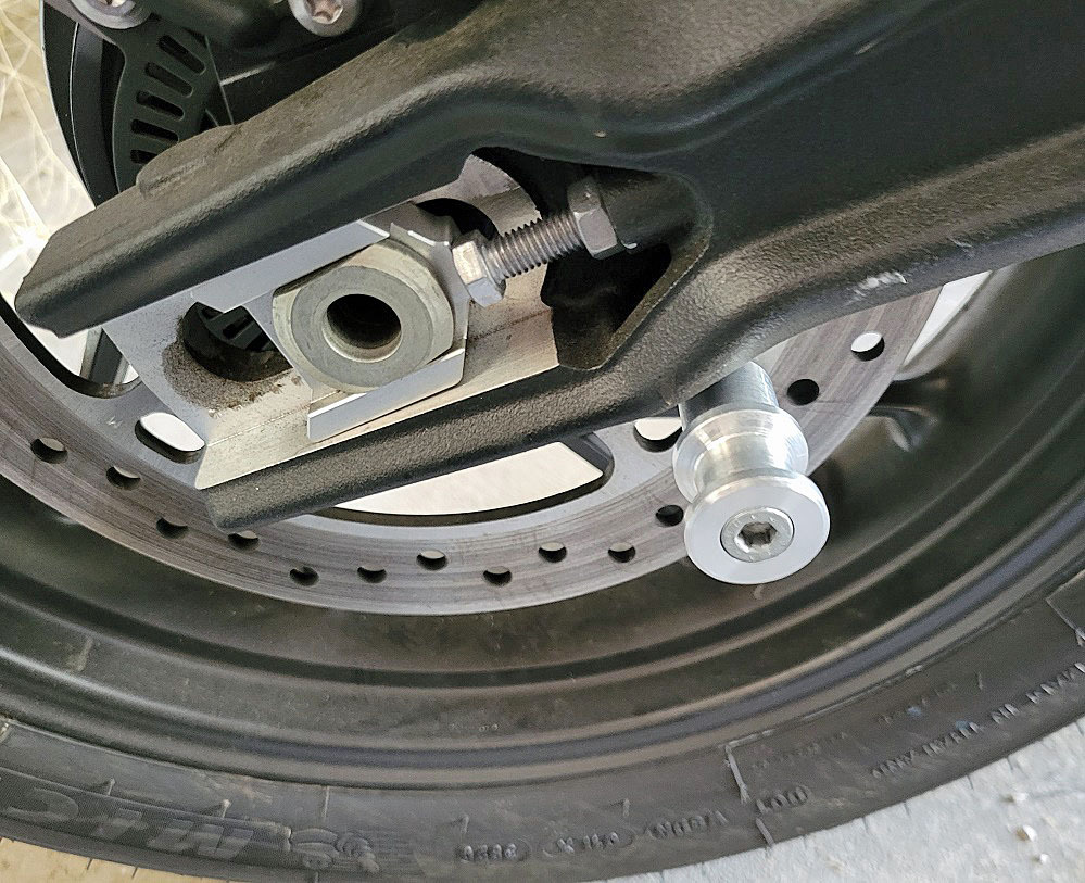

    At first I thought it was the tire or pressure, but it was the shock.
    Have a cheap fix, though.

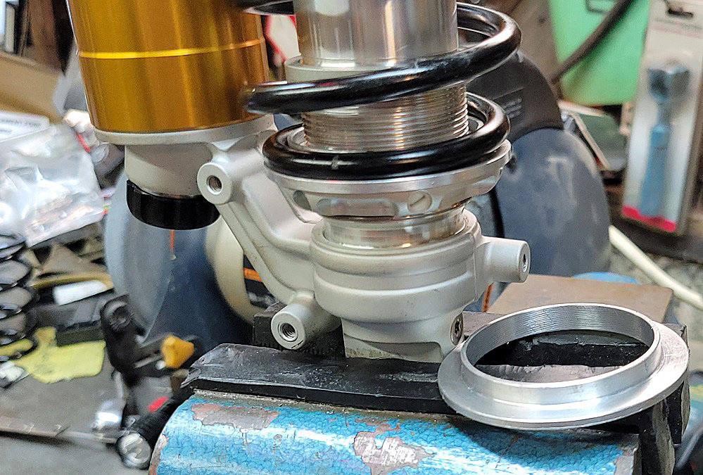

    Blue spring was just for the initial fitment. .
    Red 750 Lb spring from Penske was the final choice.
    Had to go with a shorter spring to get the adjustment collars
    to the top of their adjustment for clearance inside the lower mounting cradle.
    Had to carve just a bit off the lower shock casting, as well.

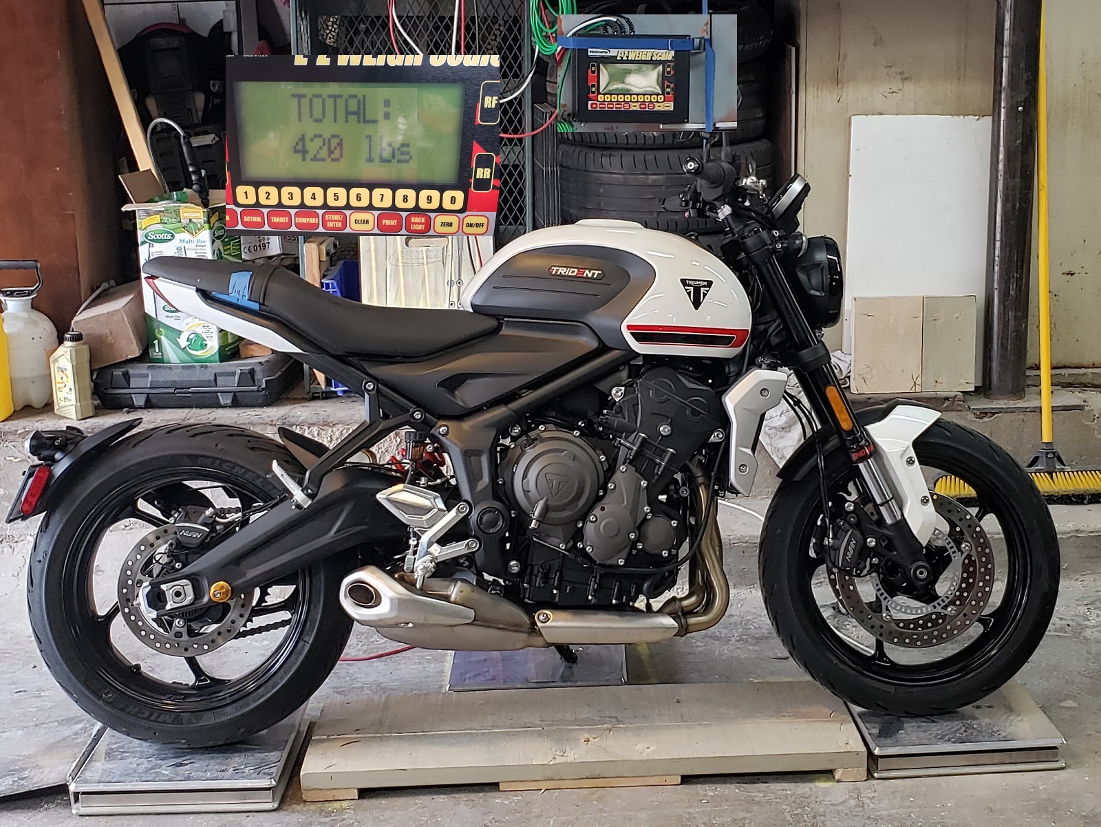

    Real weight with Lithium battery and full tank of gas.

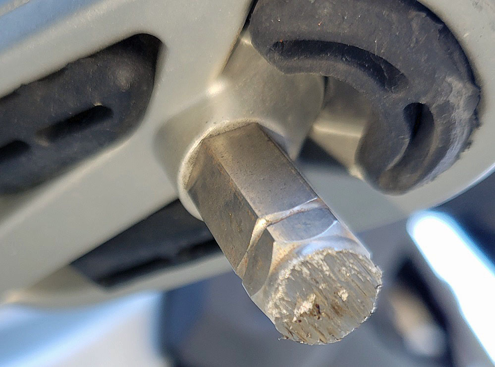

    Made some rear stand spools, which had to be extra long due to
    the thread being so far inside.

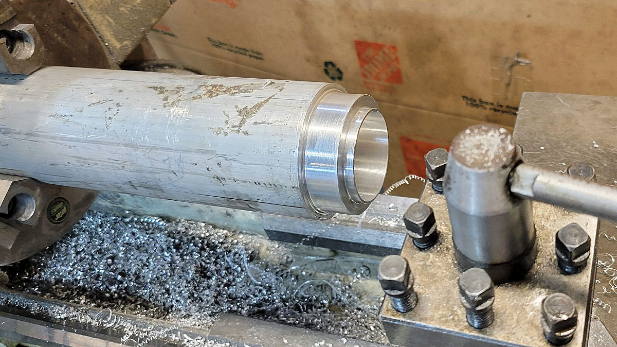

    The rear shocks were lowered by using softer springs.
    They were the shorter ones as each shock has 2 springs.
    They were a sloppy fit , having 3 mm clearance on the ID at 1 end.
    Made some insert / collars since I hate sloppy fits.
