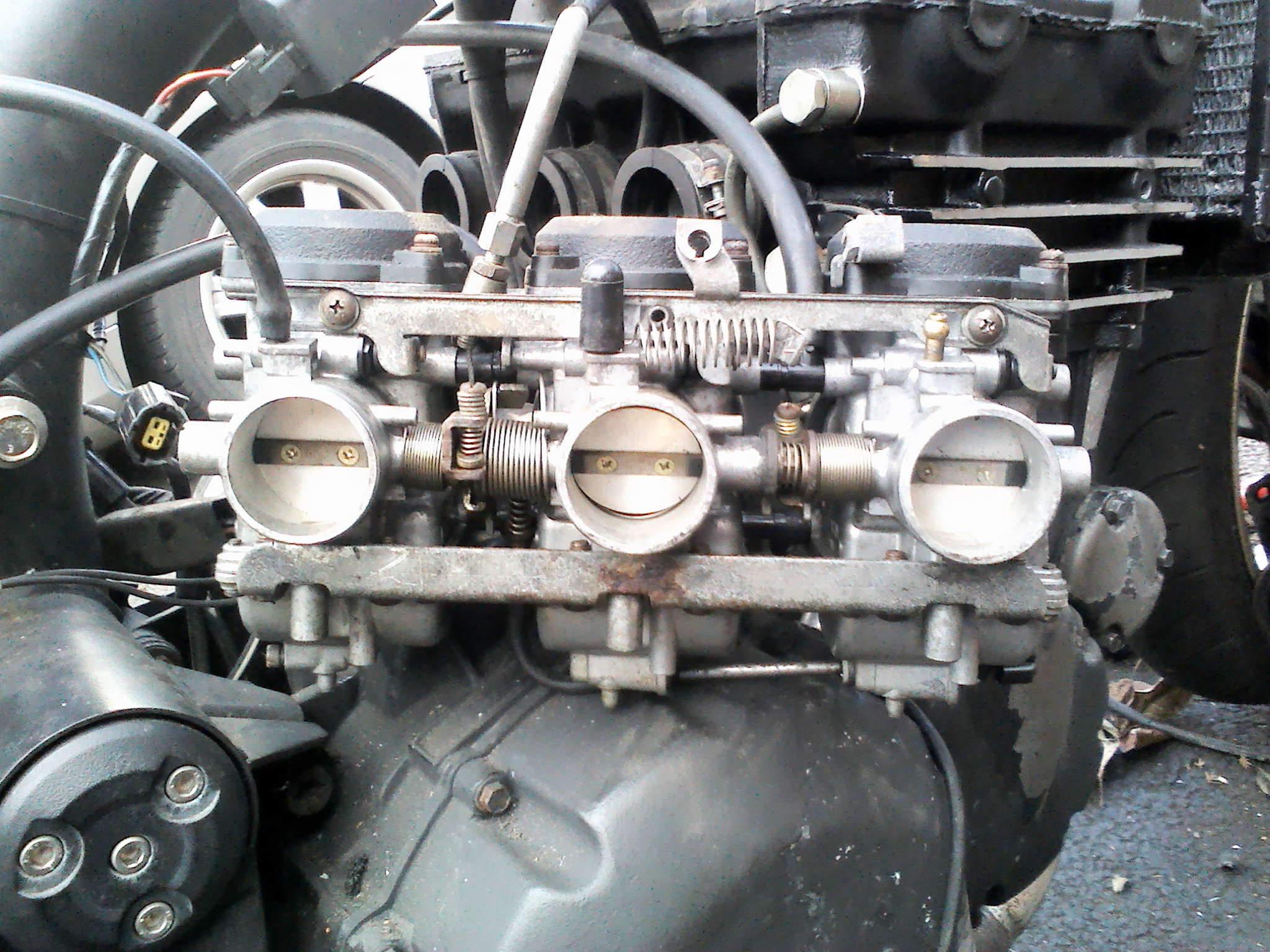

    Afternoon all
    time to throw myself onto your pire of flaming knowledge. What follows are two pictures of the carbs....... Removed but the throttle cable still attached........One is at rest and fully closed...One fully open. Does anyone notice anything wrong with either picture as I really have no idea if they are supposed to look as they do...............As always any help will be greatfully received and used accordingly
  6. thebiglad
    5,072
    Hi Jennoe, I'm not by any means claiming knowledge here, but the throttle bodies don't look exactly at the same setting.
    On the top picture the middle one is slightly open whilst the others are closed; on the bottom one the left and middle are fully open but the rh one is not.

    My thoughts too......just needed a expert view........what I need to know is how to balance them.....I've tried turning several screws but nothing seems to change......feel free to throw any ideas into the pot......I'm less than useless at this point...

    western Australia
    Hi Jennie,
    The right hand carby is missing its cap off the vacuum port, where you have your finger in the second photo is the adjust point for balancing the left carb to the centre and the adjuster for the right is the same setup on the right of centre !
    The bike won't run well and possibly won't start if you are trying without that vacuum port on the right capped/covered !!!

    removal and refitting is best done from the left and much easier to remove the carbs complete with the cable and detach the cable from the grip.
    Those carbs need some serious work done by the looks. Final balance will need vacuum gauges to get to run sweet.

    Hi jennoe,
    Good advice from all here, get it running firstly, then you can gauge what needs replacement. Adjust centre first so throttle butterfly is opened up the recommended amount, then left then right, start if you can get it too ! Then adjust idle up or down so it's running OK then fine tune with carby balancers, test and adjust after a run on the street, if it won't run smoothly through the full rev range on the road, then jetting,ports or needles are out.
