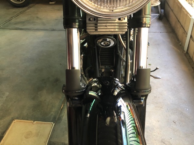

    I agree, definitely replace the gator. They do an excellent job and your fork seals will last much longer.
    Don't bother with glue, it won't last. its an easy job to remove the wheel and mudguard and then drop the fork leg out to change the gator.

    replaced the gates with these though I had to get them from England

    Nice, they will help protect the stanchions from stones etc.
    The old fashioned gaitors are still the best but seem to have fallen out of fashion a bit now.
    Not much "cool factor " l suppose.
    My old 1966 BSA has them but they do need replacement every few years.

    I'm also a fan of gaitors on conventional forks. On upside down types, like on my dirtbike and ZZR the stanchions usually have protective shields ether seperate or built into the front mudguard. If the Street Scrambler didn't have them I'd have fitted some. As said above, fitting them isn't that difficult. Wheel out, calipers off and drop the forks out of the yokes.

    In my case i am pushing 70th and cant be bothered pulling the forks out And i never go off the bitchman
