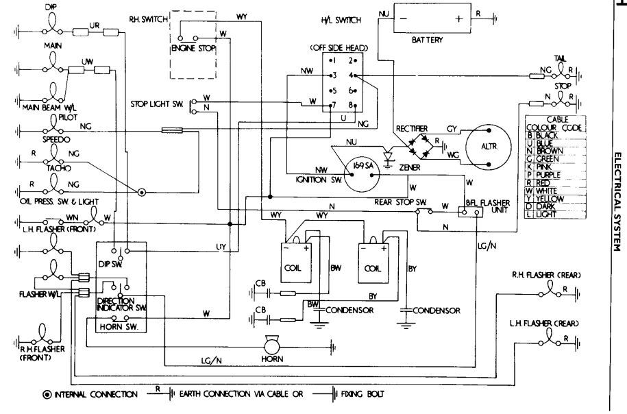

    I have a 1977 t140v that has an issue in the wiring harness that affects the turn signals. When I turn the handle bars they work but stop when they are straight. I have determined that the problem is where the harness enters the frame. My quest is to bypass this and go directly from the flasher to the signals. I do not know where to connect the wires at the signals. Thanks

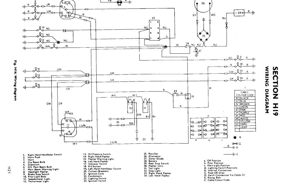

    Not sure if these will be legible or helpful. I believe they're for a 1973 but might help.

    Thanks for the feed back. The issue is in the part of the harness that is in the frame which is not accessible. I fixed the problem by re wiring from the flasher unit to the turn signals. One I found the right wires it was an easy fix.
