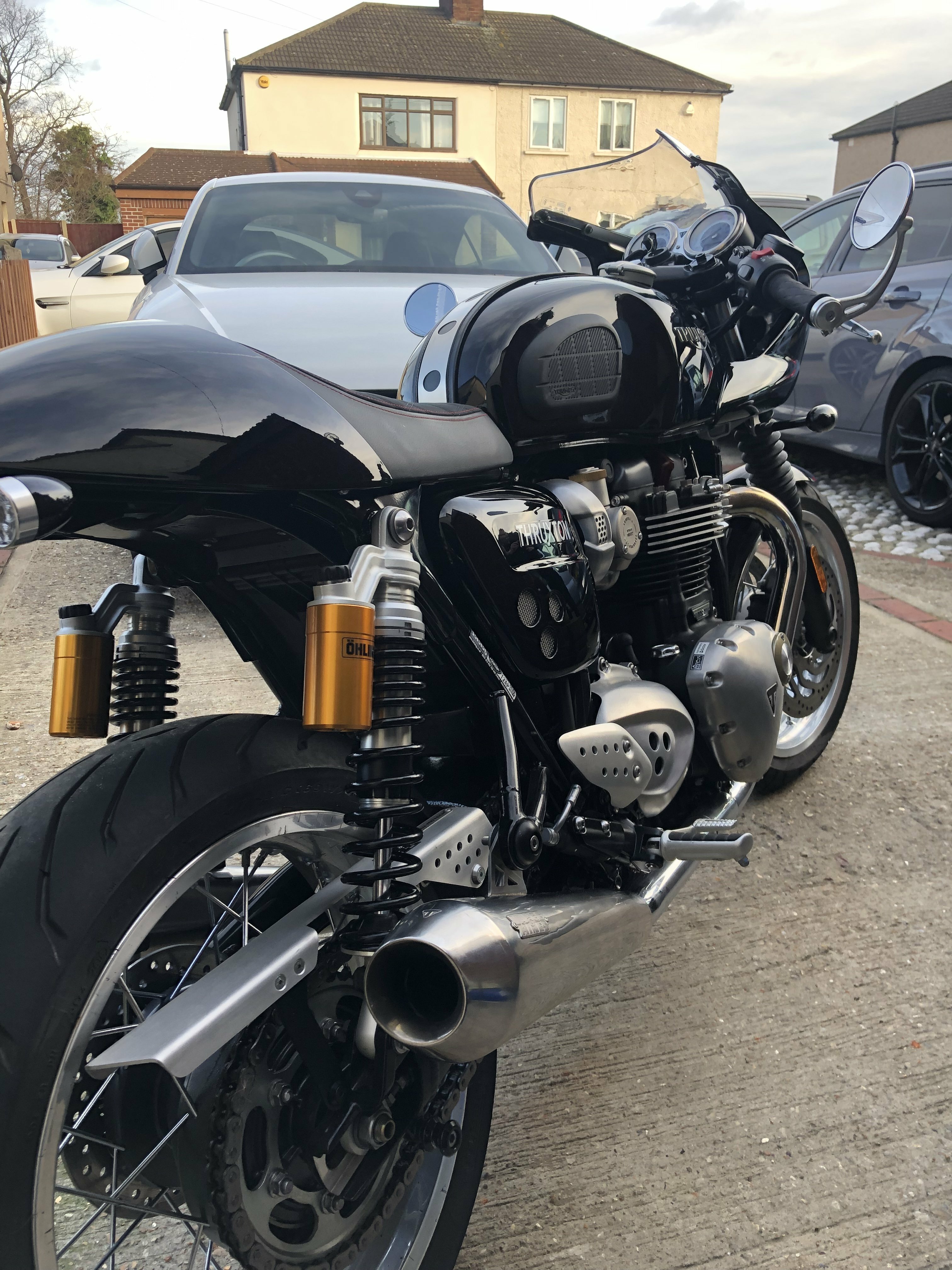

    Hi all.
    I want to fit the cafe racer nose fairing to my 1200 Thruxton S. problem is I still want to use the standard handlebars rather than the drops, has anyone done this as Triumph don’t approve it.

    Yes I have. The only problem is the clearance from the brake reservoir. I just lowered the risers till I had clearance then made a couple of spacers for the locator screws. The spacers are 8mm long.

    My Thruxton R has the cafe racer fairing and riser handlebars with no need to drop them; I was keen on this because the drop handlebars on the demo machine gave me tingling wrists after 45 minutes or so of riding. Instead, the brake fluid reservoir is rotated inboard and clears the fairing with ease. I don't know if rotating the reservoir required a new hose or anything else but to see what I describe, take a look at this photograph I took in the showroom before buying the bike. I hope this is relevant and helpful.

    I ended up fitting the lower bars.i tried the lowered flat bar and it wasn’t as comfortable for me as the the low bar kit.
    You probably want to sit on the lower bar version before deciding.

    My previous bike was a Daytona 675, so I’m used to the lower bars, and I tried lowering the flat bars by the 8 mm that Kiwidave has done but it actually felt less comfy than the lower bars.
    Undo the Bolts that stop the bars from turning, then lower both bars with the 8 mm gap and see how it feels

    Mine has the lower bars but Kiwidave see previous pics lowered his standard bars.i tried both and felt more comfortable on the lower set.
    You can drop your bars by 8mm to see if it feels ok before fitting
