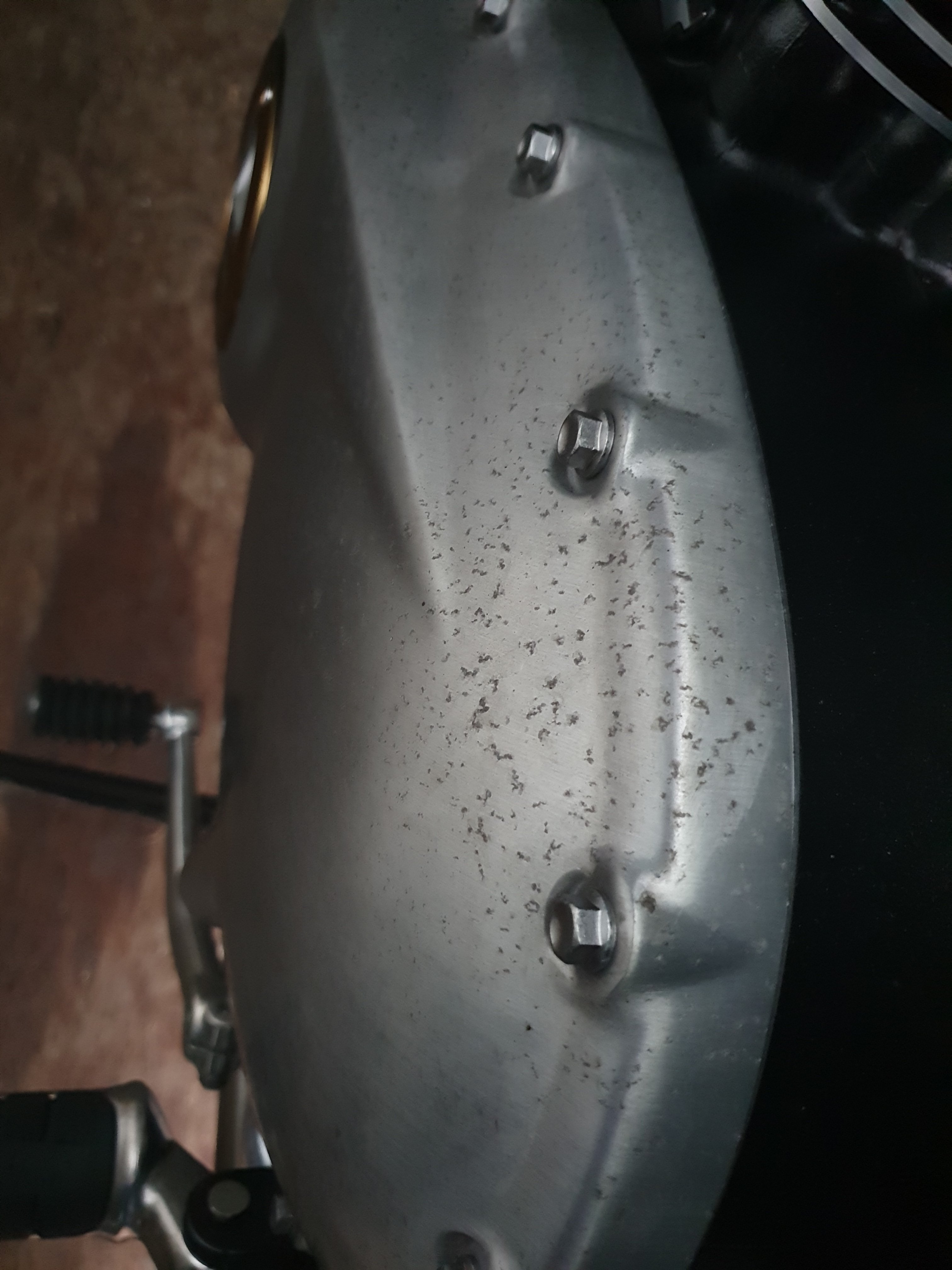

    After much searching bought a brand new Triumph T120 just before Christmas. LOVE the bike a real pleasure to ride and was very happy until went for my next ride.
    Rode back from the dealers and 2 weeks later did a ride out with some friends, got a total of 137 miles on the clock. The bike was 6 weeks old when the problem was found !!!
    Went to go for another ride and to my horror found all the alloy parts really badly corroded and very badly pitted.
    Spoke to the dealer who said to being it in.
    After speaking to dealer that said this was salt and the bike hadn't been washed off after every ride and triumph wont touch under warranty.
    Now if fairness the dealer was very good and said they would sort BUT if i don't wash off after every ride it will return.
    As I use the bike for touring and sometimes for work this just isn't practical.
    I have many other bikes all used in the same way and while I know salt is nasty stuff the way I have looked after them is the same and even after many years non of them show the problem the triumph has.
    Even people on the rider out some haven't washed there bikes after the ride and have had no issues.
    SO ?? Is this normal ???
    If yes is it acceptable as I am thinking that this makes the bike not suitable for UK roads.
    Would like to here people thought on this as love the T120 but I cant live with washing EVERY time I
    Thanks :)

    This is a common complaint, lots of members on here swear by ACF 50, dont know if perhaps manufactures are using Greener metal presentation or regulations have changed the processes involved these surfaces are not so durable. Whether this is just a Triumph problem I couldnt say.

    Is it normal for alloy to corrode/oxidise in harsh conditions? Yes, of course it is. Don't take this the wrong way but choosing a bike with exposed alloy parts, to ride daily in all weathers when you're not prepared to put in the cleaning time is the wrong choice. Bare alloy + salt water = corrosion very quickly. I have a Street Scrambler with far less exposed alloy but it still requires regular washing and corrosion protection measures like ACF50 etc. In fact every bike I've owned over the last 40 years has suffered in Winter weather to some degree or other, even if it's limited to small fittings and fasteners.

    Thanks for the comments guys, sounds like its a very common problem and to be honest very disappointing in a modern vehicle.
    Replying to a few specific points
    1) Few people have mentioned
    Will have a look at ACF50 and WCF. I have spray equipment so could do the parts but to be honest if going to do that may just get them anodized, but will depend on any warranty issues
    2) Is it normal for alloy to corrode/oxidise in harsh conditions? Yes, of course it is
    No, its not !!, if the right grade of alloy is used. I manage a design department and we use alloy in high corrosion environments, going for alloys like 5454, 5083 etc, quite a few to choose from, will not corrode even in VERY high salt and corrosion environments without any protection. Given the mechanical requirements of the parts the selection of alloys should be quite wide.
    3) Yes, now its been pointed out to me and states that the alloy parts must be cleaned and dried every time the vehicle is used. I would question if that statement makes the bike fir for purpose in the UK but its in the manual.
    4) Were you given any advice by the dealer on cleaning and protecting your bike?
    No nothing was said.
    I think I'm going to get the dealer to sort the problem, as said they have been very good which cant be said for Triumph who just washed there hand of the problem . If I cant sort better protection I think ill just sell and end my very short ownership of Triumphs, which will be a pity as a lovely bike to ride.

    Mine did the same, after a ride I washed it but didn't wipe the casings after, I'm not sure I want to wash and dry it after every ride though.
    I'm thinking of painting the casings satin black like the engine block, or have them lacquered.

    Im going to look at having them anodized. Could be done clear or black (or most other colors).
    Going to speak to one of our suppliers if they can do, if yes ill post there details.
    Just need to make sure wont effect warranty :(

    I wouldn't go down the lacquering route personally. Even if you get a decent finish it will suffer from stone chips. Then the corrosion will start under the lacquer and it will look crap and you'll not be able to polish the alloy without removing it, nightmare. The black crackle finish used on some of the engine cases looks more durable.

    Worked for me too when I commuted year round. Spray WD40, dirt sticks to it, apply more WD40, more dirt sticks to it and so on. Come spring/ salt clear roads, out with a brush and a can of Gunk to degrease. Alloy cases etc in perfect nick.
    If I take a bike out now for pleasure during winter, its an hour riding then hours and hours of washing and cleaning and re-protecting with WD40,ACF50, Silicone Spray, Auto-Glym etc.
    Been out once in December. Thought." Fk that" since.
    To the OP, I would be taking those cases off and getting them polished cos they are knackered. Surprisingly cheap and you will go weak at the knees when you collect them. Supa-sexy!!!

    If you prefer something less thick than the waxy ACF50 try Scottoiler FS365. It does work in a completely different way to ACF50 and you apply it more frequently. It is a water based spray with an oil mixture that leaves a barely visible protective layer on things. Some like it, some don't. Not trying to rubbish ACF50 either but I prefer the FS365 myself.

    The dealer is sorting for me, getting them re-brushed I expect BUT I now know that they are just likely to go the same. If I had know this I would have just gone the T120 Black as understand the alloy is a lot better being coated.
    I personally think Triumphs attitude is VERY poor and the choice of alloy is very bad design. As said have had bikes for coming upto 40 years so lets say I have ridden a few and ride all year round and never seen anything this bad.
    I am considering rejecting the bike and would be interested if anyone else has done this.
    Its a real pity as the T120 is a stunning bike to ride.
    Also had a look last night at one of the other bikes that was out on the ride with me, not washed since and just put away wet. Guess what, no marks on the alloy.
