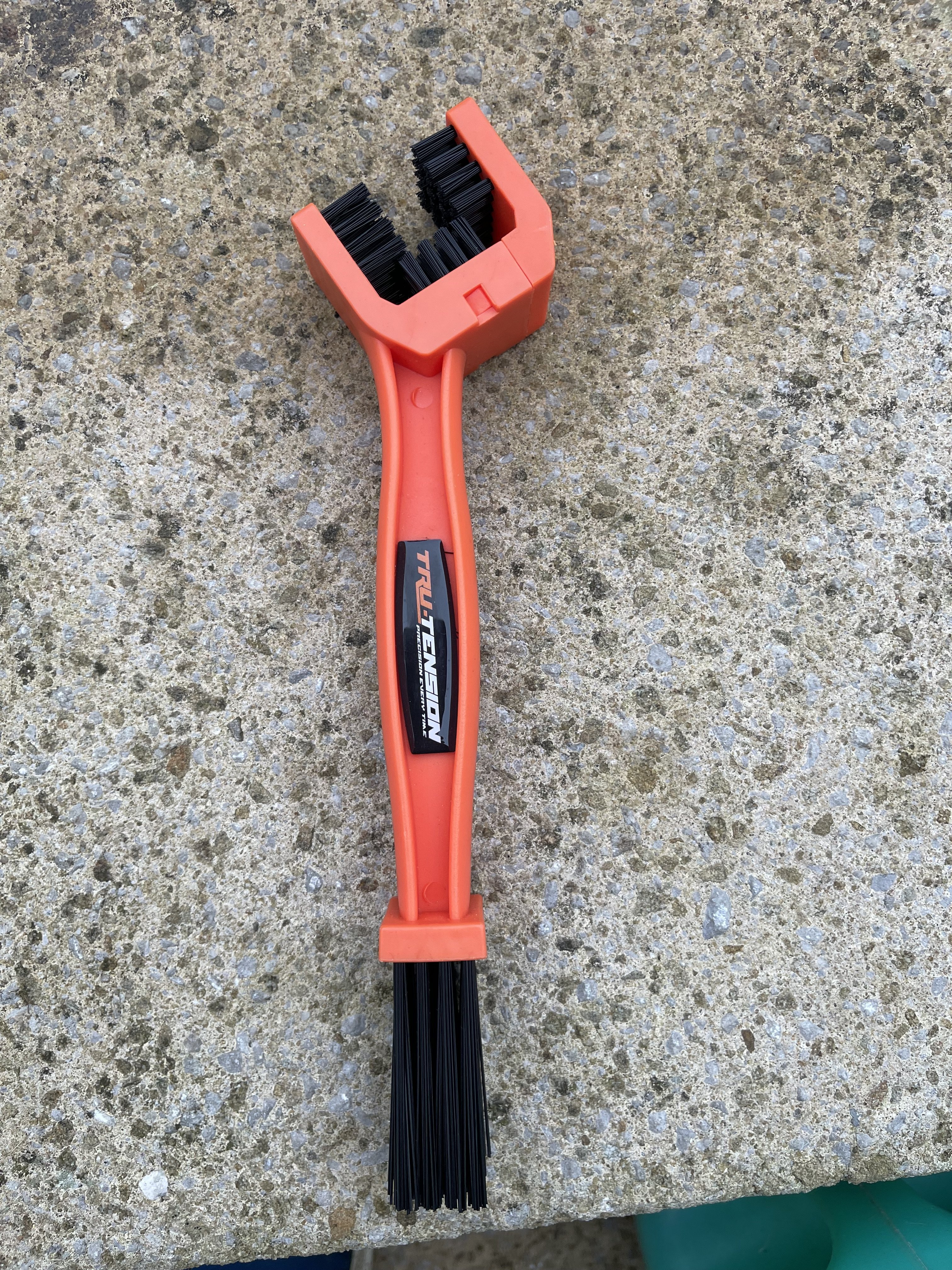

  13. beerkat
    beerkat First Class Member
    Aug 14, 2019
    1,083
    Cheshire UK
    Blimey, that's a very precise cleaning schedule you're sticking to there.
    I check the bike chain 'every now and then'. If it's mucky or feels dry then it needs cleaning and lubing.
    None of my 4 bikes have centre stands, so it's a paddock stand to get the back wheel off the ground.
    We've all got our own way of doing it but this is mine.
    I lay a sheet of cardboard lengthways under the bike and cover that with a few sheets of newspaper (all especially saved for this purpose).
    Disposable gloves on.
    I put a rubber mat next to the bike, which I sit or kneel on.
    Remove the chain guard (only takes 2 minutes).
    Rotate the wheel and aim an aerosol jet of chain cleaner closely at the chain for a couple of revolutions, concentrating on keeping the jet pointing directly at the chain (via one of those thin plastic straws) and not over the wheel, swing arm, sprocket or into the air.
    Allow a couple of minutes for the cleaner to dissolve the crud.
    I then use a U-shaped nylon chain-cleaning brush (costs about £5 and lasts years), which I hold firmly over the bottom run of the chain while I spin the wheel a few times.
    Most of the cack drips off the chain onto the newspaper but I always have a spare sheet or two handy in case it starts to spread.
    When I reckon it's sufficiently clean I run the chain through an old rag to wipe off as much cleaner as possible.
    I have been known to use Solvol Autosol to polish up the outside-facing links.
    Then slowly rotate the wheel and carefully apply aerosol chain lube (I currently use Wurth or WD40 chain lube) to the rollers, again concentrating on keeping it aimed at the chain. I usually go through 2 revolutions.
    Then it's clean-up time.
    I use a bit of WD40 + rag to wipe over the rear wheel and anything else that might have got an inadvertent spray.
    Throw the rags onto the newspaper. Carefully roll the whole lot up, making sure not to let the runny stuff sneak out of the sides, and dump it in the bin which is standing nearby, followed by the gloves.
    The whole thing takes about 20 minutes. I rarely, if ever, get anything on the garage floor or on my clothes. It's not that difficult.
  14. ajc400
    ajc400 Senior Member
    Jun 4, 2024
    1,078
    Glasgow
    Sounds about right.... method and frequency... that's probably the wrong word for how often I do it.....possibly except for the solvol polish!! ;)
    I do have a piece of card to slot behind the rear sprocket and over the wheel too. :)
