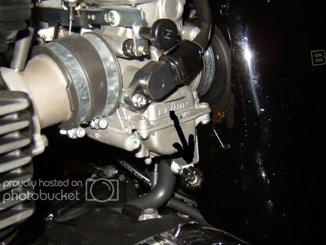

    Adjust your idle speed when engine is warm via the knurled knob as said above - see pic.
    Once you have it set up correctly - about 1050 to 1100 rpm is best, then for future starting, pull the "choke" knob out fully and start the bike. Give it a few seconds to settle down and then push it in to the second stop. Assuming you are kitted up apart from your gloves, leave it out until you have your gloves on then push in and off you go. You can start the bike then without it but don't touch the throttle or it will stall. :cool:

    Thanks very much for the pic. Really helps
