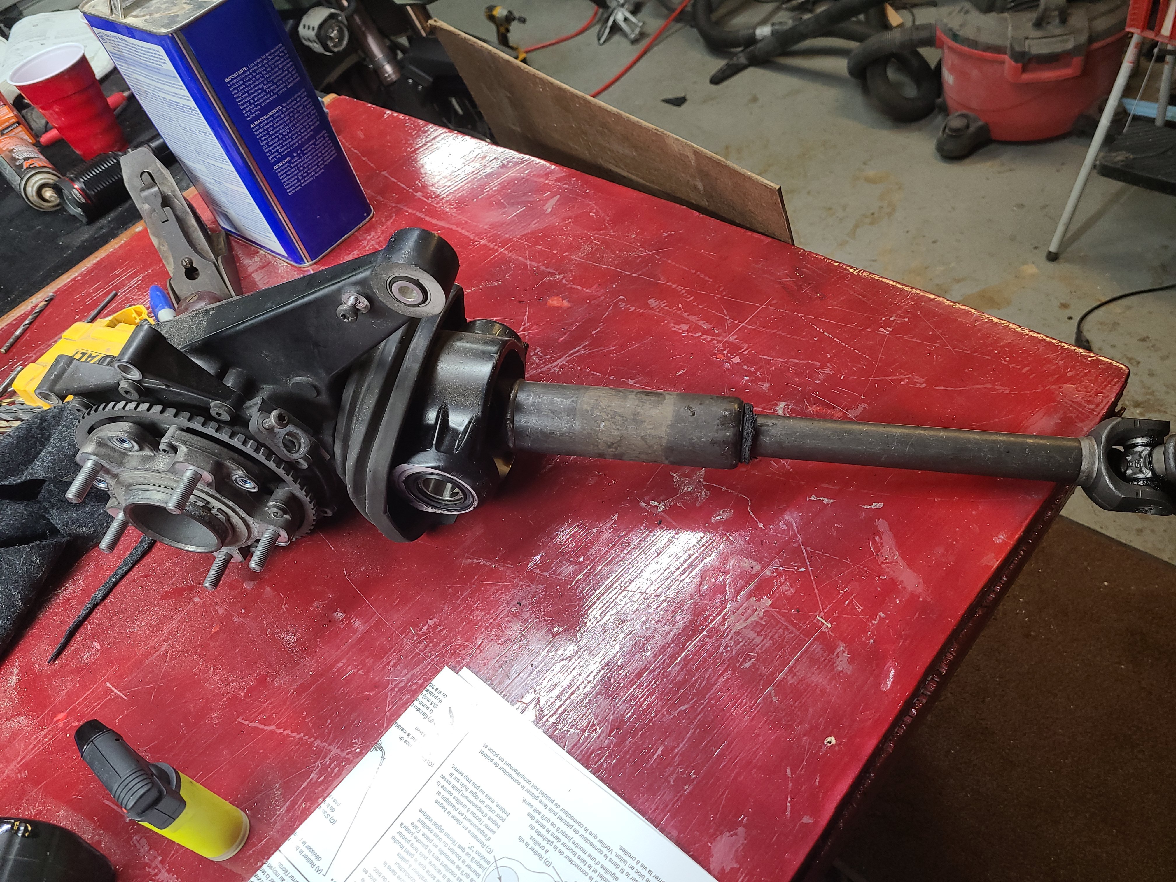

  12. Boominater
    Boominater New Member
    Dec 3, 2020
    Illinois
    Well thanks to the people on this forum and the post i read about a guy that had an Explorer xc just like mine that if he accelerated hard the clutch would slip. he later found that it wasnt the clutch at all. It was the drive shaft turning inside its self. there is some kind of rubber filler inside the larger part of the drive shaft that the smaller part slides into. I am sure that it is there for some cushion and to take out some shock going to the bevel gear. I have some pictures of what i found that i will post. i think this is not repairable but if it is please let me know. where is the best place to find a drivshaft, could you let me know please
