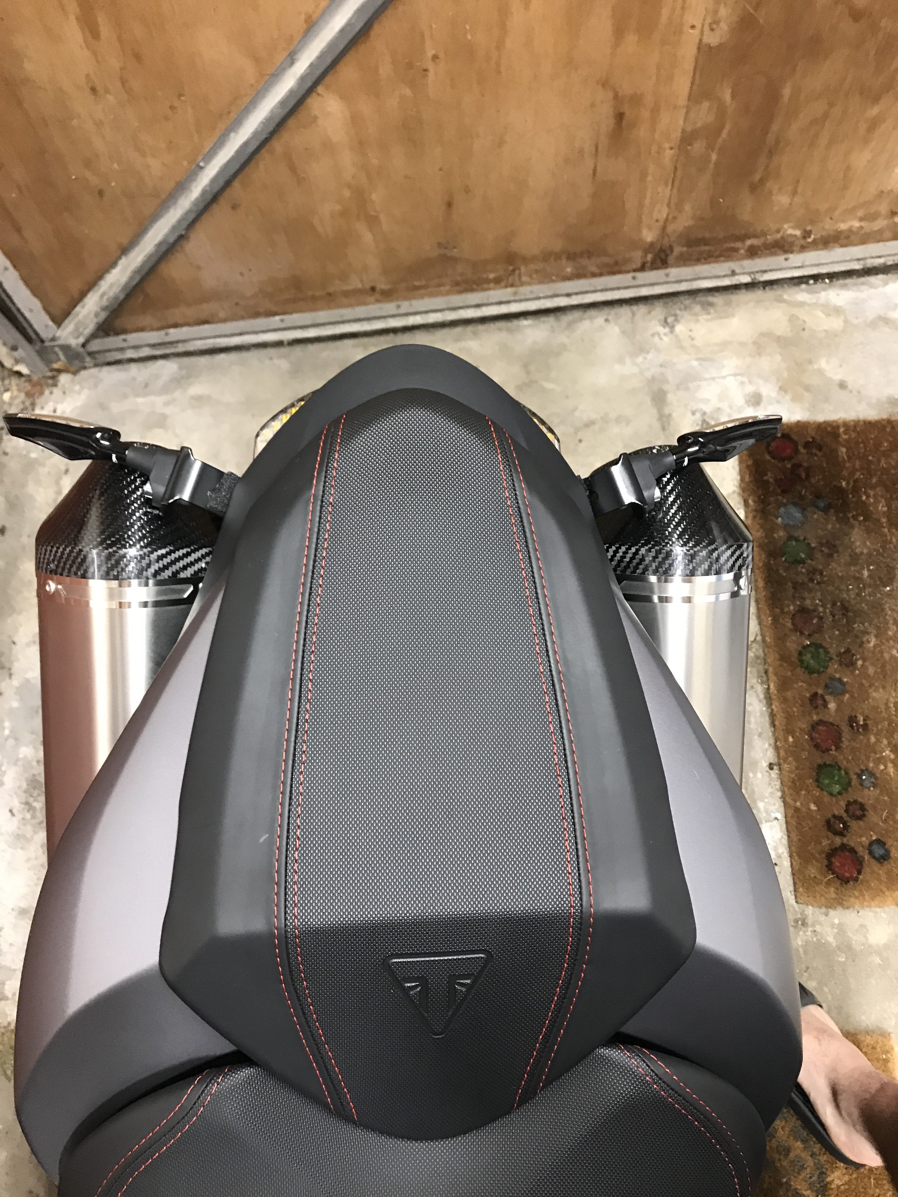

    FYI. Here she is with the SCs on...
    I decided to leave the stickers off.

    Looks really nice!
    What tail tidy you got on there? My R&G ones I've had to modify a bit to have like a 2cm gap between the exhaust and the indicator.

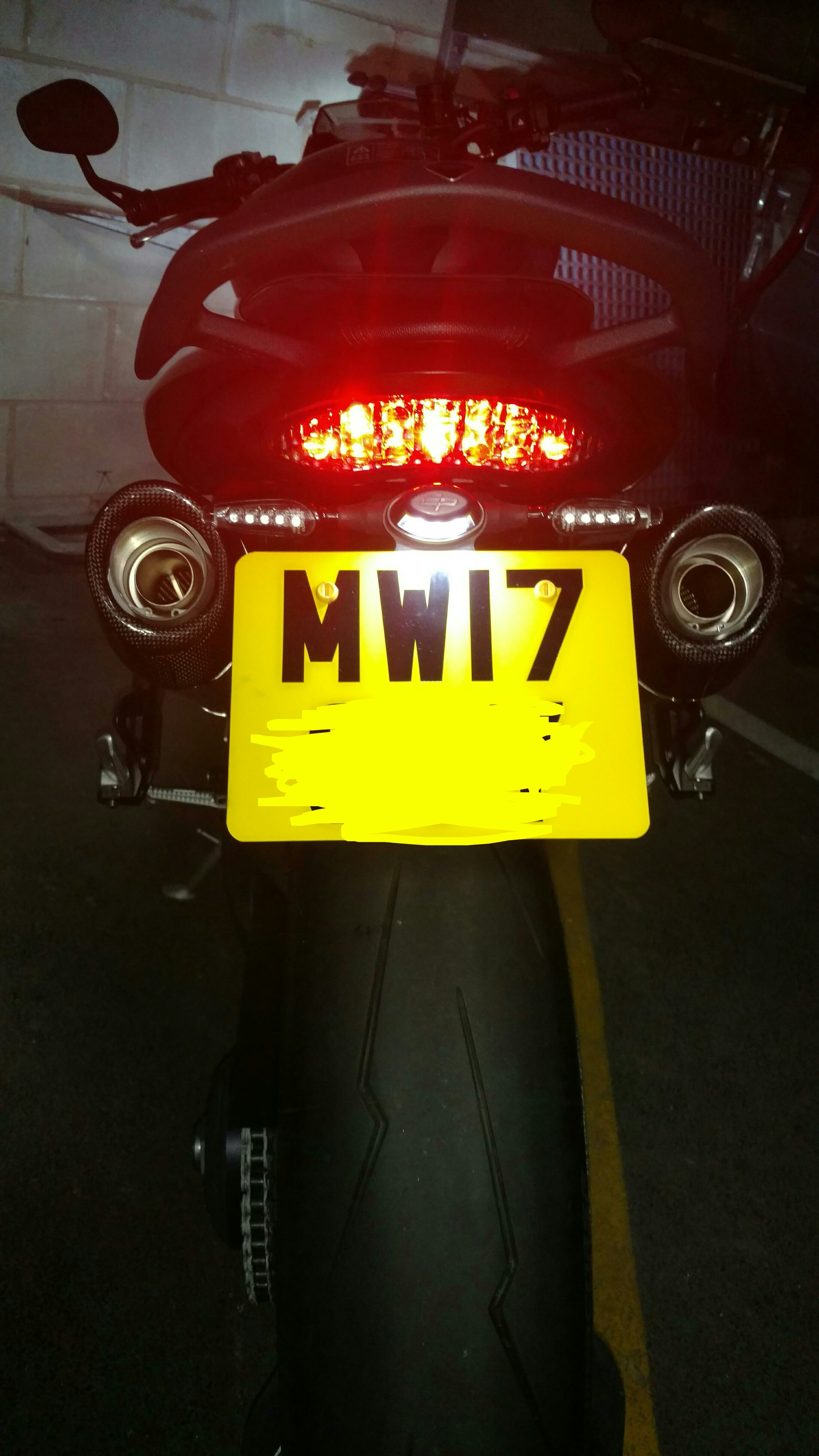

    Had a SC Project on my 2011 Speedy. Sounds great with a nice gurgle when you shut the throttle. Build quality is good and the finish is holding up very nicely P1012384.JPG

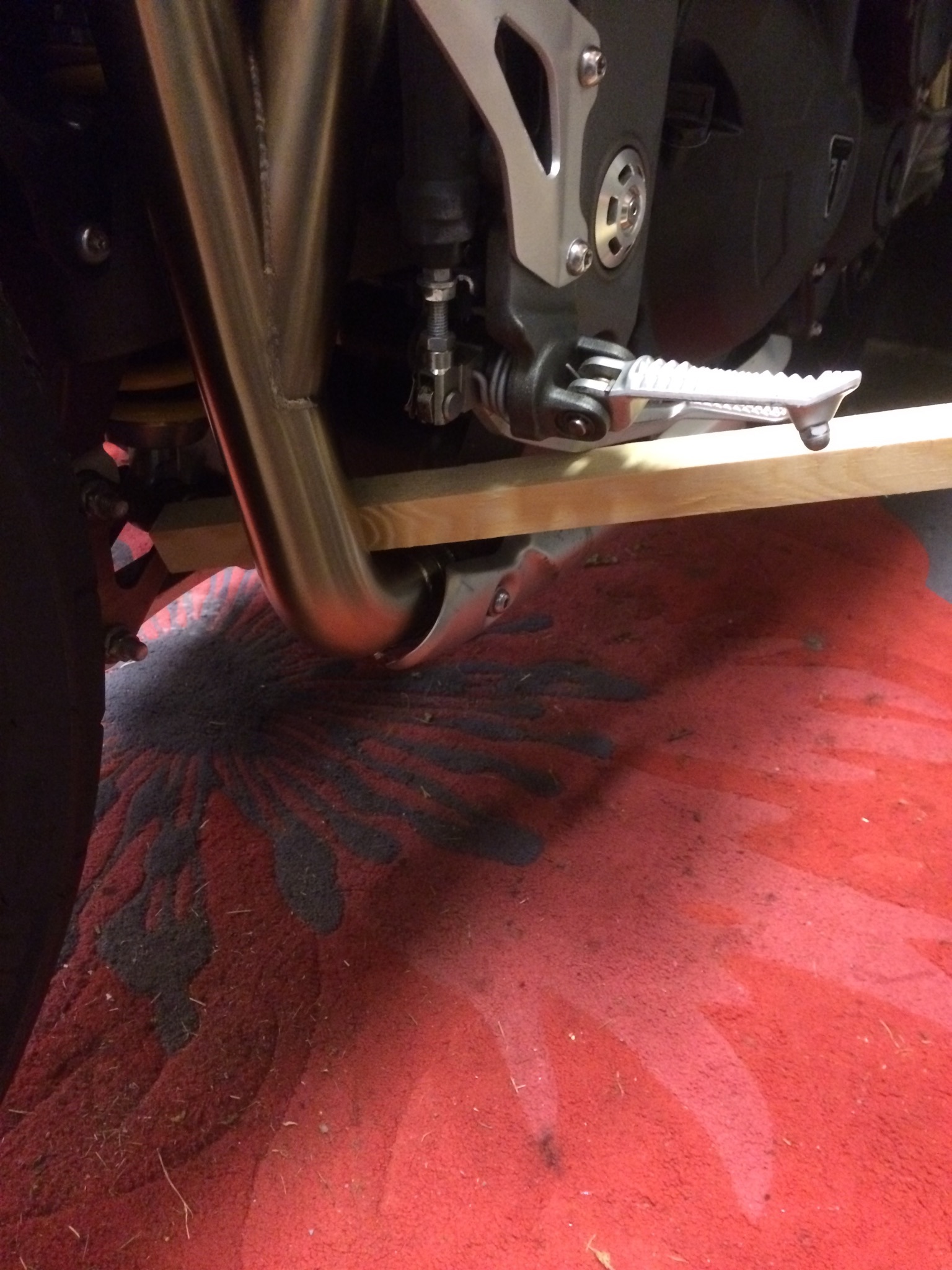

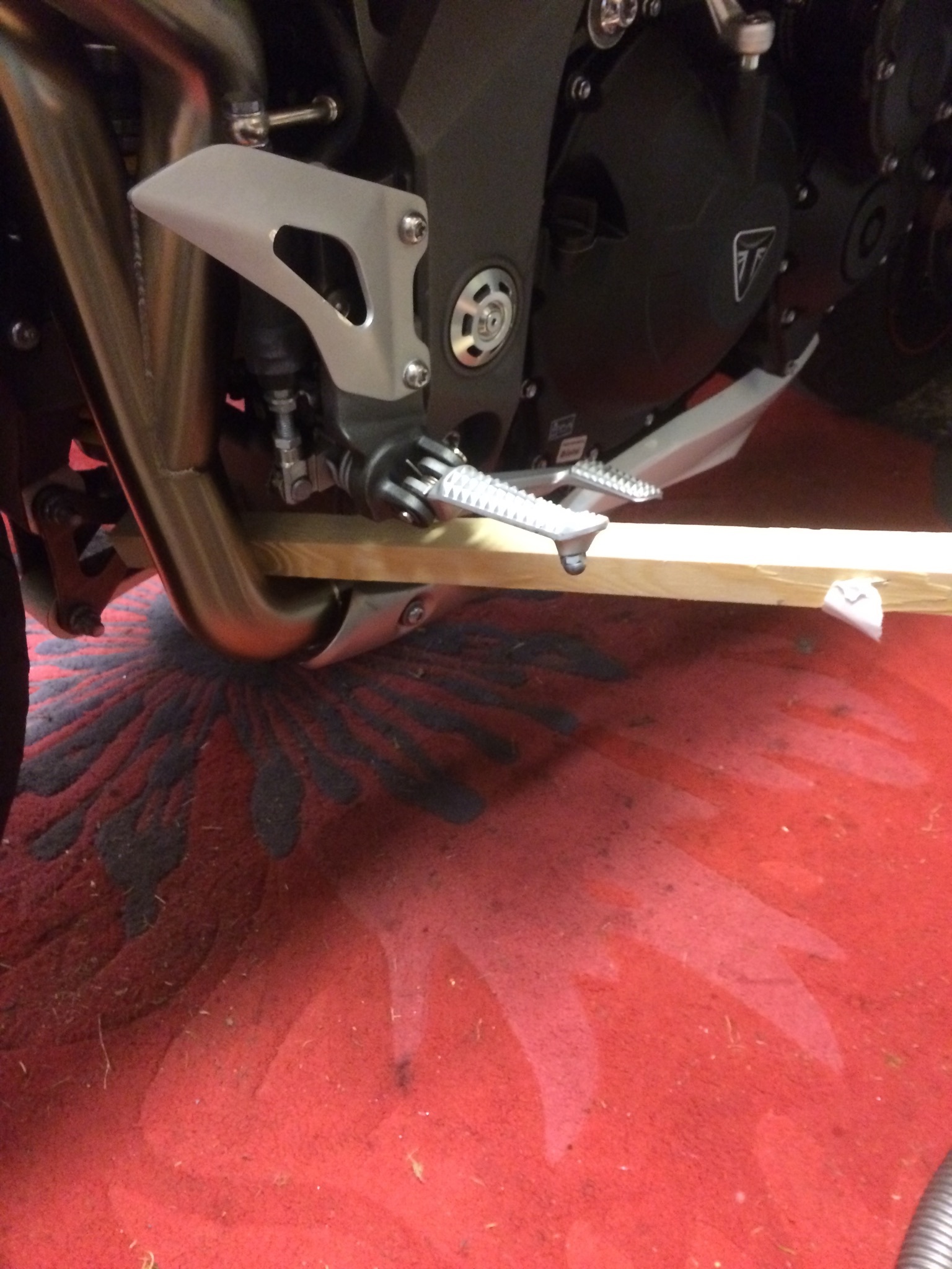

    Think it's a cleaner look without clips, especially if you have foot pegs off.
    If you find the silencers are loose, untighten the support bolt (by the left, passenger foot peg) slacken the link pipe to main pipe clamp.
    Then using a piece of wood, stick it behind the exhaust at the bottom, by the clamp. Use the bolts of the rear suspension mount as a leaver (see pic's) pull back to create a tight fit.

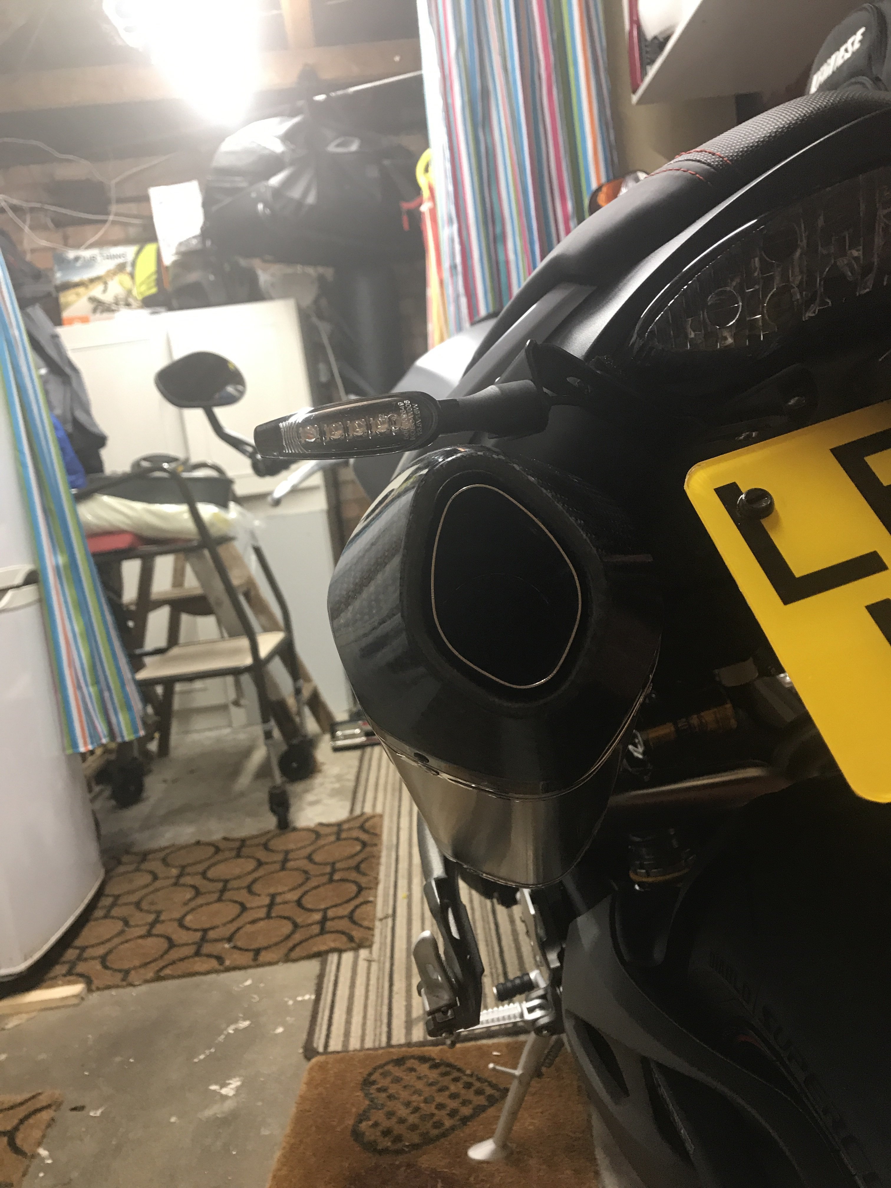

    Van, it's the Evotech tail-tidy. Really well made and fit & finish is good. I'm just a little unsure about the number plate light. The plate seems to be at a too-acute angle and the bright white LED light can be seen from behind by other road users. I worry this might get me pulled. I spoke to Evotech and they said this was normal.
    What do others think?

    Thanks for the tips mate. Will have a shot at it some point this weekend if I have the time!

    I'm a big fan of that tail tidy!
    Considering selling mine now and getting that one!
    LED light is fine mate it's a number plate light there's no limit on how bright they are. On my BMW it's the same super bright and can see me for miles.
    Maybe try getting a smaller number plate I've been riding for years up and around London never been pulled on the size of the number plate!
    Lately they will only pull me to check if the bike is actually mine as the theft number is rising rapidly in London.
