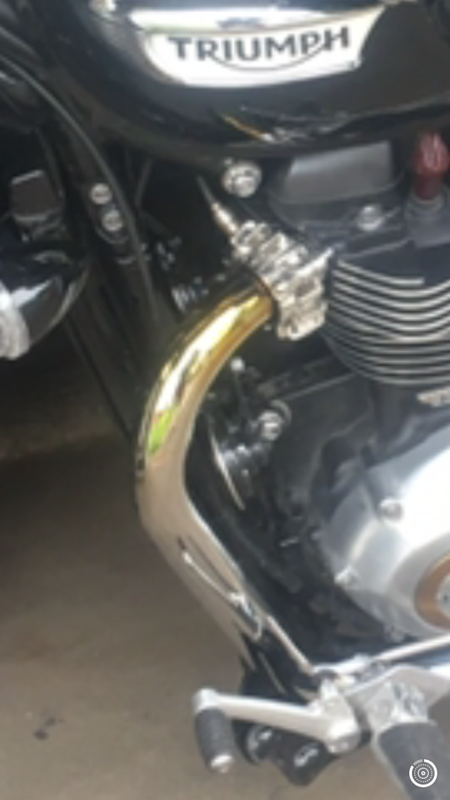

    All the reading I’ve done points to blue job, so have ordered some (sent yesterday). I will do some before and after on my gallery of 2018 Speedmaster upgrades, after new chrome pipes started bluing (brown mottle is the start of the process)

  8. Dartplayer
    7,656
    Forgot about the pix, after photo shows mottle and bluing evened out to brassy tinge. Works for me with no abrasives. I see Blue Job comes in a larger tub new too
