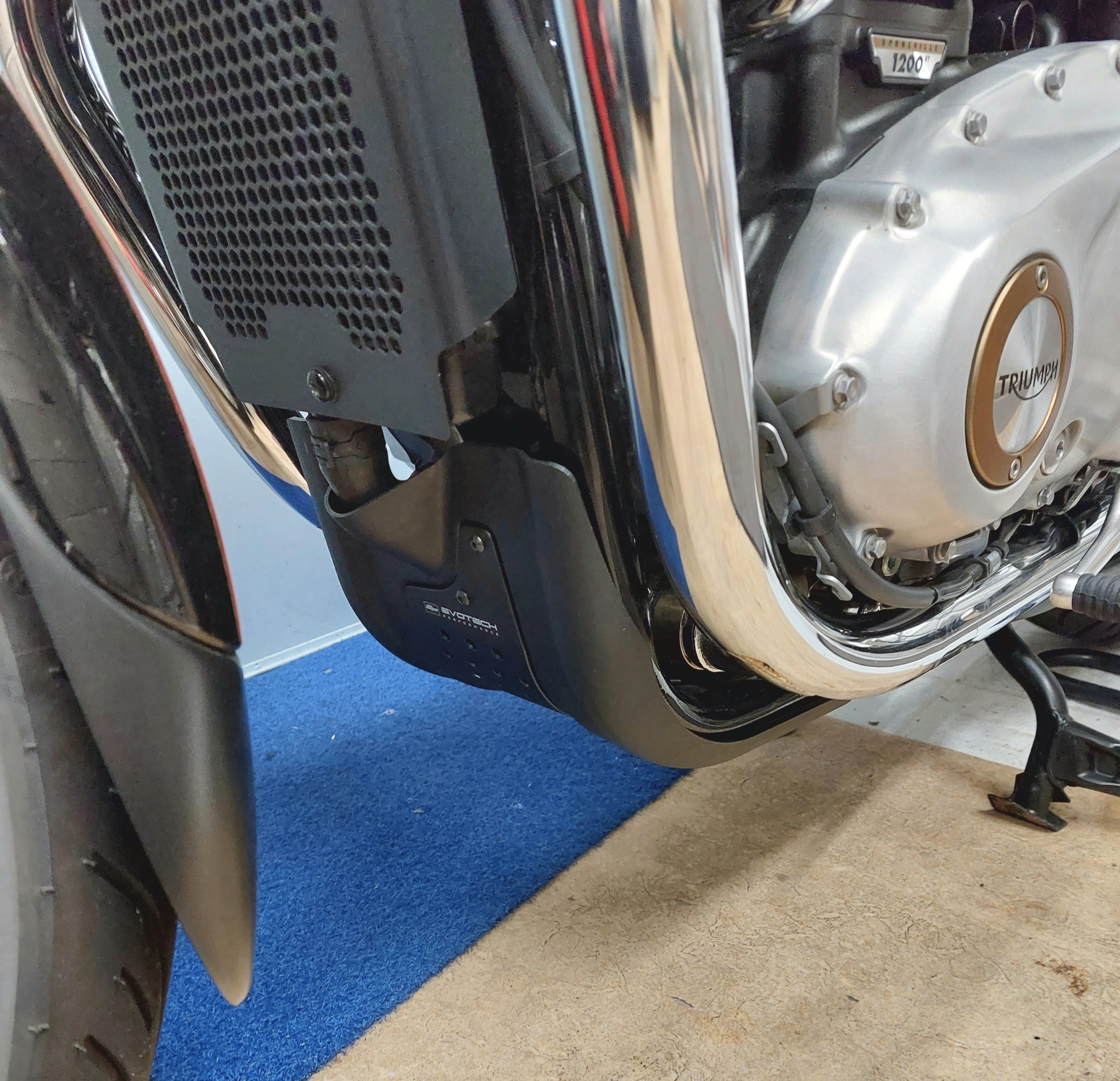

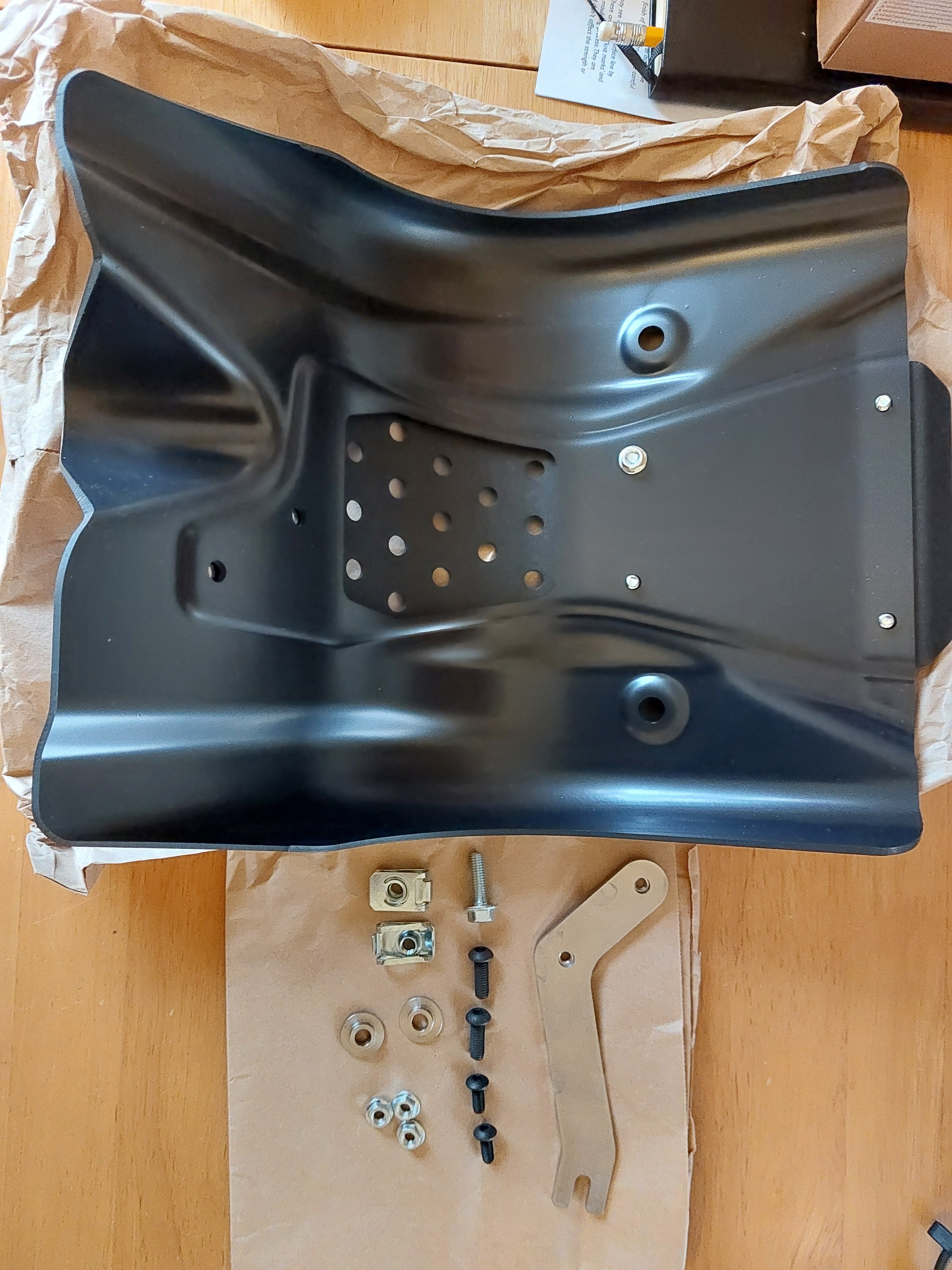

    I have fitted an Evotech Engine Guard to my 23 T120. It's a quality piece of kit which gives good cover to the front of the engine. It was reasonably easy to fit, although Gollum's finger would have been useful for the bolt securing it to the radiator.

    I put the same 2 pieces on my 22 street twin, I left that top arm off, its well made and seems fine with just the two bottom bolts, and easier to take off to clean

    The problem with a close fitting sump guard on the W/C twins is that it stops the flow of cooling air to the cat which results in it becoming exceptionally hot.
    This causes a lot of heat soak into the motor making it run hot. It's even worse in warm weather, especially in traffic etc.
    It's ok if you have an X-pipe fitted but otherwise it's a bad idea to fit one even if it does look nice.

    Is it really a problem? After all Triumph offer one as an accessory which should have been thoroughly tested?

    I bought the Triumph sump guard for my T120 Bonne and there are some differences to the EvoT but both are good quality stuffs:
    1. The front of the Triumph guard does not go up as high as the EvoT thus permitting air flow.
    2. There are four 1 1/4 inch diameter vent holes on the upper front of the Triumph guard for air flow.
    3. The Triumph guard is held in place by 4 allen bolts to predrilled fixing holes on the frame BUT the guard goes rearward long enough to cover the oil drain plug. To change the oil, I remove 3 of the bolts and swivel the guard out of the way. The oil filter is not covered. It looks like the EvoT does not go that far rearward to cover the drain plug and oil filter.

    To the OP, I noticed you have a front fender extension; can you say where you got it??

    Found a front fender extension on Ebay from Bobs Bike Stuff UK identical to ManInTheJar's:
    https://www.ebay.com/itm/192722420757
    Installed on my front fender; installs easily; held in place by supplied double sided tape and push rivets (need 4mm drill bit); solid; Happy Camper.
