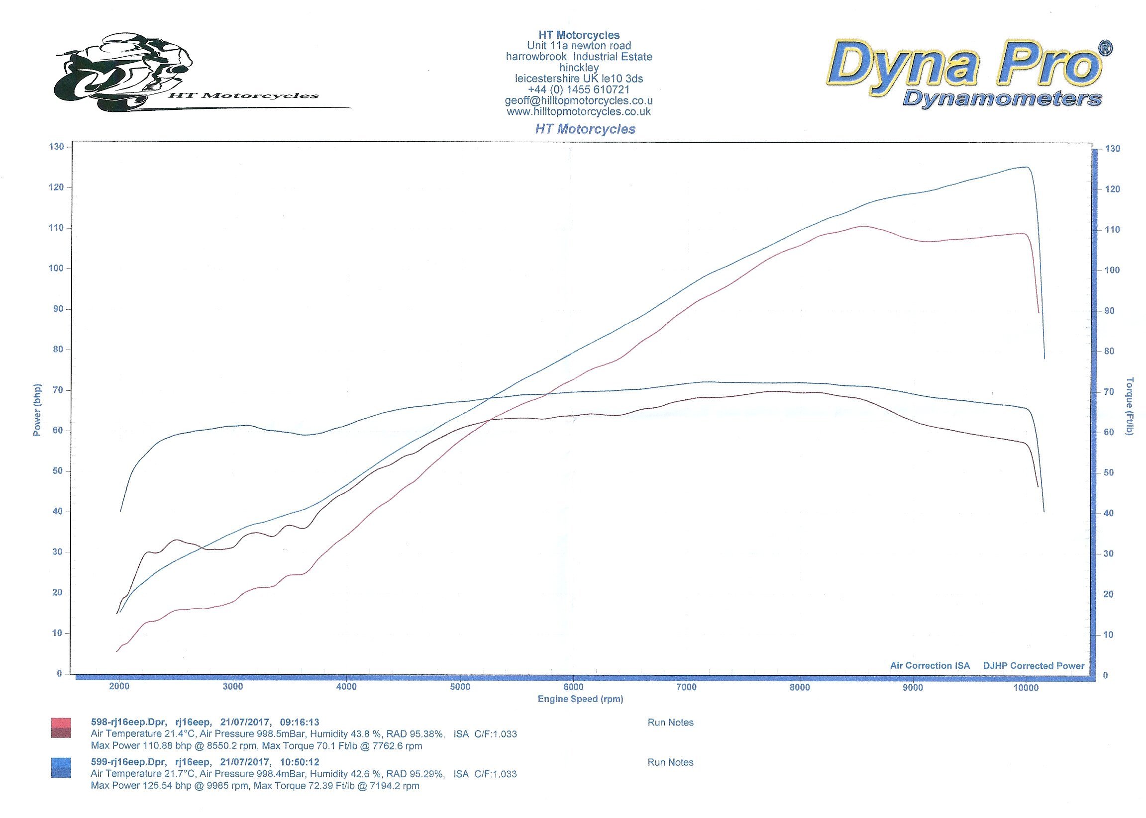

    Wow TC looks like you got similar result to mine ! More torque and HP everywhere and especially up top !! McCOLL.jpg

    It's worth it, it means you'll also get the map tweaked to your individual bike's set up rather than a generic map upgrade (which is still far better than Triumphs OE maps though....)

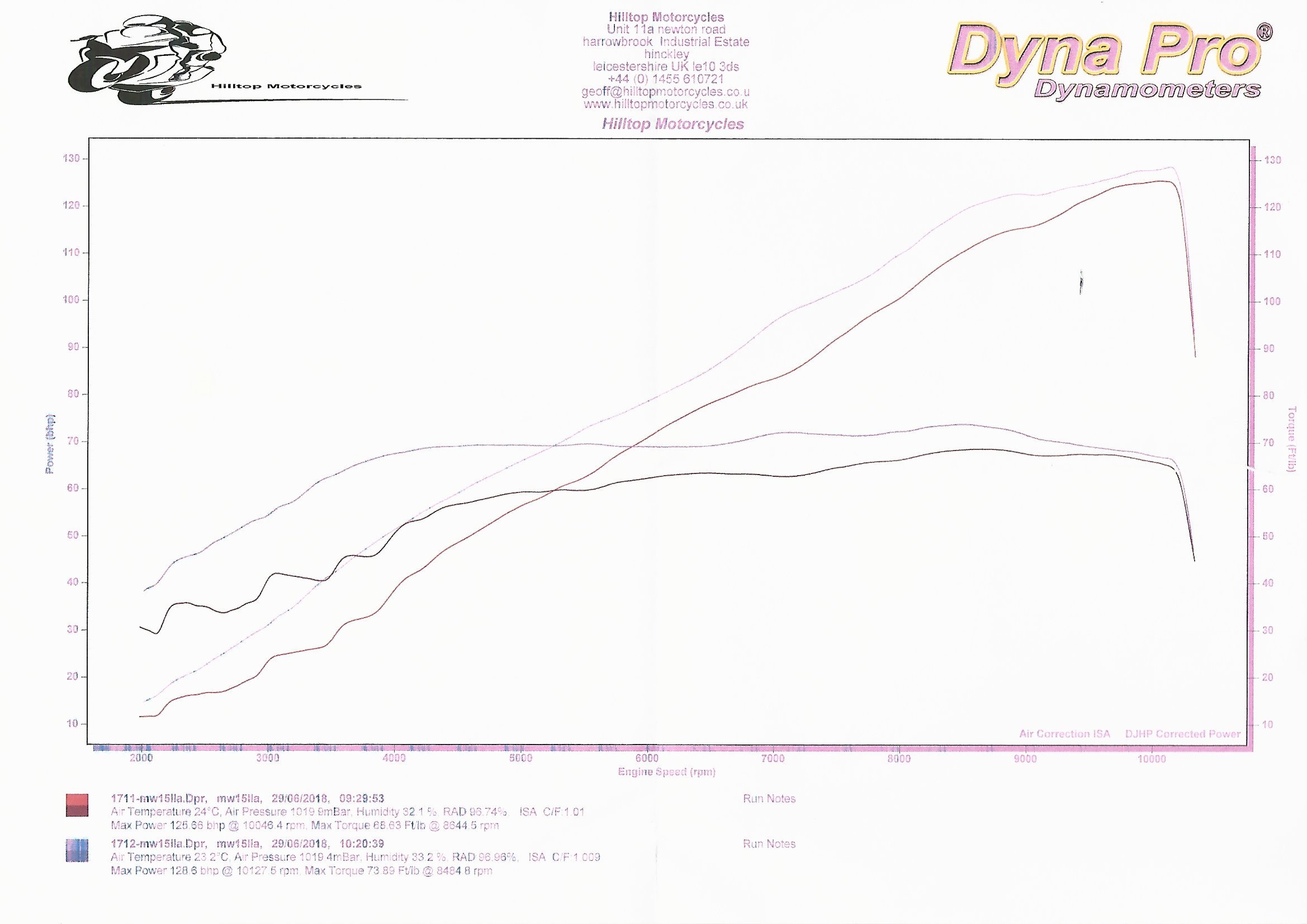

    Finally got it done. Rode down on Friday, not a bad trip for 110 miles of motorway.
    Here's the results: 2015 Speed Triple R - K&N Filter, twin Arrow high level cans.
    Up 3 bhp, (126-129) up 5 ft/lb (69-74). Not a big improvement but a smoother curve.
    I am surprised my figures for the 2015 model are higher than your 2017 TC...., is that the effect of Euro 4?

    Probably more down to the conditions/settings when the dyno test was done than anything else.

    You can't compare dyno maps if done on different machines or different days as there will be various differences affecting readouts

    The map is way smoother and three ponies up top isn't bad for basically a stock engine ! But it looks like you are up as much as 4 or 5 ponies earlier in the rev range and that's where it really count's because it's usable power ! And it will greatly improve acceleration and make it possible to save fuel , because you can change up at lower engine speeds and maintain road speeds !

    andyc1 - yes good point, around 10bhp up at 5k rpm.

    That is a great improvement like 30% more torque at low revs
    I bet if feels a lot better !
