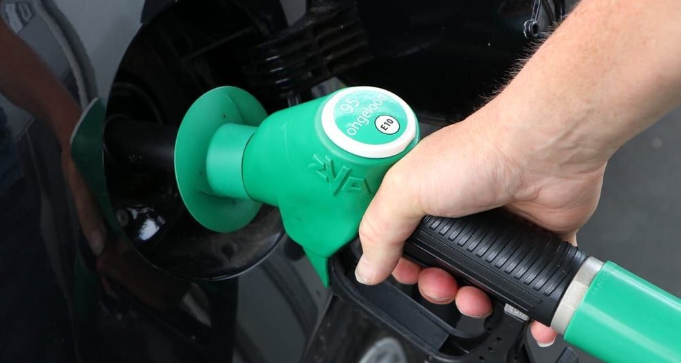

    E10 petrol laws aren't starting until September according to Government websites, however I went for fuel today at Asda and didn't notice it was E10 until after I'd filled up, just a heads up for all you people with old bikes, look at the pump label before you fill up.

    Morrison’s were all E10 round here too. Seems like they have changed early.

    Filled the car up t'other day at the local Jet garage and that was E10. Apparently their super unleaded will be E5 for the time being - however long that is!
