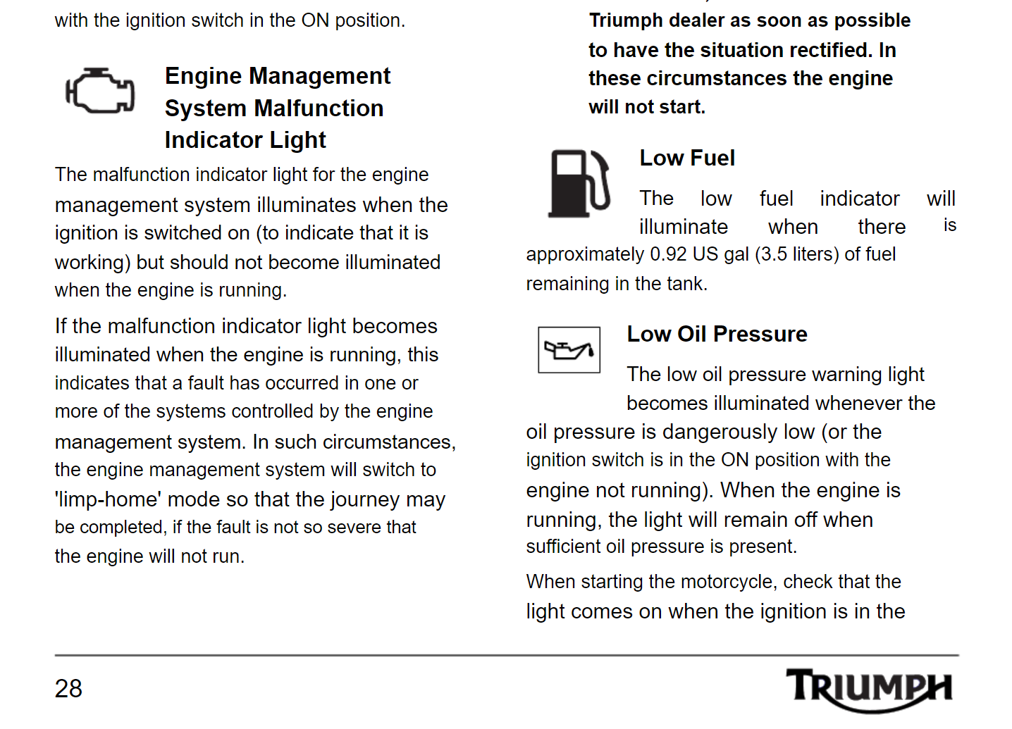

    Does the Bonneville ECU have a restricted (limp) mode if it detects a fault? - If so, then that might explain the poor performance, and you will need to establish the actual fault code? :confused:

    To answer my own question...from the Bonneville SE user manual:
