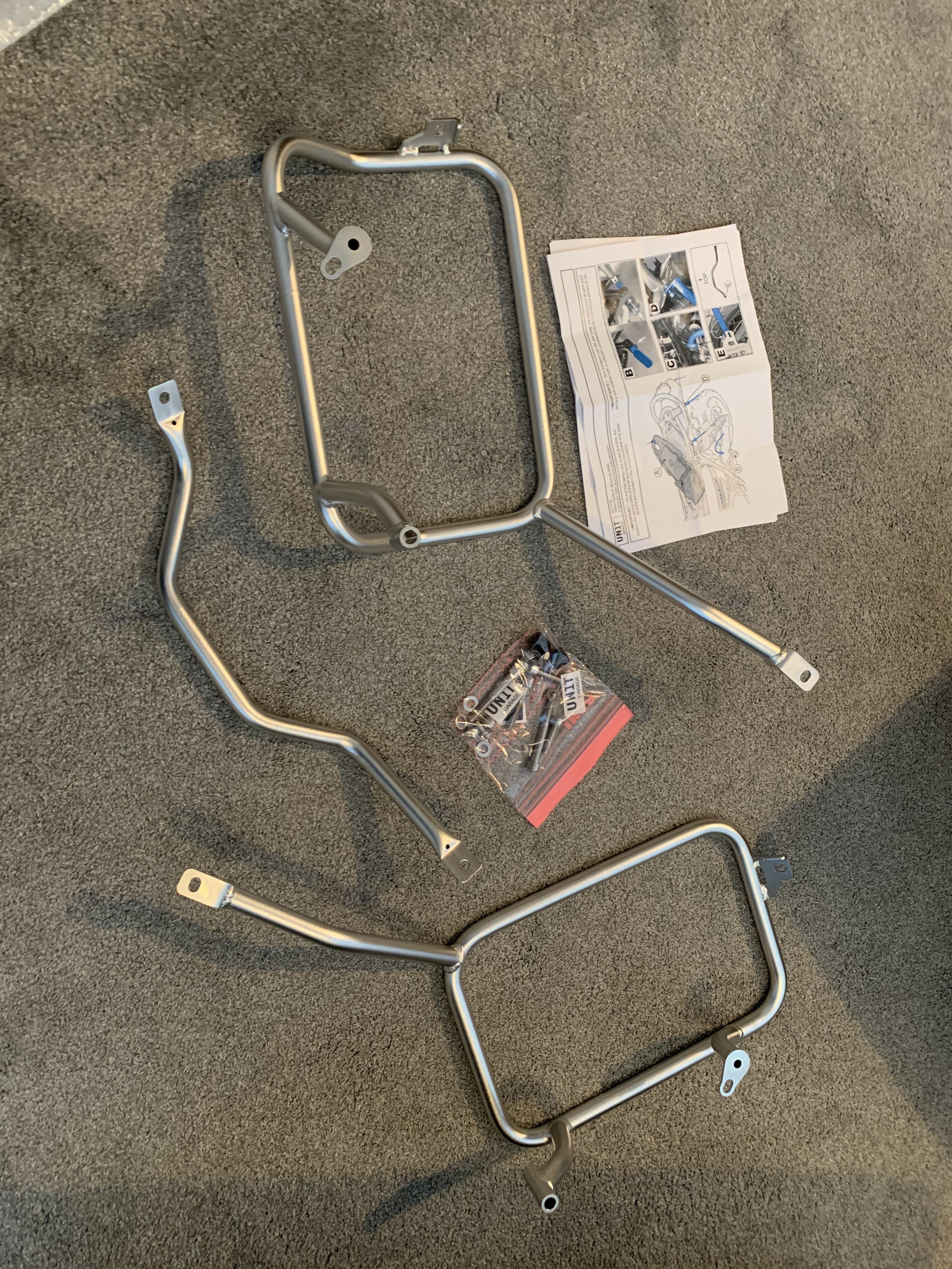

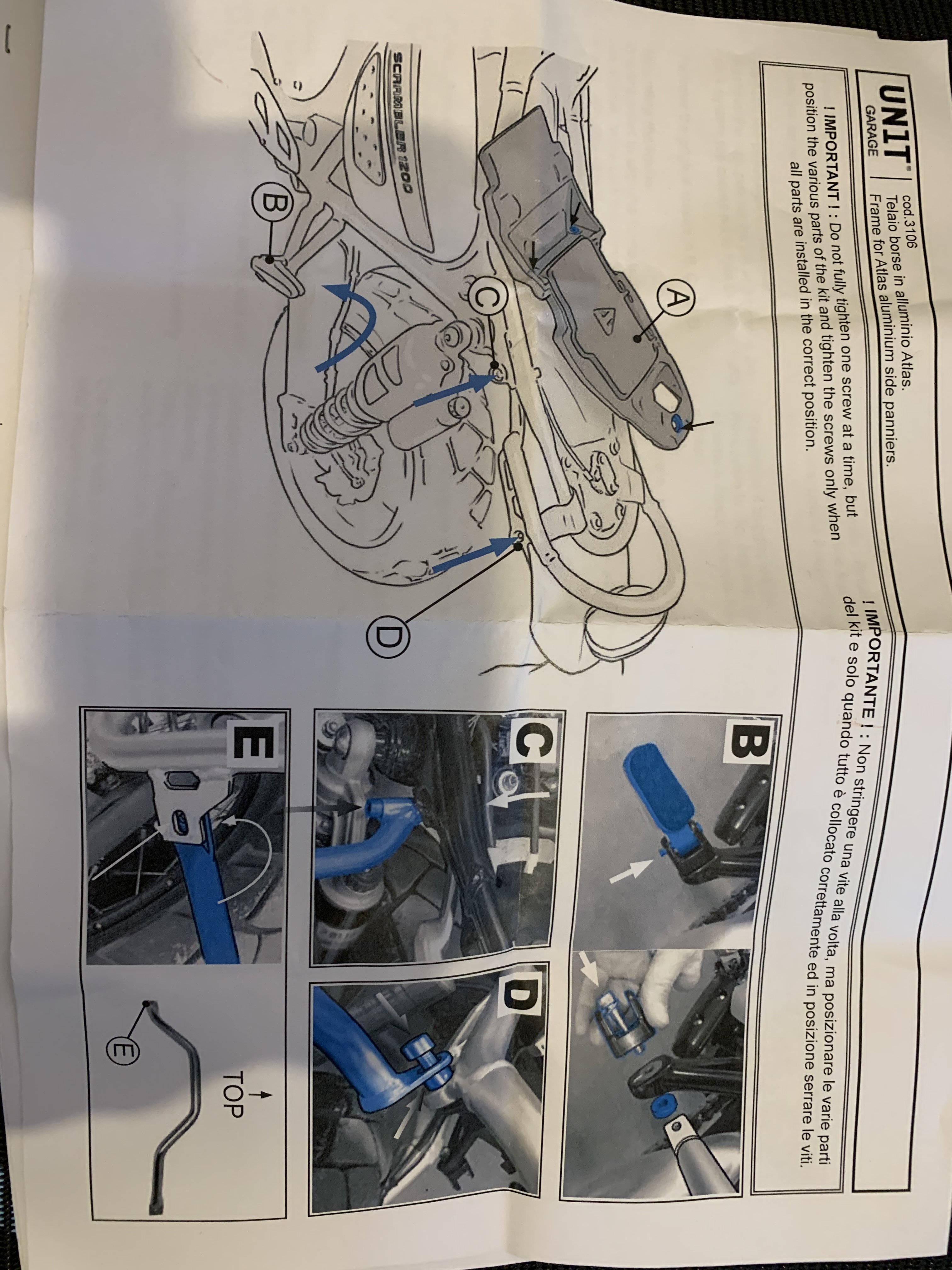

    Well the panniers turned up quick and we’ll packaged. UK import duty set me back about £70 and I did use an EROI number which may have helped speed things up.
    Not yet fitted the panniers but they look great. Offered up one side and the fit looks good. The finish is the same finish as the stock engine bars and rear hand rail - top job.
    photo attached of the panniers and the 1st page of instructions.
    More to come.

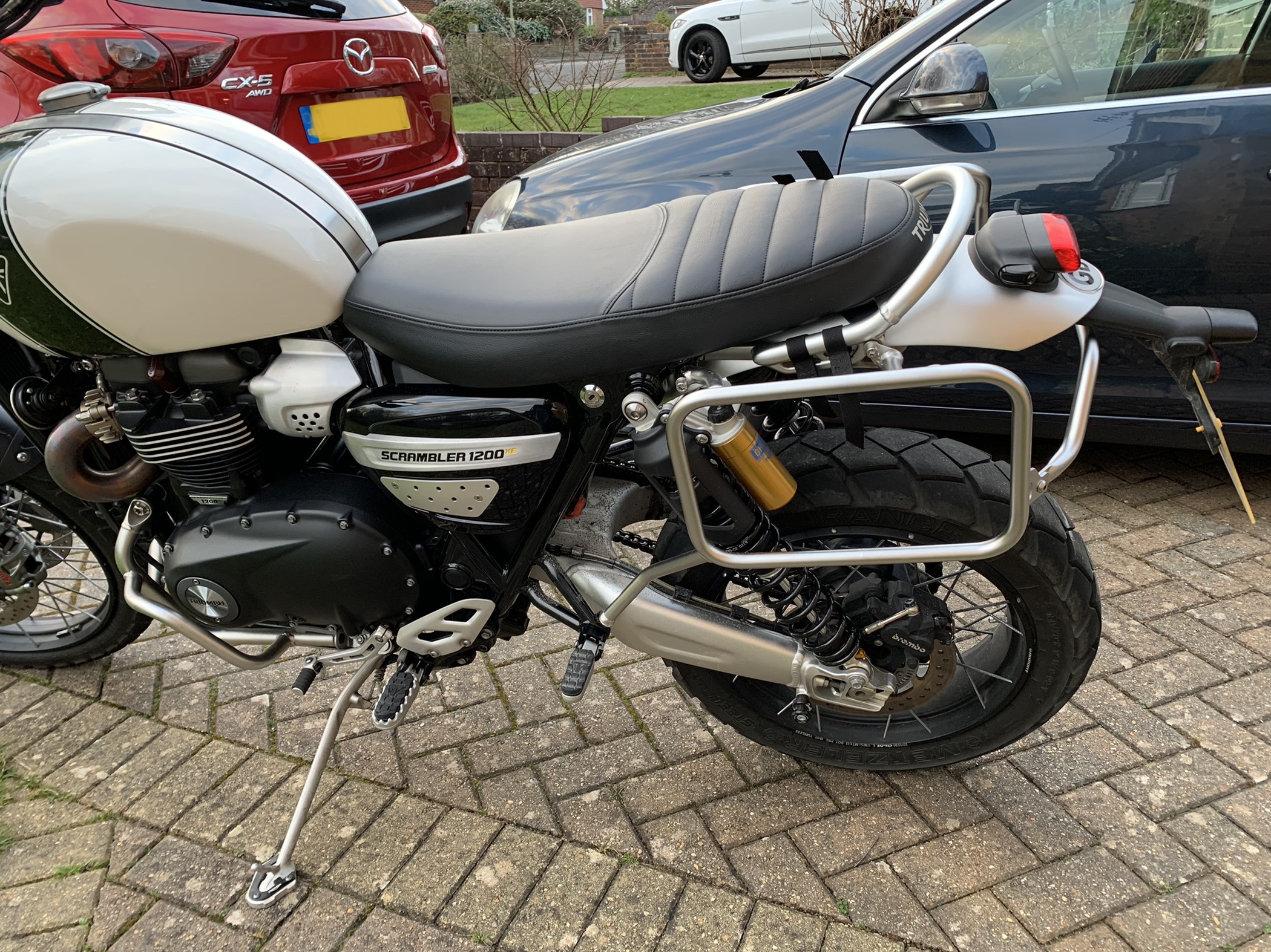

    Got the off side pannier mounted over the exhaust last night - instructions are a bit lacking, there was a bit of head scratching but I go there in the end. Got to say, for a tangle metal, it's pretty sweet. I'll post some pics once they are both fitted along with some detailed shots on the mounting points.

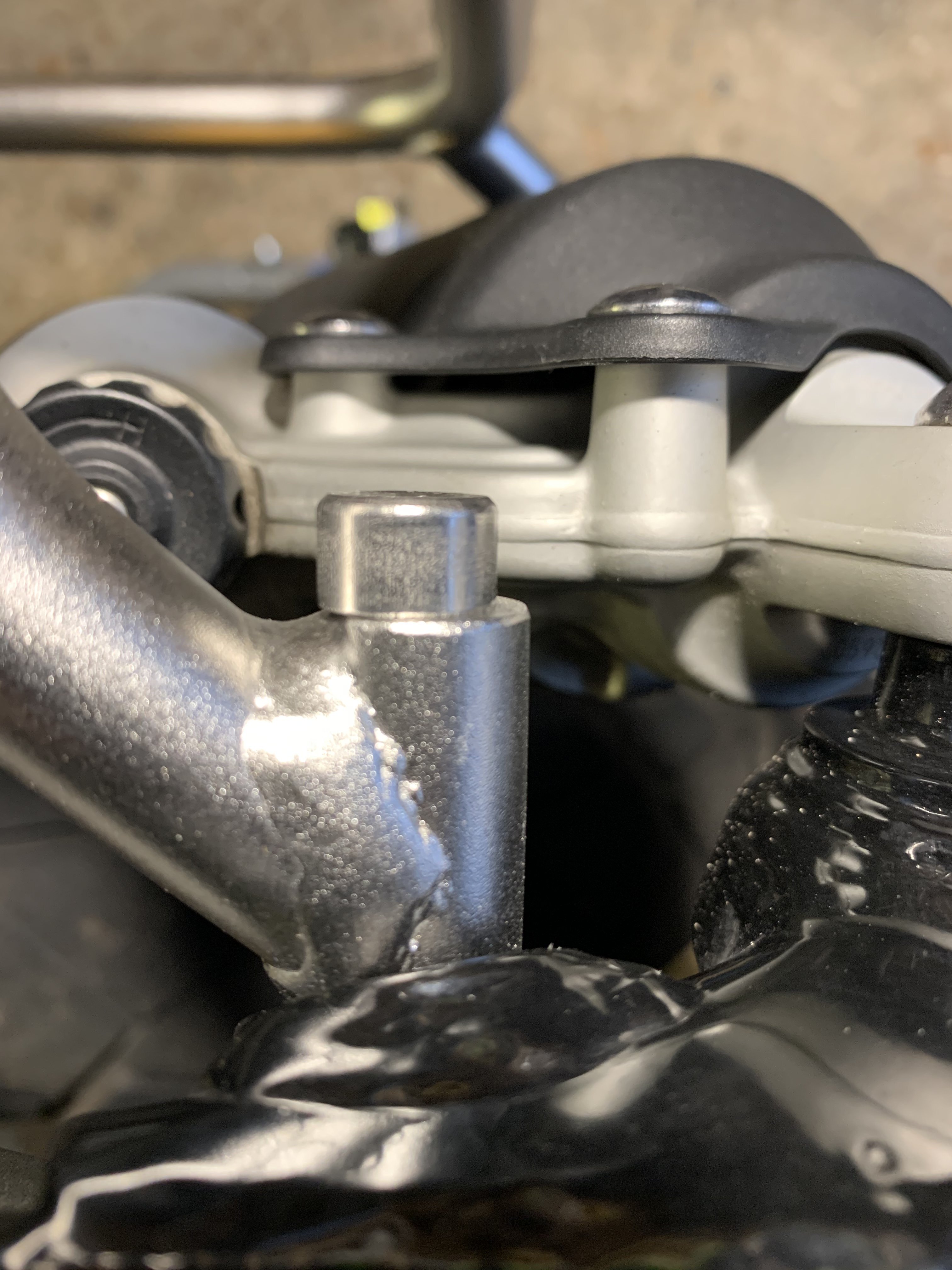

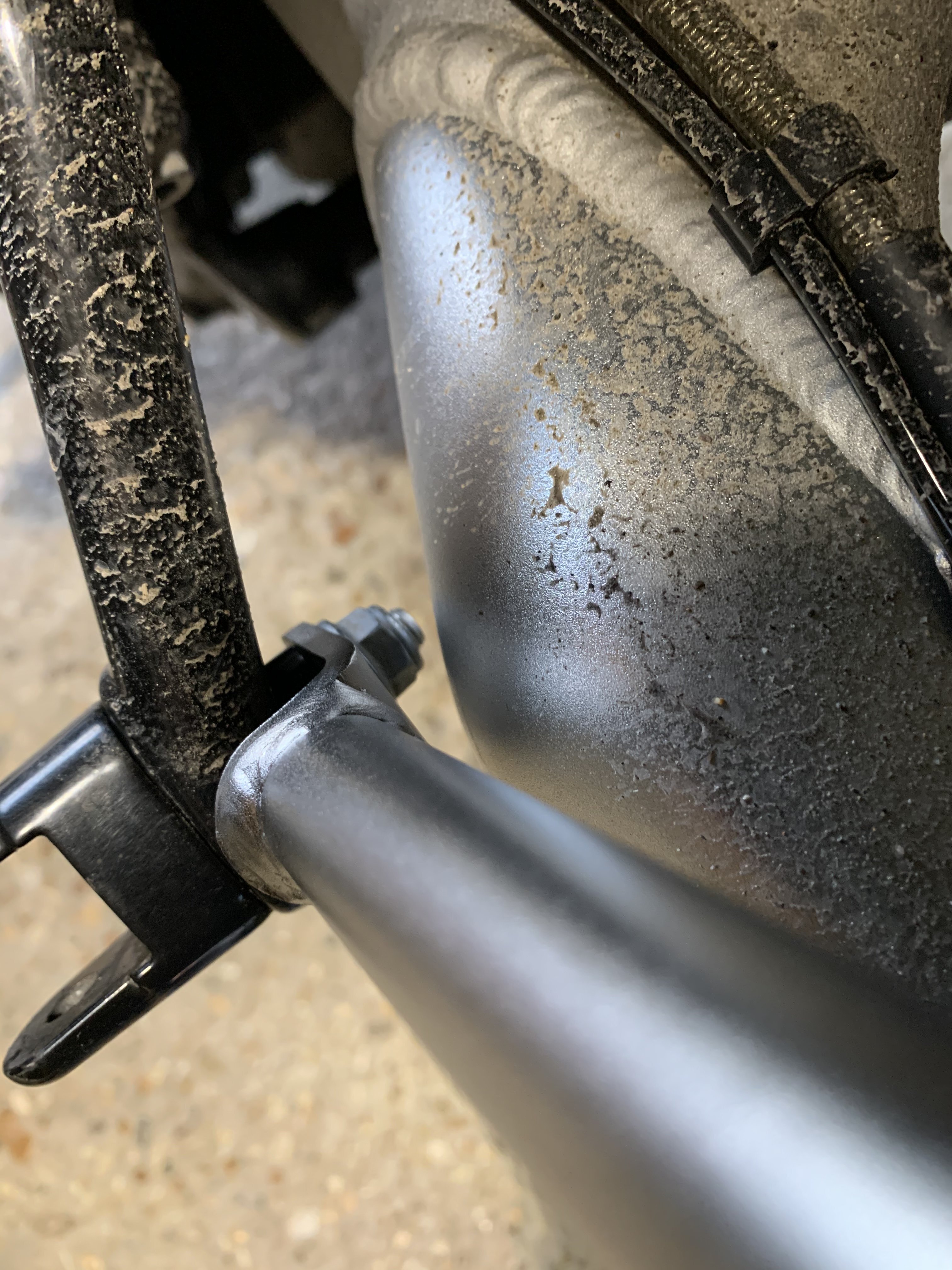

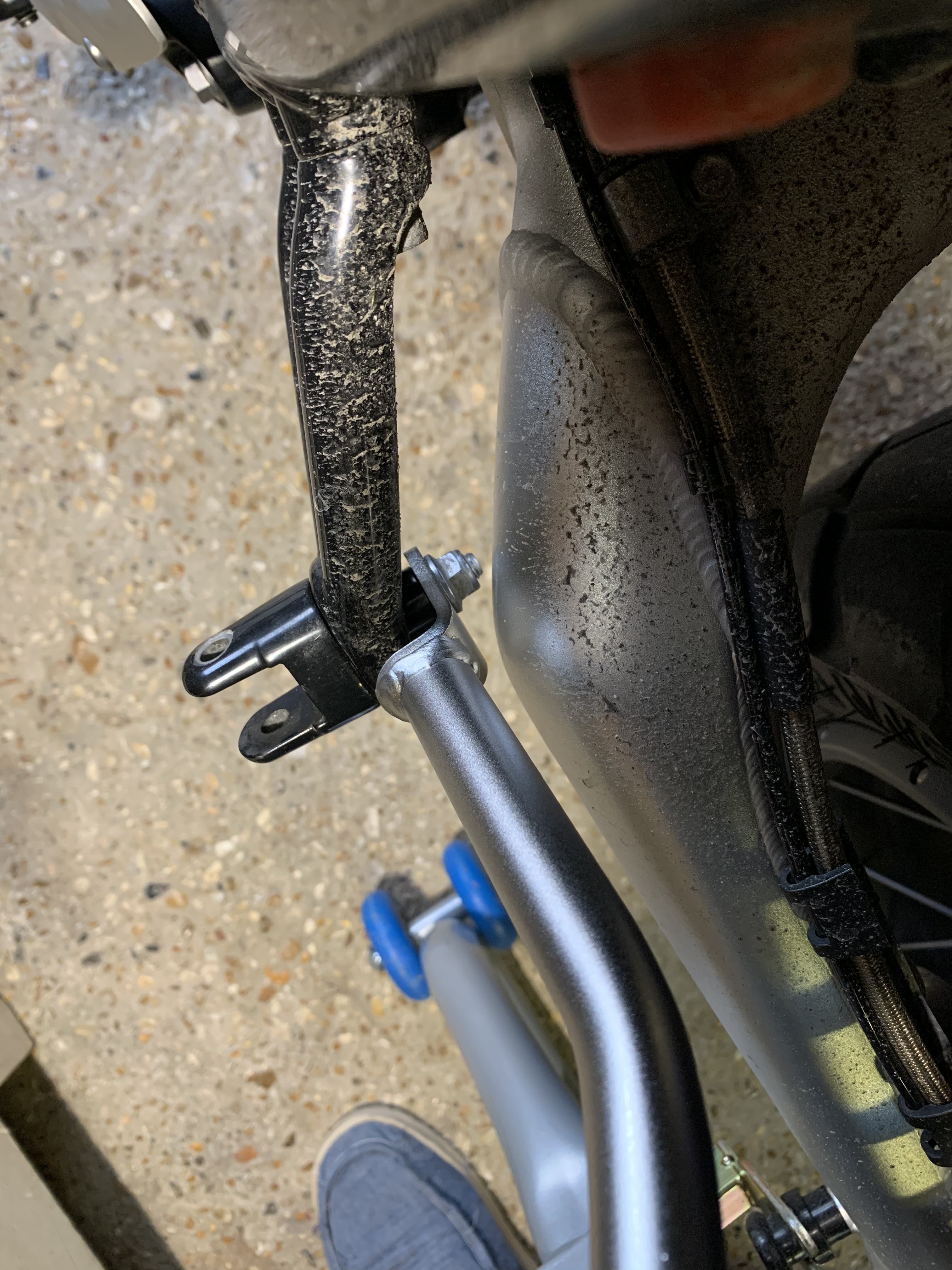

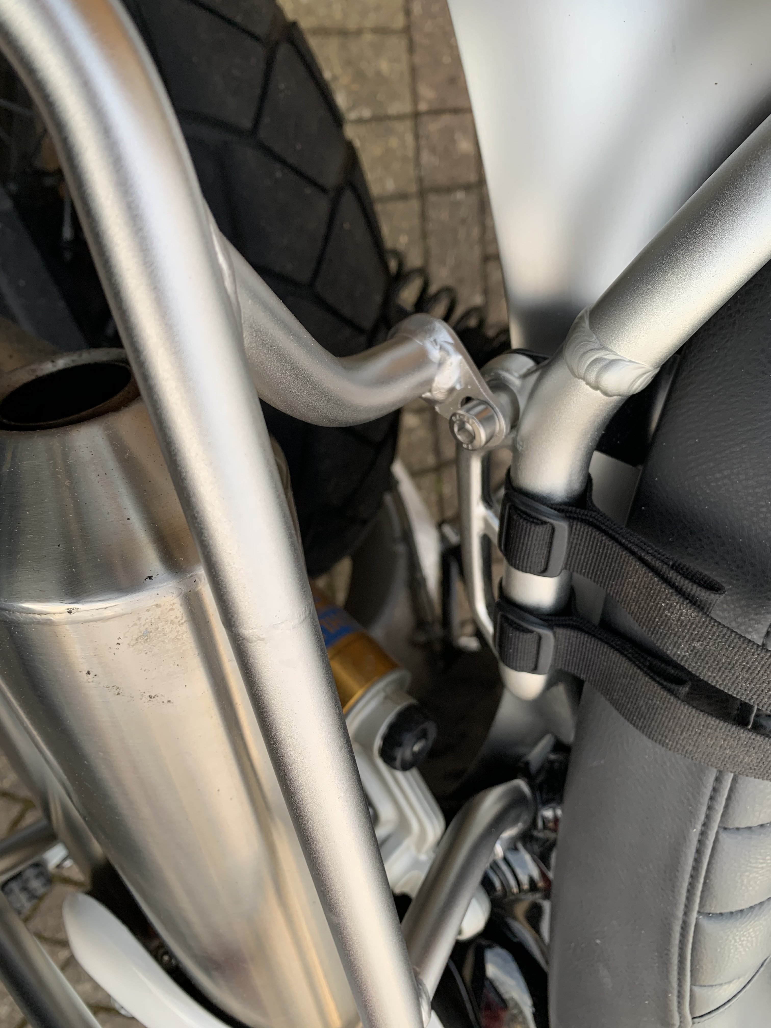

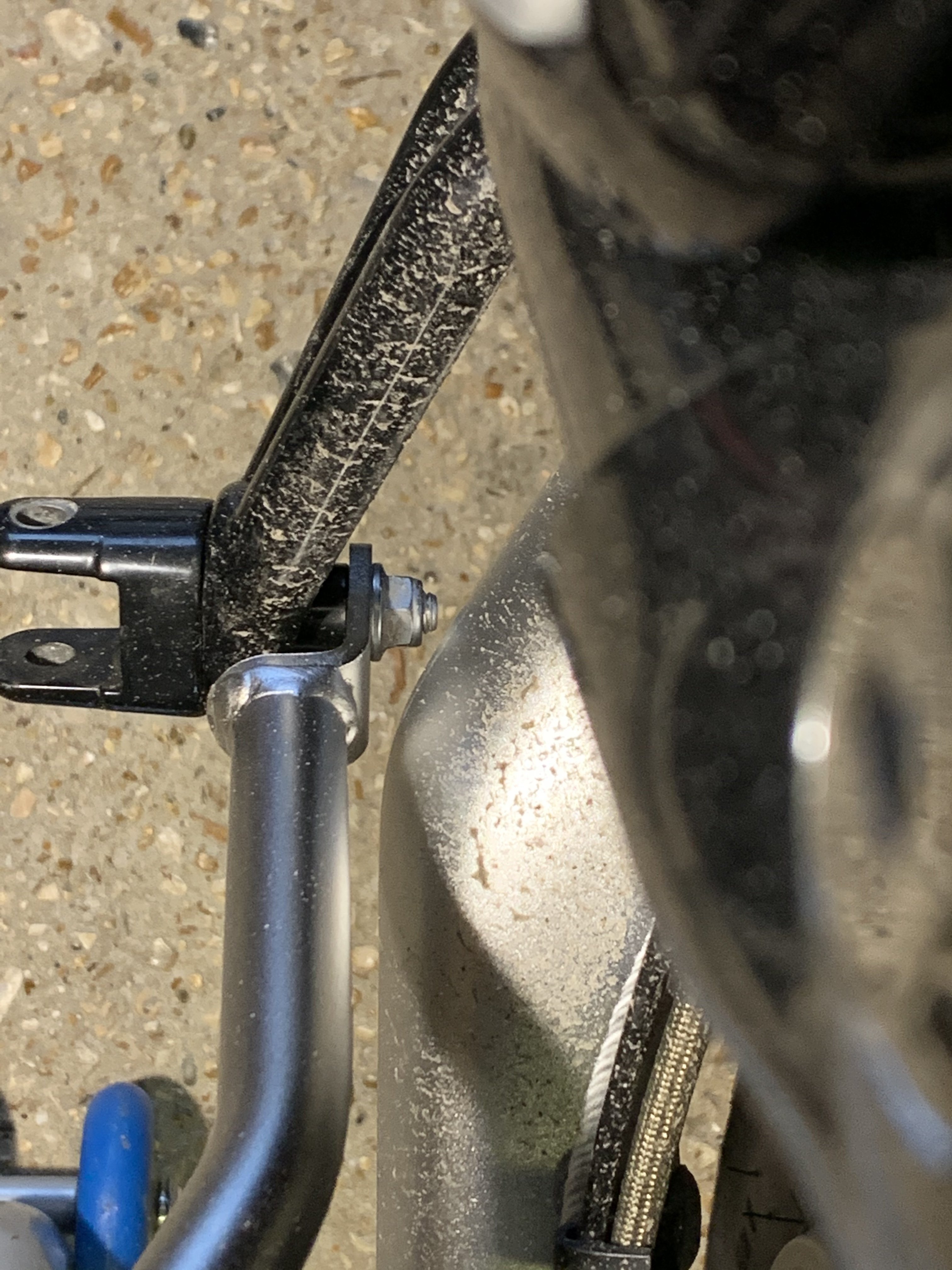

    Got a bit further tonight fitting the panniers in between work, home schooling and other chores (the joys of being a grown up). Anyhow it’s starting to come together - my only concerns are the proximity of the passenger foot peg bolt to the rear swing arm and the bolt alignment at point ‘C’. The the foot peg bolt could be resolved with a little fettling but as I’d had to stop playing I pinged a photo over to Unit Garage to see what they thought.
    Couple of pics - please don’t judge me on the dirt ;O
  8. Bug
    Bug Well-Known Member
    Apr 29, 2020
    152
    Aylesbury
    Does seem a little close
  9. Uppers
    Uppers Member
    Sep 27, 2020
    Winchester
    Unit Garage have come back which shows that their customer service is working :)
    The advice was:
    “This is not a problem as the swingarm does not move side to side, it only goes up and down. It is correctly mounted.
    if you prefer, you could add a small washer underneath the screw head. But as I said, it is not necessary.”
    Confirmation that all is fitted correctly and a confident response - can’t argue with the logic that the swing arm should not move side to side.
    Some form of OCD in me does not like it being so close so I will make some minor adjustments to increase the clearance. I’ll add a better photo.
    What else. The mounts in C I mentioned above could do with a nylon spacer to centralise and support the bolts - very minor and picky so not a real issue.
    Oh and the bolts for the brace that runs across the back take a different size Allen key to all the other existing bolts. Trivial really but keeping them the same would have been nice.

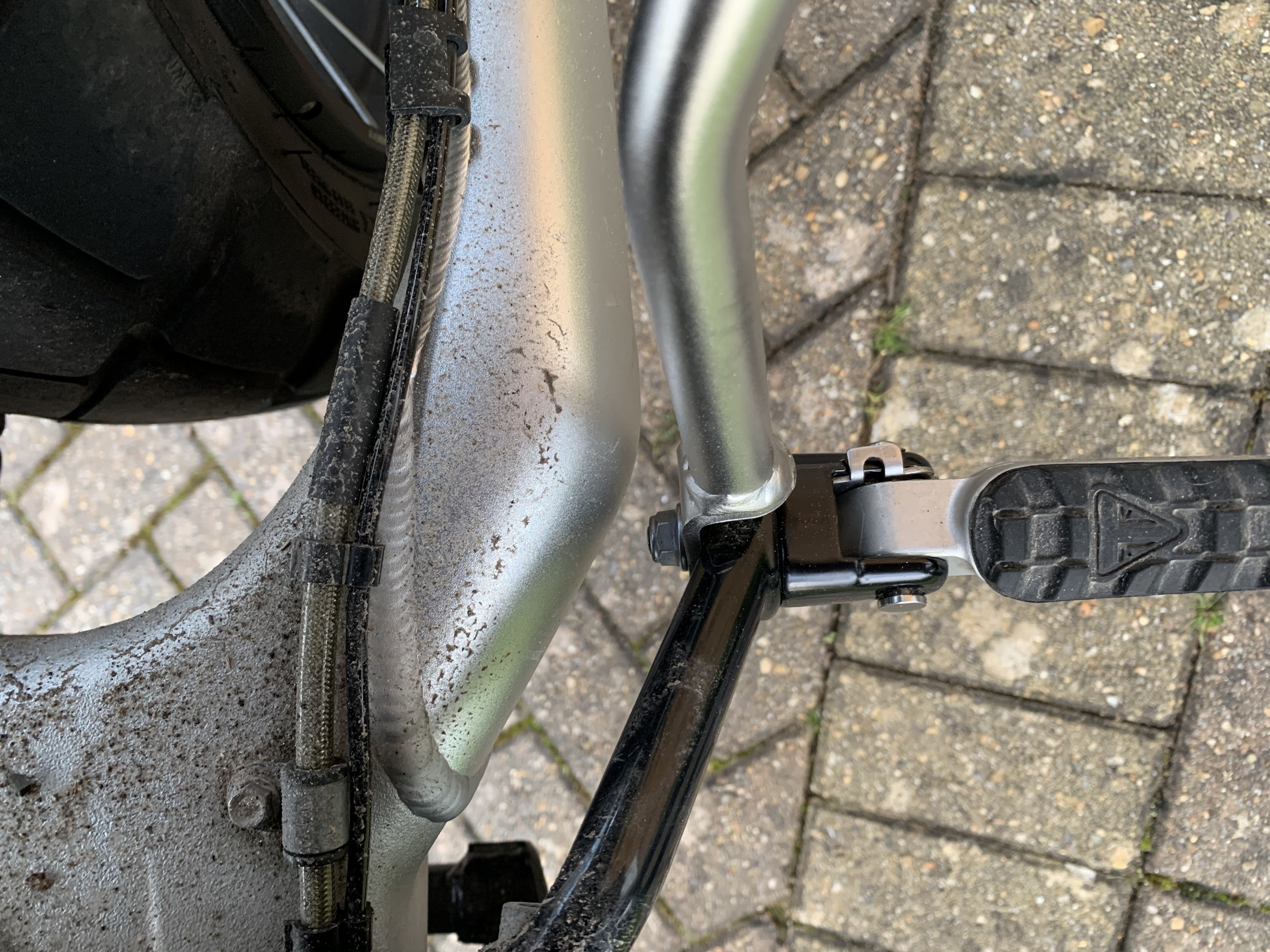

    Can you just turn the bolt around so the bolt head is near the swingarm and the nut and bolt is on the other side?

    I like your thinking Haro! The bolt head recesses behind the foot peg but swapping it around might be an option - I’ll have a look in mo :)

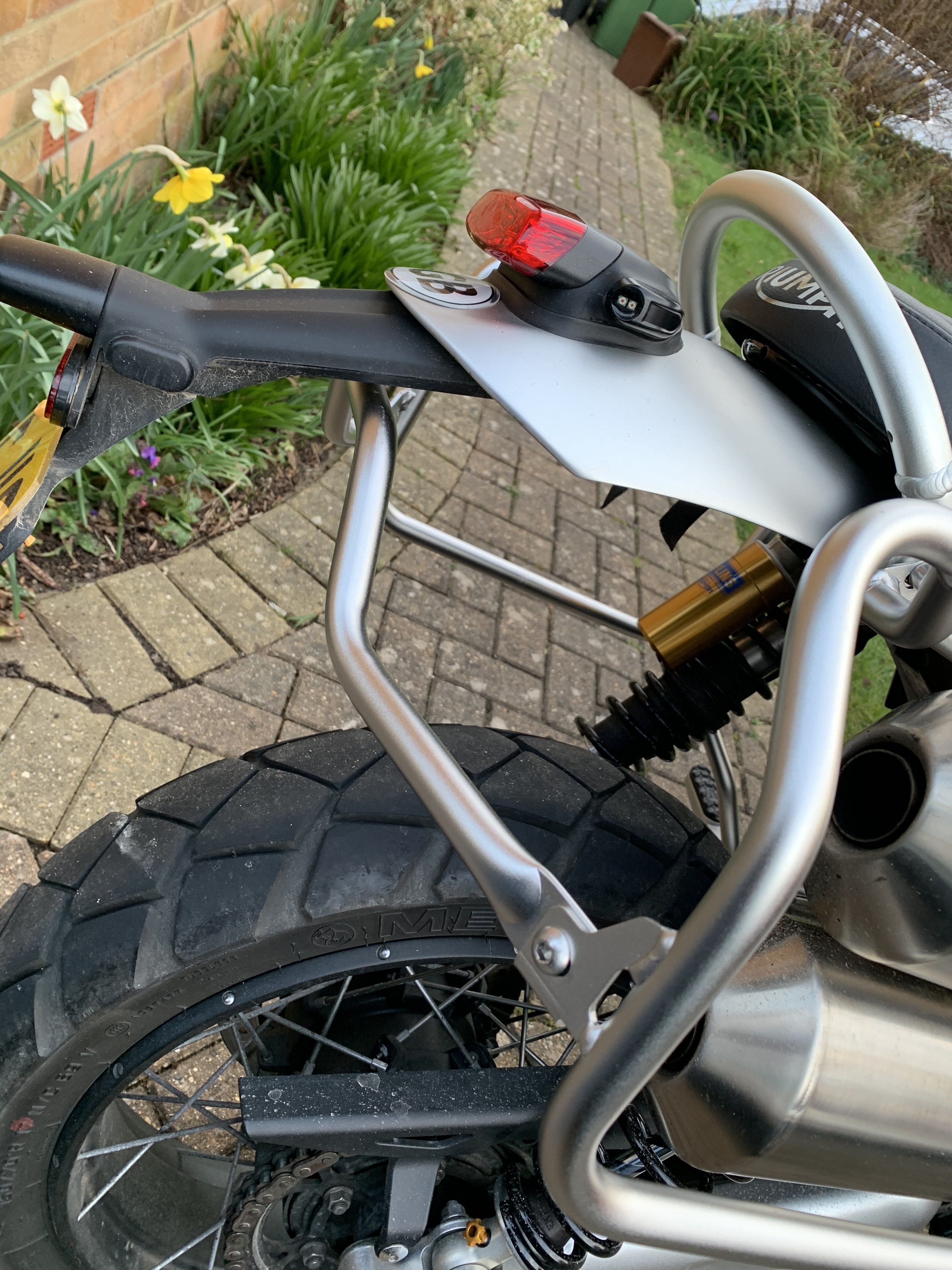

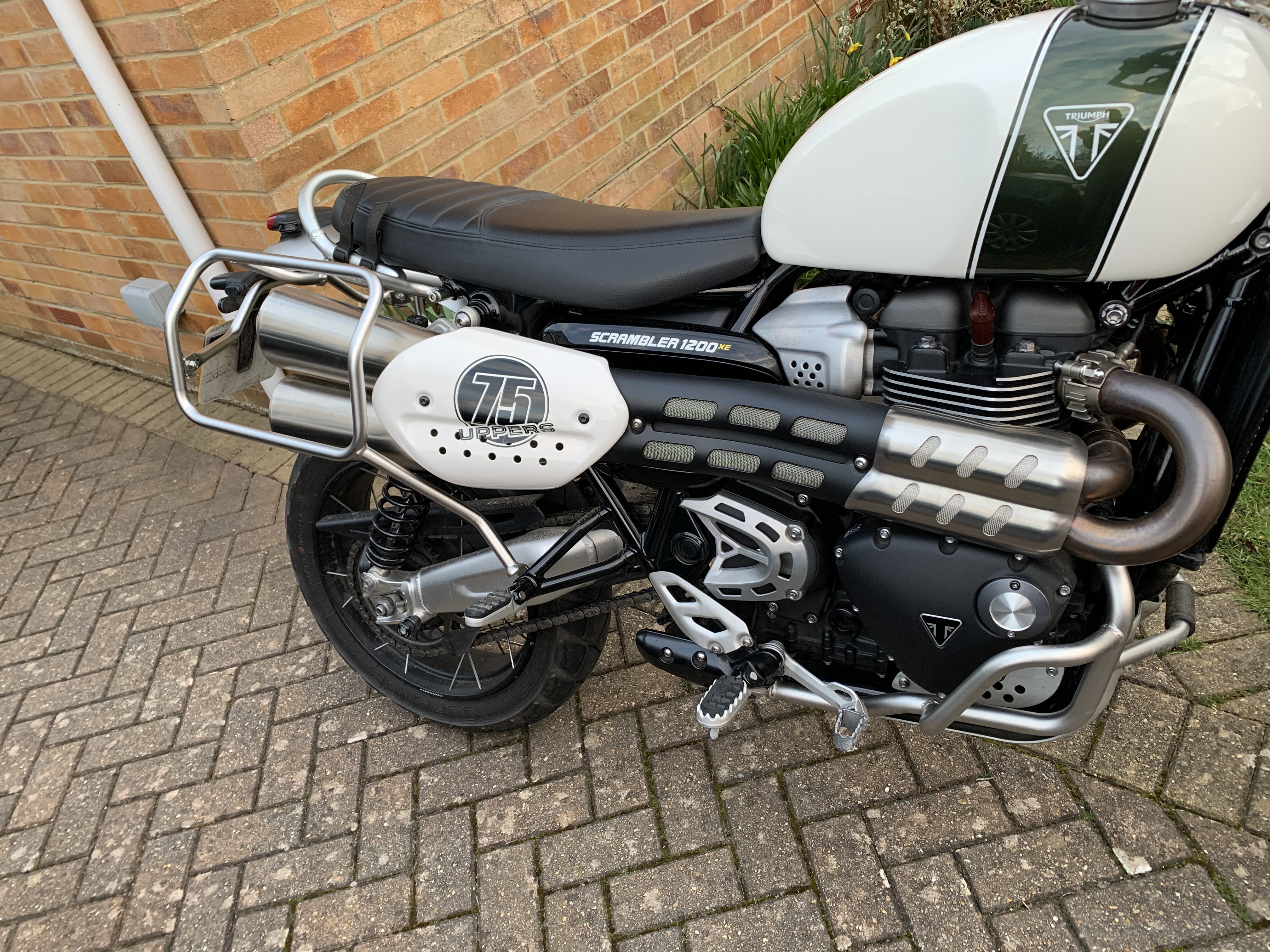

    Got there in the end after far too much faffing on a simple job.
    Only option to resolve the clearance issue in end was to trim down the spacer and bolt. Maybe not required but I’m happy now.
    Rear brace may clash with some of the tail tidies - one to watch out for.
