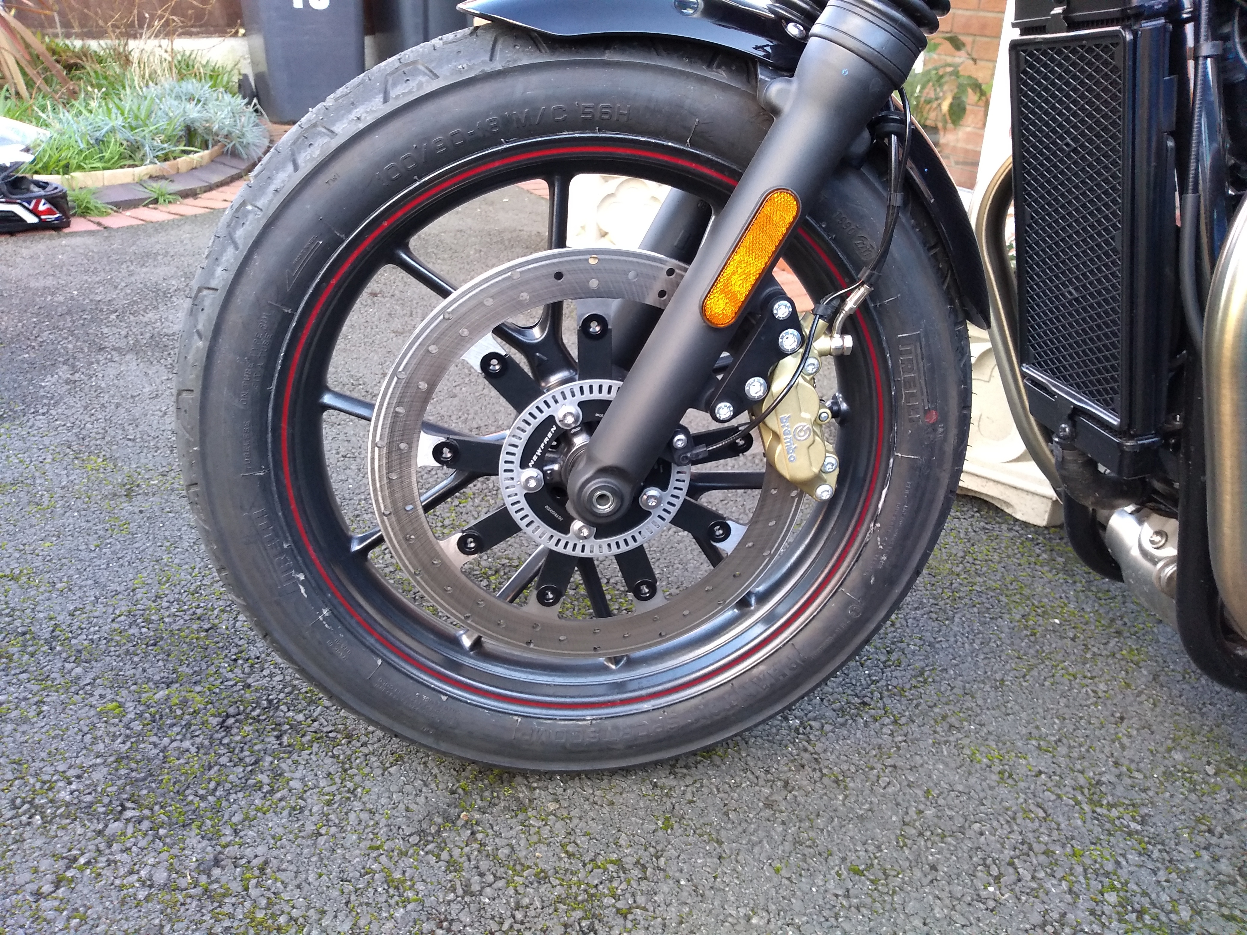

    I have a 4 pot Brembo caliper/floating disk conversion for the Street Twin which I'm seeking due to change of vehicle. It's basically a straight forward swap of parts with a slight reroute of cable and house. The kit cost over €400 but I'm selling for £80 Inc post. It's done about 3000 miles. I have included photos on here before it you can look up in for sale.
    I managed to get hold of one of the last floating disks from Triumph which was a good improvement over the original disk. I have that for sale also, virtually unused no mileage on it apart from movement in the shop .
  8. Jimalmighty
    Jimalmighty Member
    Sep 22, 2020
    44
    Dorset
    Interested to see a pic for sure

  10. Pegscraper
