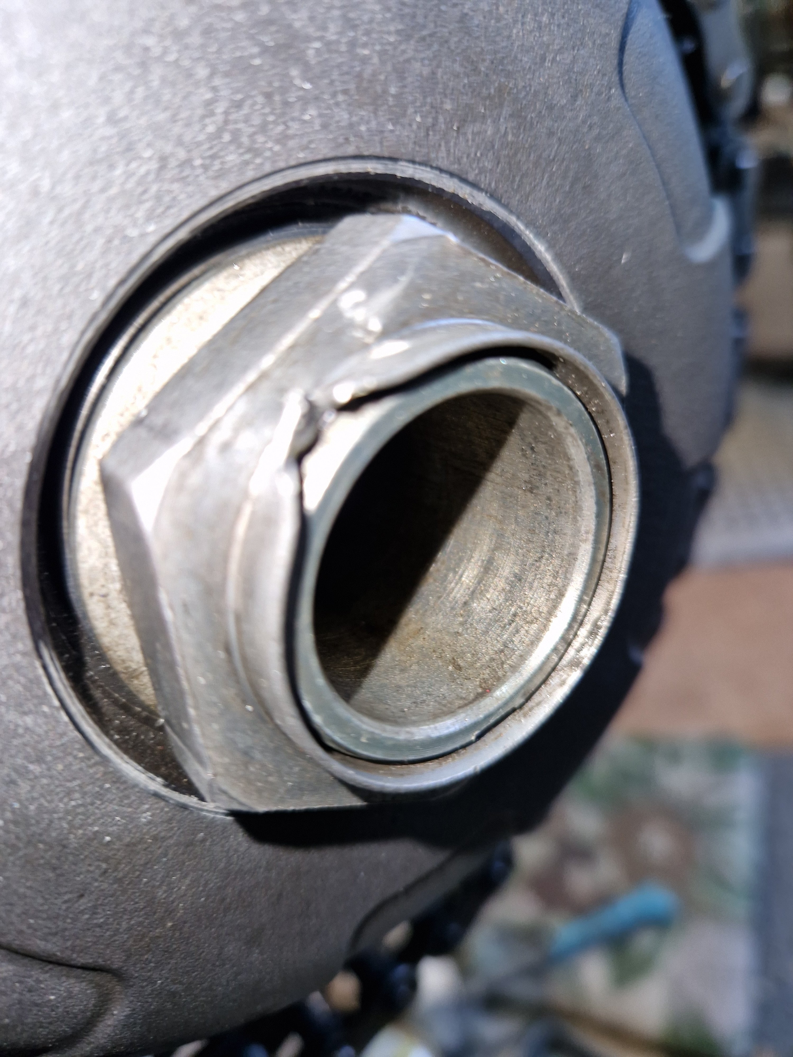

    Here's a suggestion that came to me from another forum:
    Mix up a solution of 50/50 ATF (Automatic transmission fluid) & Acetone. Spray it on or brush it on. Leave it for 20 mins then try the 46mm socket again.
    The acetone will dilute the ATF & allow it to penetrate to the threads. Then the acetone will evaporate. Leaving just the oil (ATF) where it's needed.
    I hope this helps.

    ATF is very "thin" and designed to handle slip ...!
  6. Alan Gilbert
    Alan Gilbert Senior Member
    Nov 22, 2018
    304
    A windy gun and an impact wrench are one and the same thing.
    You will always achieve far higher torque with an impact wrench than a breaker bar and so if the garage failed, be sure they were using the gun to remove and not tighten the nut - it isn’t inconceivable they were turning the thing clockwise in error.
    Forget homebrew release fluid - use the correct stuff. Why do folks think you can make something better out of acetone and atf fluid?
    Trying to grind that off without damage will be very difficult because of the flange base to the nut and it appears to fit in a slight recess.
    Just be persistent and you will get it.
    Soak it in release fluid for a day or so and try the impact wrench again.
    If no joy, . . . Short sharp doses of accurately applied heat using a solderer’s blow torch followed by impact wrench and if this fails, progressively longer application of heat around the circumference of the nut - it will come eventually

    Hi Daniel, as some members have rightly said you need to use either an impact/air wrench, they do the same thing, 90 psi is of little use and will not be enough to remove the nut, you can hire one cheap enough. I posted a comprehensive thread on this very subject a year or so ago, I have overhauled a fair few of these now, the removal of the hub will undoubtedly collapse 1 of the 3 bearing assemblies, there are a number of spacers and seals in the hub, these need to go back in the correct sequence, the eccentric hub is often seized in place through a lack of servicing, by that I mean often it is not disassembled and re greased at the correct service intervals. All the parts are available, however depending upon what requires renewing it can get expensive, the last one I did cost ÂŁ220 for the parts alone, although I did use genuine Triumph OEM parts. I can let you have a copy of the genuine factory Triumph workshop manual for the cost of postage if that helps, these are far better than a Haynes Manual, remember to torque the hub nut Etc to the correct value. Good luck with the disassembly.

    It's really important that you get it off to grease the needle roller bearing. If it has never been serviced there is a real danger of it seizing when riding. I know someone this happened to at motorway speeds and he crashed but luckily survived to tell the tale :cold_sweat:

    An interesting point about 90psi being too little. I don’t know a thing about operating pressures for air driven impact wrenches but certainly, I would expect the air tank to have far higher pressure than that - perhaps if the tool used 90psi, it does so through a regulator. Either way, a decent impact wrench will have that nut off - some of the electric wrenches are animals and I would expect would cream that nut, even without heat!!!
    Windy guns need the correct air pressure and fittings. The Honda Civic cam pulley bolt is the infamous arbiter of all stuck nuts!!!!

    I suspect electric and perserverence is the way to go. . . .

    I think I've located a mains powered impact wrench...and, what with payday...how many more excuses do I need!?

    We wrestled with the main bolt that held the crank weight on an old Honda car some years ago with a 3-4 foot breaker bar. We put a dent in the concrete floor where we braced but still failed. So we went and bought a "1300 ft-lb" air powered torque gun (USA Harbor Freight), click click and it spun right off in 2 seconds. Also terrific for initially loosening counter shaft sprocket nuts from the factory.

    Have the same issue on a 2019 1050 Tigersport. The nut initially started to move but instead of it getting easier after about 3 turns it began to go tight it moved along the shafts ok and got to the edge but eventually it just seized solid. I have been using a 3ft bar and the 43 mm socket and now I am having to consider grinding it off.

    Hiya...i took the bike to my local Triumph dealer...and asked if they could loosen the nut for me.
    Using their even more powerful tool than my local mechanic...they whipped the nut off in 2 seconds and then did it back up to 100nm for me to pootle back a few miles to home. At 100nm I could then get it off no problem.
    If you have managed to loosen it a bit, you can always retighten then loosen, retighten then loosen...repeat and kinda work it off?

    Thanks Daniel I finally managed to get mine off by using a drill to drill out a notch which was big enough for me to get a cold Chisel in and then with their club hammer and having the bike raised up on an ABBA stand I managed to work it all the way around and eventually got it off and I was holding my breath with the thread would be damaged on the shaft but it was good so I'm so pleased to have got it off now order their new nut which is about 28 quid with the postage anyway thank you very much for your help and I hope other people don't have this same problem though I expect some people will

    , anyway thank you very much for your help and I hope other people don't have this same problem though I expect some people will i still don't understand why the nut became jammed as the thread seems okay on both parts it must just have managed to get in a cross threaded position as it was undoing
