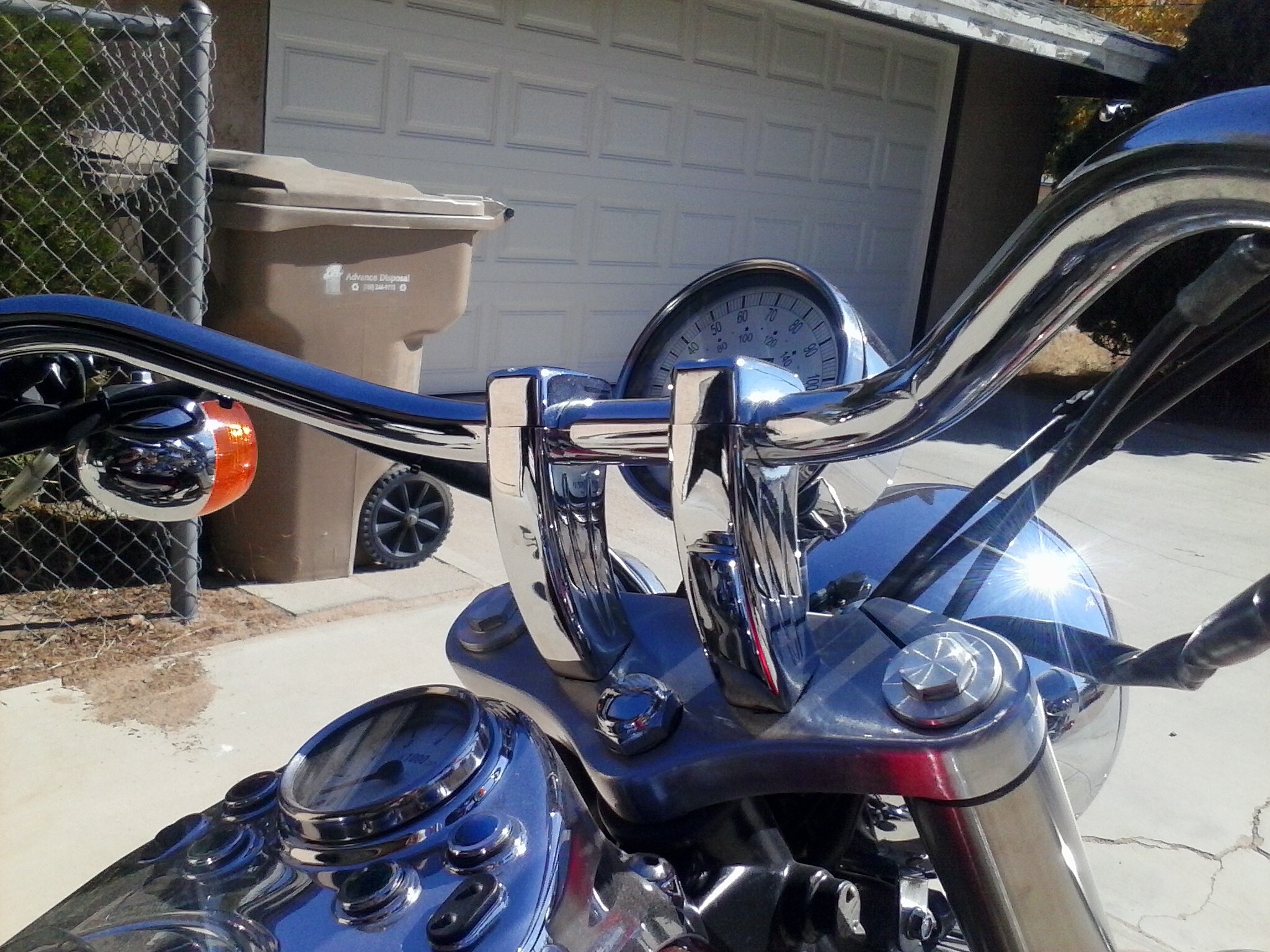

    I have trouble getting ache in my middle back. I added about 3" risers and rhe problem was gone. Sounds like you have too much weight resting on your hands. Both my Legend and my America have this done to them. It depends on your body geometry. I am rather long in the spine ...J.D.
