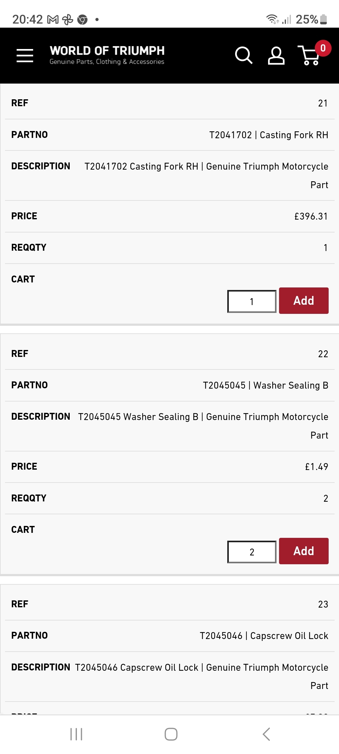

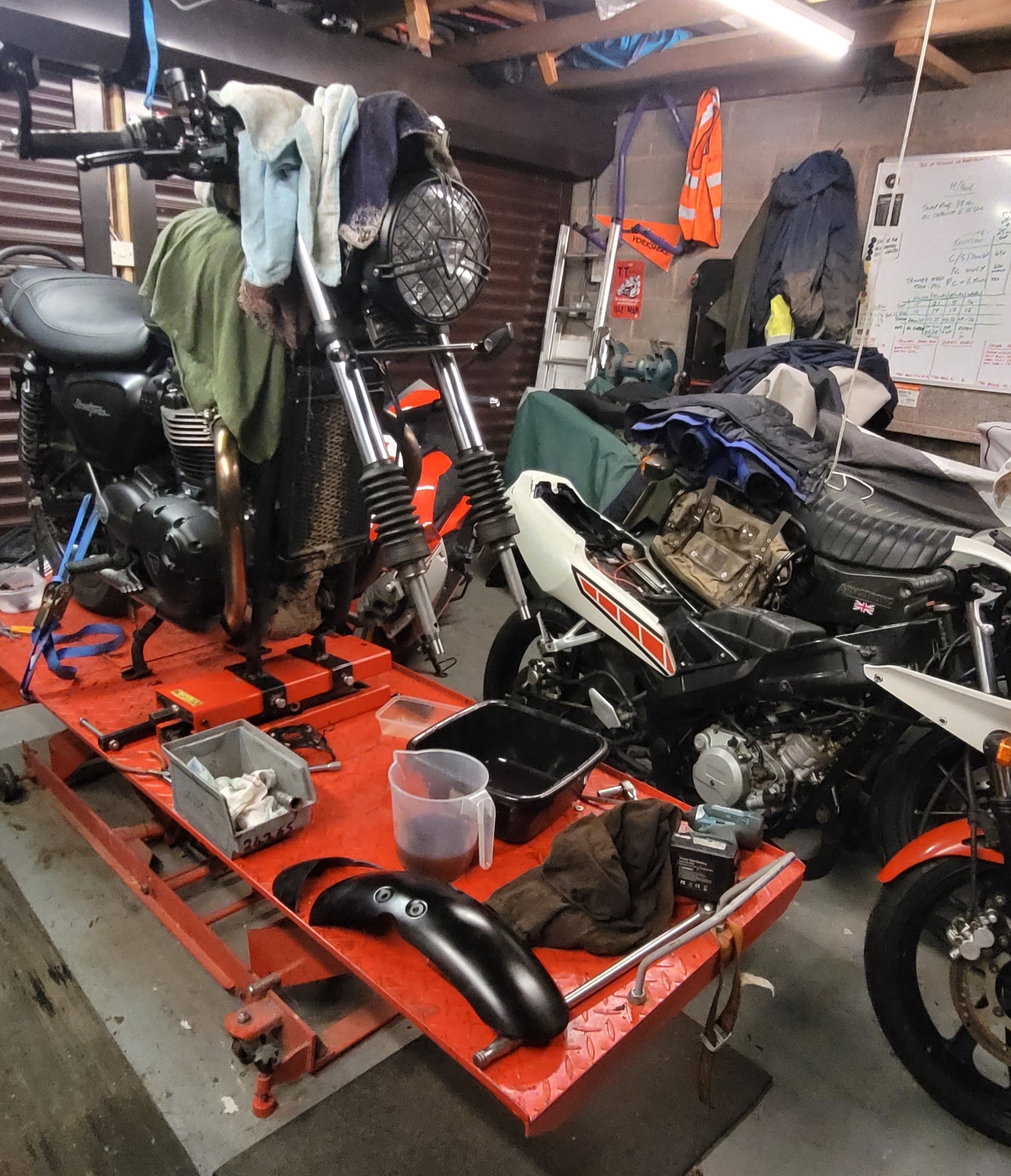

    Here's a picture from the 7th March
    Spot the difference, here's a picture from tonight.
    Yep the difference is somewhere between £500 and a £1000 :sob:
    #21

  3. Eldon
    Eldon Crème de la Crème
    5,135
    9,491
    Nearly funny : unamused: but have you seen the price of JUST the casting?
    #23
  4. littleade
    Mar 17, 2015
    459
    457
    Worcestershire
    Ouch, my bad sorry. I didn't see the last bit of text.
    #24
  5. Eldon
    5,135
    9,491

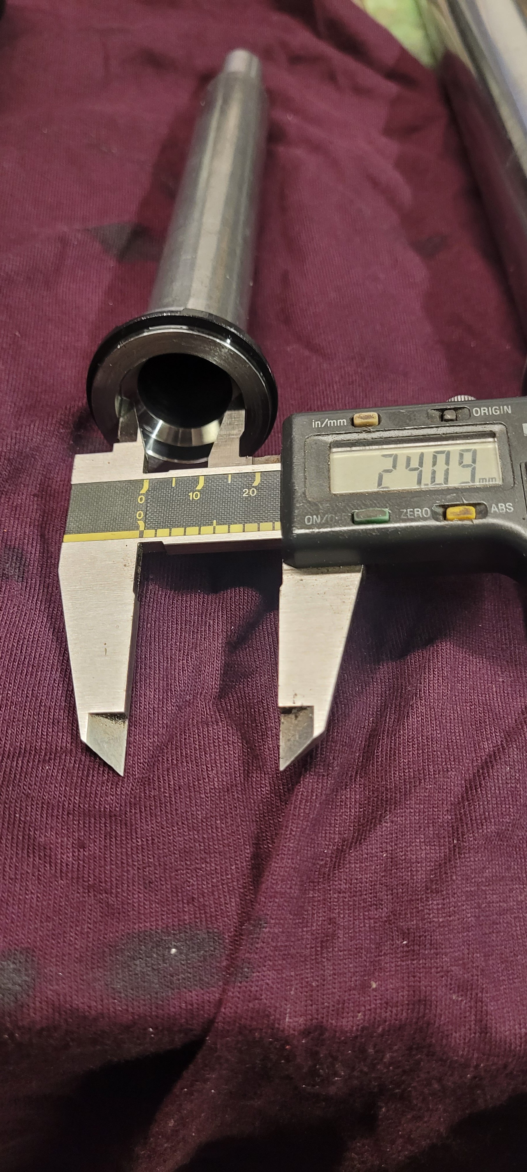

    And then there's the DISCONTINUED mudguard for a 5 year old bike bit :mad:
    Triumph is not filling me with confidence here and I feel it's a really poor show.
    The level of engineering can you believe is BEHIND Royal Enfield at this moment in time with a classic accountants ruling the show over sound engineering practices.
    Very similar forks on both but RE haven't robbed the machining off the damper rod....... yet!
    If you wish to lock the damper tube on an RE you need to put a special locking tool down the inside as we always used to, I have a few, but not on the 2019 Triumph Street Twin, oh no, these are SUPER ECONOMY forks so no internal machining is wasted :eek: A rammed in broom handle is required because how else can you lock a machined 18.5mm diameter with a 24mm diameter above it?
    Seriously unimpressed Triumph with your poor engineering!
    The Accountant's are running the asylum :mad:
    These are bolted in place using factory thread lock on a M10 x 1.0 thread. My pneumatic buzz gun has never failed this job until now and just couldn't hammer the spinning, unlockable, internal bit adequately to beat the glue.
    I ended up with the wife, picture it now, "ooh I've never used one of these before", just press the bloody trigger whilst I hang on for dear life on the sweeping brush head to try locking it FFS!
    I have three Triumphs and this has certainly placed a cloud over my ownership and my future purchases!
    Value engineering has to be the biggest con term under the sun; how can we get the customers to pay more for less?

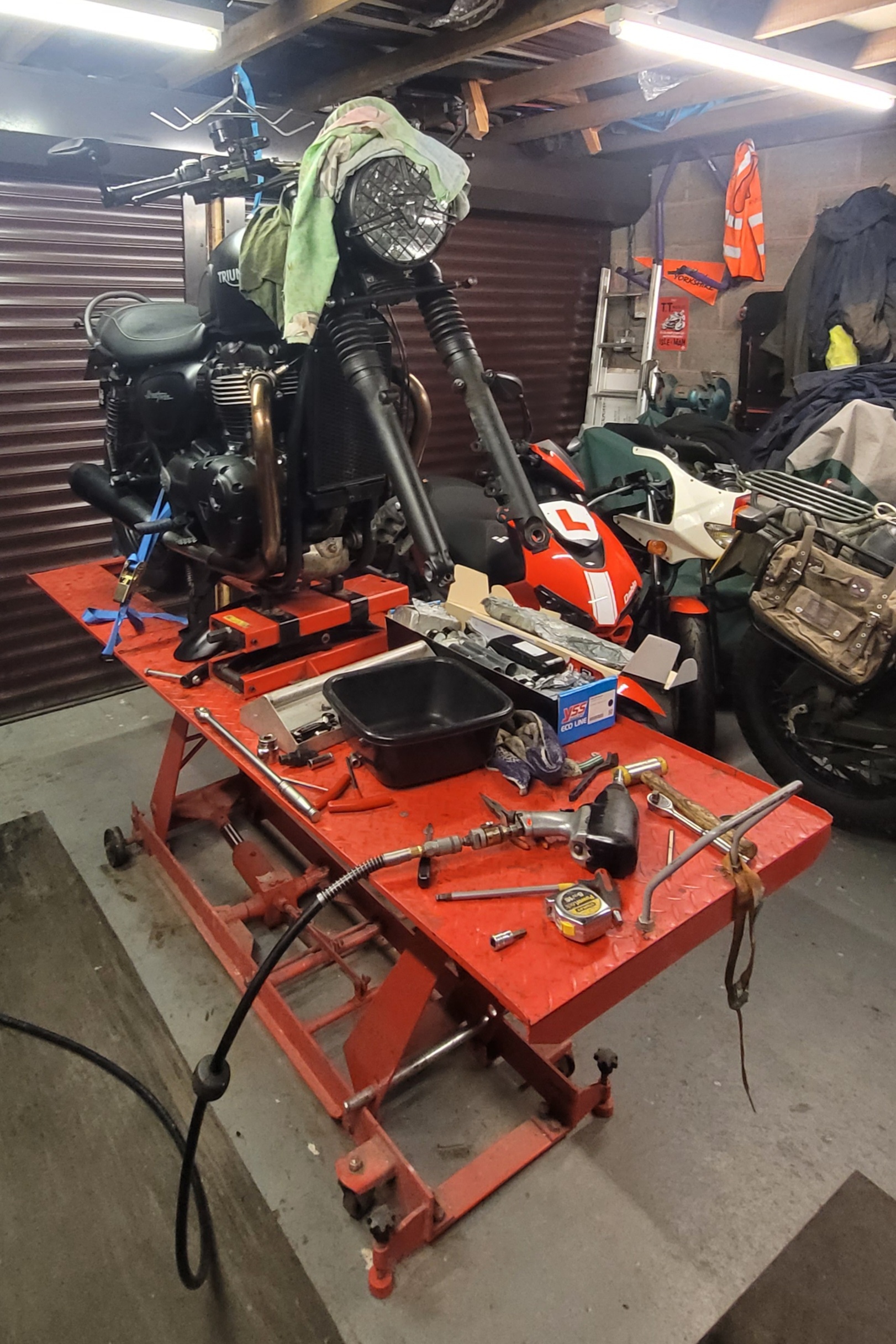

  6. Eldon
    5,135
    9,491
    The youngster denied it hit it initially, but with x2 big scratches down the front and seat tube, and only a few weeks old it wasn't holding any credibility!
    A quick tape measure of the aftermath soon convinced him.
    A brand new £2k pushbike with a raked frame, all for nothing :sob:
    And the reason he moved the ST was.....
    I had cleaned my old mtb ready for sale and it looked mint.
    He was going to wash my old mtb after he'd got it muddy on a test ride this morning ( a condition of him using it) as he has his eyes on it over his own mtb.
    All good intentions but.....
    #26

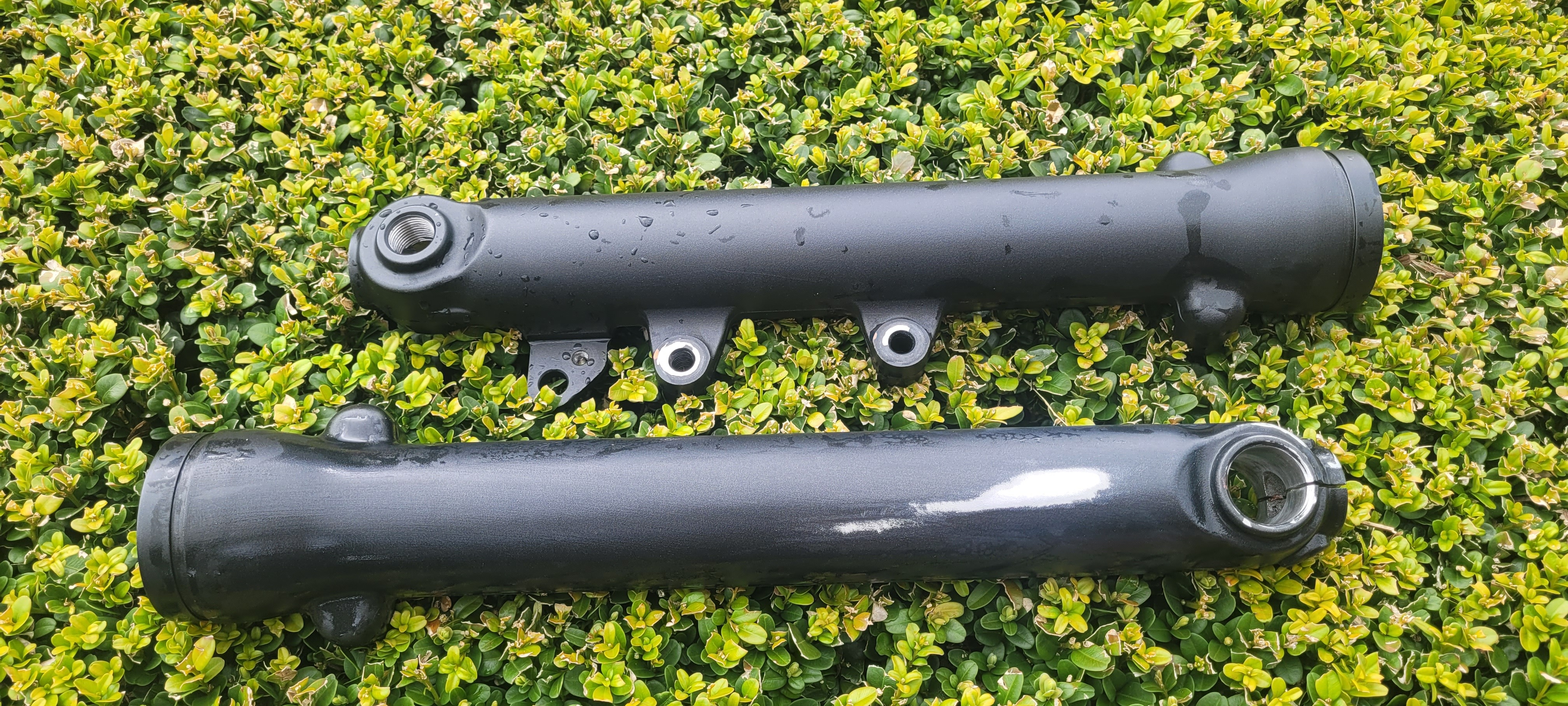

  10. Eldon
    5,135
    9,491
    Frustrating to say the least.
    Fork upgrade kit sits on the shelf for months awaiting install time.
    Forks get stripped x3 times in just over a week :rolleyes:
    Fortunately I have free access to powdercoating and all the marked bits are now in the boot of my car.
    Other bits ordered and so far we're at £150 and counting :tired_face:
    It's not the end of the world, and the youngesters attitude all weekend tells me he may have learnt something.
    The young un did thank me last night for not getting too annoyed with him although he did get a tube of T-Cut wanged at him at one point o_O
    #30

  14. Eldon
    5,135
    9,491
    @TonyG any further progress on your situation?
    Here's my fork legs, washed of oil (hot soapy water) and ready for powdercoating later this week ;)
    #34
