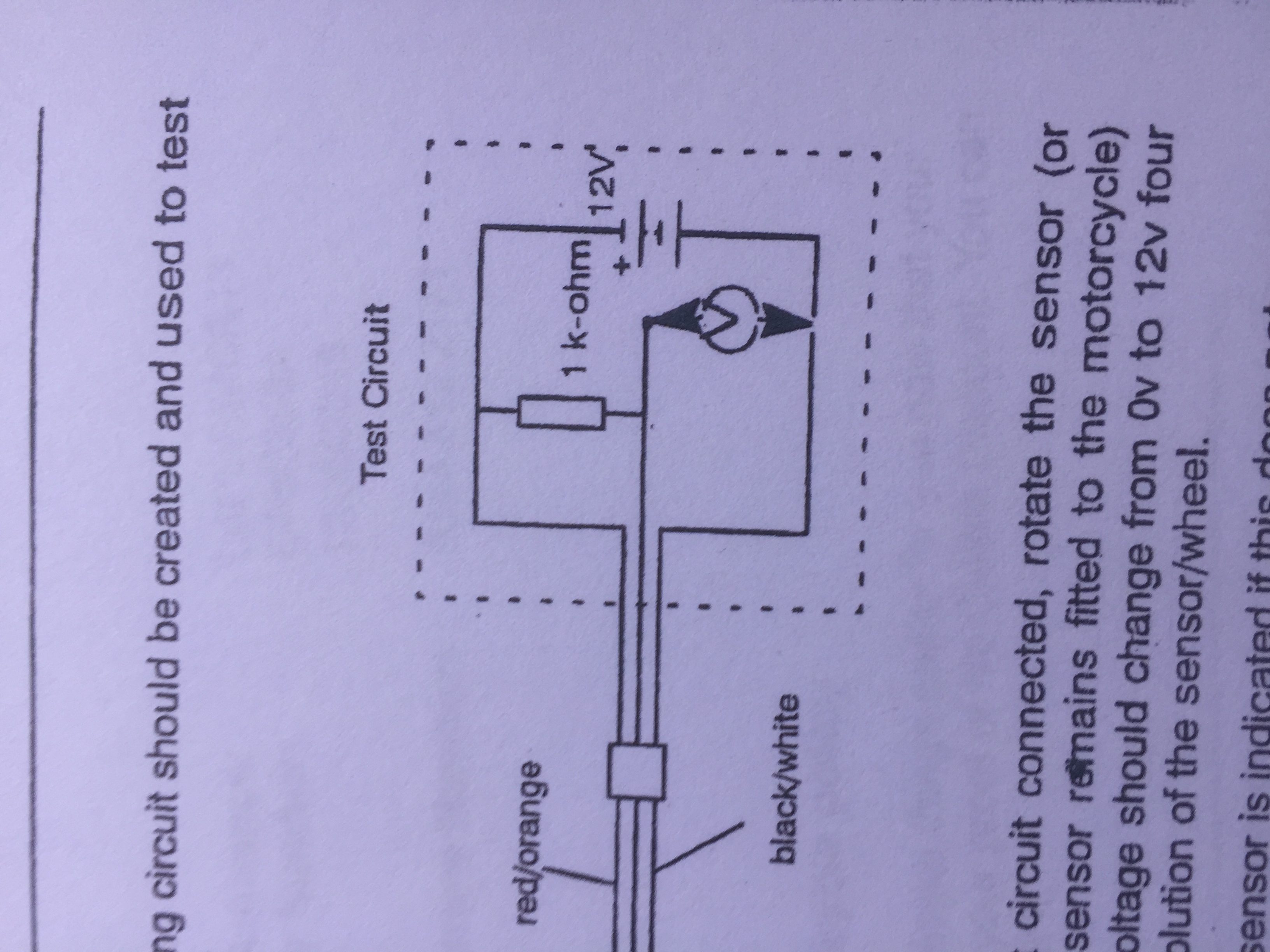

So . Found this and currently waiting for my outlaw to send me a resistor to make up a test circuit! However write up says to rotate drive within pickup this would infer that no magnet is required . If a magnet is needed where would be I be able to source a replacement? Avoiding a main dealer and paying a sensible price ?
The speed sender uses a ceramic magnetic rotor; common issues there are that is either broken during tyre service or the drive plate is flattened and not properly engaging the rotor. There are essentially three components: the speed sender housing with the cable; the rotor; the drive plate. The magnet has two slots into which the corresponding drive plate 'teeth' fit into. The drive plate is fixed (somewhat loosely via similar teeth) to the wheel and as wheel rotates, so does the drive plate and in turn rotates the magnet inside the fixed speed sender housing. You cannot get OEM replacement rotor without replacing the entire speedo drive. However there are replacement after-market rotors made of Aluminium that have small discrete Neodymium magnets embedded - you can find these on Ebay (if you can't find, I can post up a link for you) The last part is that you say TT600/Speed 4 - which is it and what map is it running? It is important to note that these are NOT the same in how they process the signal - the TT600 has the Speed Sender connected directly to the Instruments; the Speed 4 signal is processed via the ECU. It is 'popular' to try to run TT600 maps in Speed 4 and the Speedo will not work.

Well to conclude , aftermarket magnet fitted , spun wheel and speedo now working! Dozers Dad was correct in diagnosing magnet problem. Old bike with ongoing problems but nearly at a conclusion and ready for its MOT and back on the Road. never realised speedo was routed through ECU but hope this info may help someone else in the future
