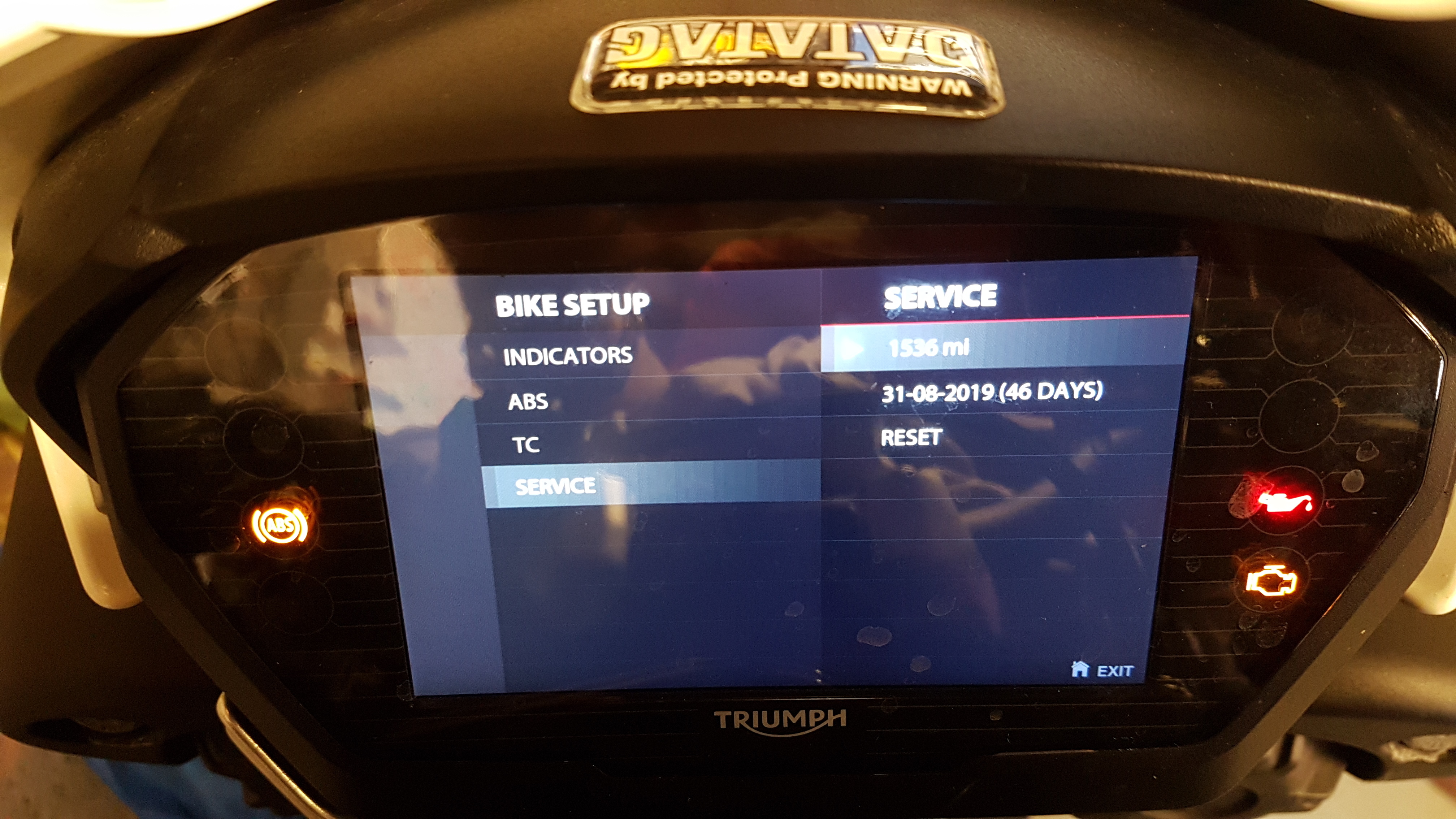

    You can reset the service indicator in the TFT menus on the 765's.
    No tools or software required.
  5. Eldon
    Eldon Elite Member
    7,183
    #5 Eldon, Jul 17, 2019
    Here you go OPP for future info
    Just for info.
    I switched the ignition on to take this picture (inside the garage) but then got side tracked by my youngest riding his trials bike. I came back some time later, maybe 20 - 30 minutes and the headlights were bright but just as I got to it the dash died :confused:. So low voltage seems to effect the dash first.
    I placed it back on the Optimate and an hour or so later it was all back to normal. :p
