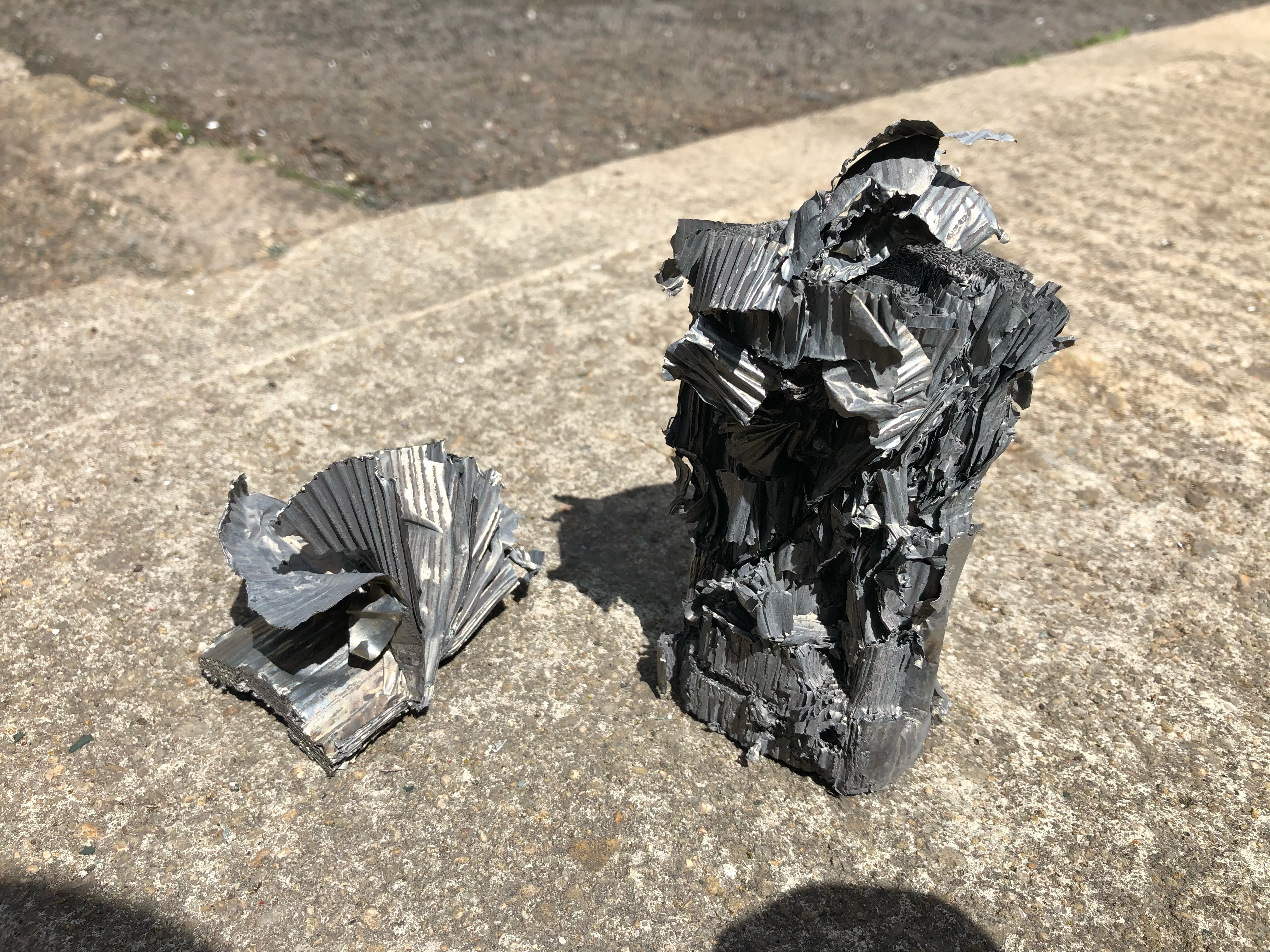

    HillTop came back to me & tbh it’s looking like I’m heading there. Part one achieved today with the cat out.

    You've made a cat-flap.
    What's next :confused: ?

    Will be welded this week & seals ordered for header then I shall plan in the hilltop appointment.

    Also no need for concern this is not my original set of headers so can always switch back

    Only that it kind of looks drastic - you're clearly braver than me!
    Although, now that I know this is a second set and you still have the original headers...I think I'd try something like this too :)
    My approach would be to cut out the cat and replace it with a piece of straight pipe though...did you consider that?
    Keep us posted - the Hilltop results will be very interesting.

    The trouble is there are mounting points for the exhaust trim that need to stay in place plus this way everything stays in alignment, it would only take a couple of degrees out when welding in the replacement section for issues meeting the rear section. Hence this route.

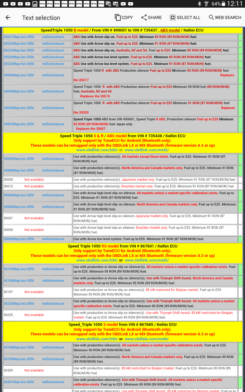

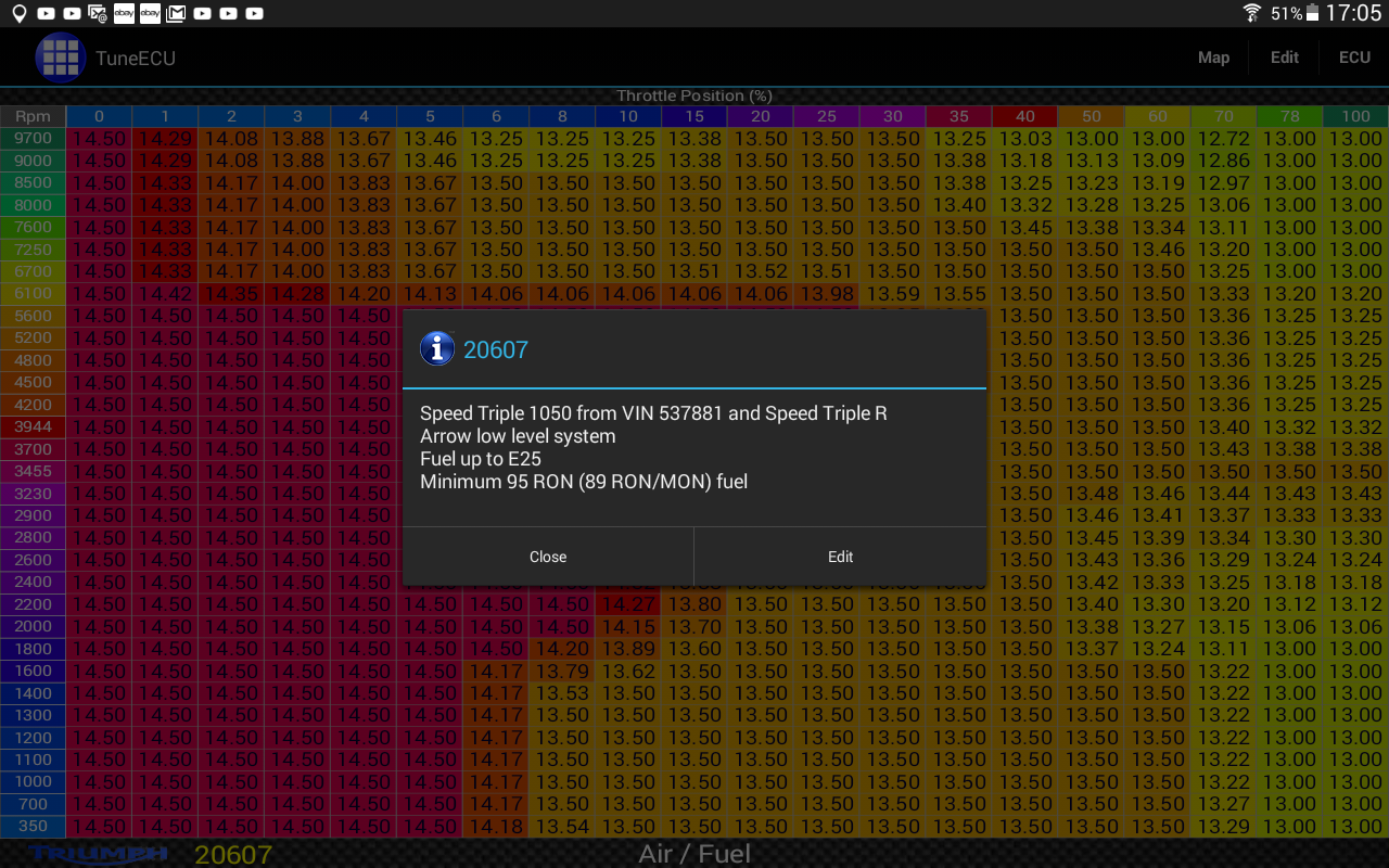

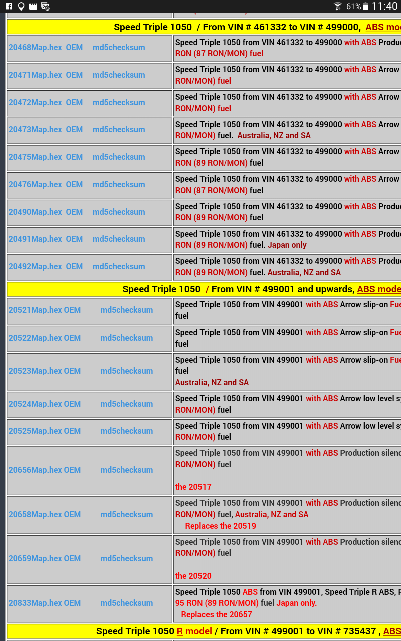

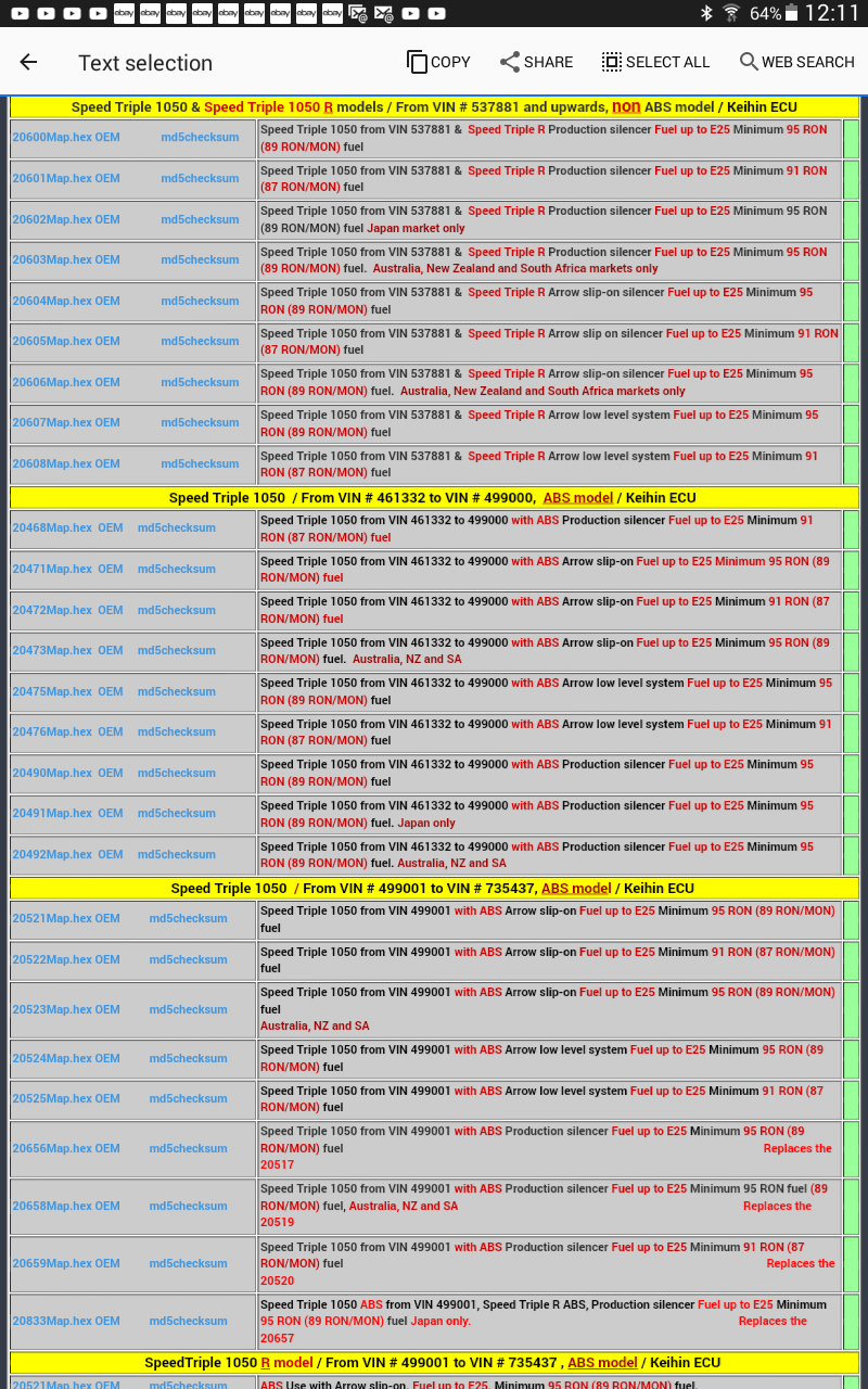

    You need the new map loaded for that exhaust minimum. This isn't your range of R and vin, but its further down on TuneECU website, I've got map 20607 on my 2012 R.

    This one.

    Be in here, search TuneECU Triumph maps and page will come up, you can get TuneECU software and adapter for under £15 and do it yourself, or pay main dealer to put it on. But think for your year of bike TuneECU can't access ECU.
