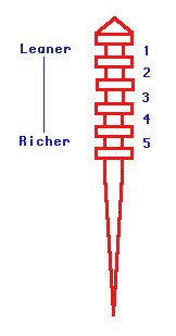

    Hi All
    Update on the pod air filters, the best mixture setting for the Mikuni carburettor after a few months changing settings.
    1. The jest size increased from 125 to 135 as described above
    2. The jet needle raised to the maximum No 5
    3. The pilot needle open by 4 turns instead of 11/2 from the factory
    These settings give you a very smooth tick over and a decent pull away torque. Once you open the throttle the bike just wants to go, very responsive. These settings won’t probably save many trees but the bike runs great. The rim of the pod filter sits away from the vacuume port so doesn’t restrict the throttle slide valve. As the pilot needle is situated on the engine side of the carburettor, this controls the amount of fuel entering the inlet and not air, hence opening increases the fuel mixture.

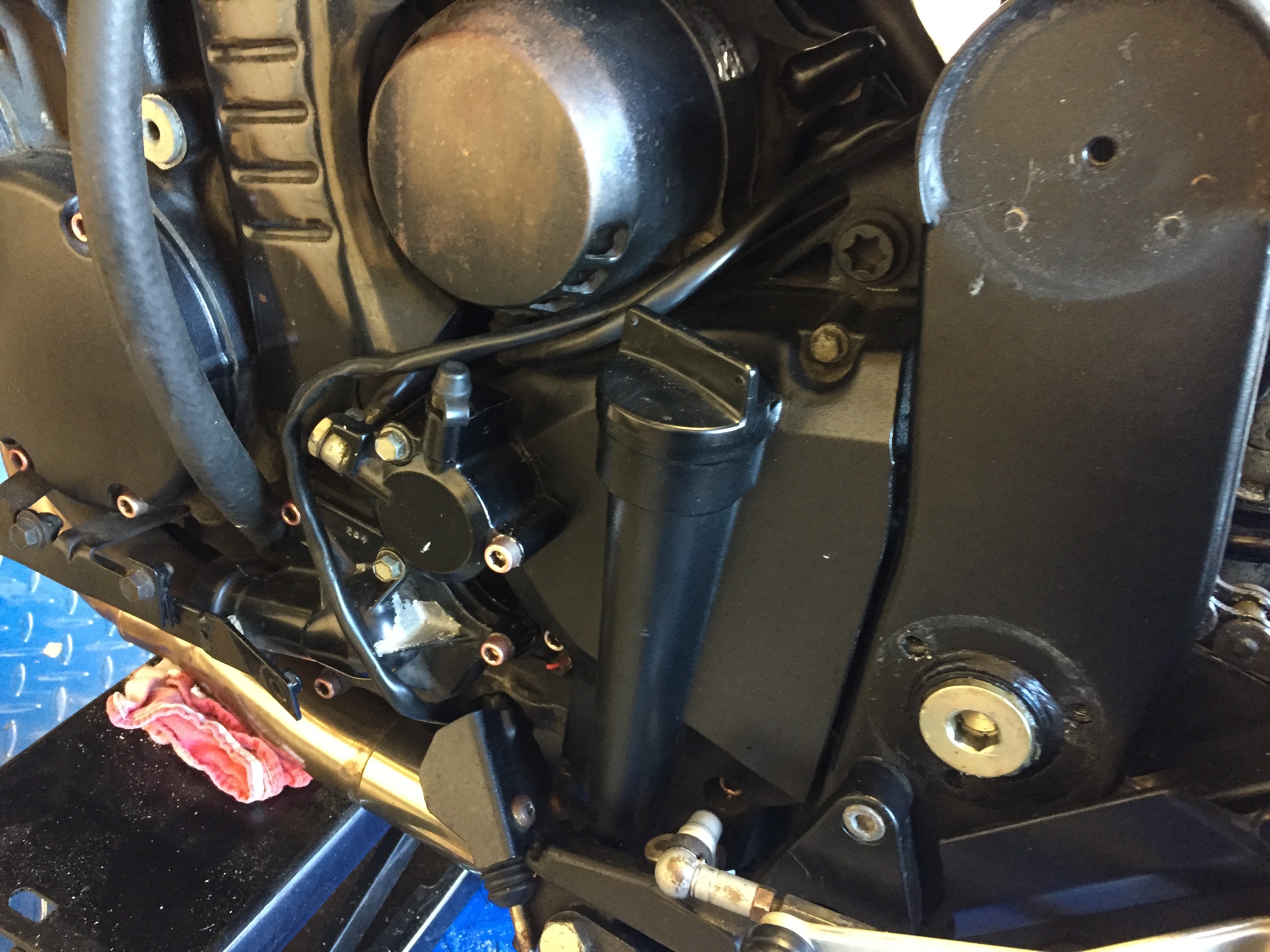

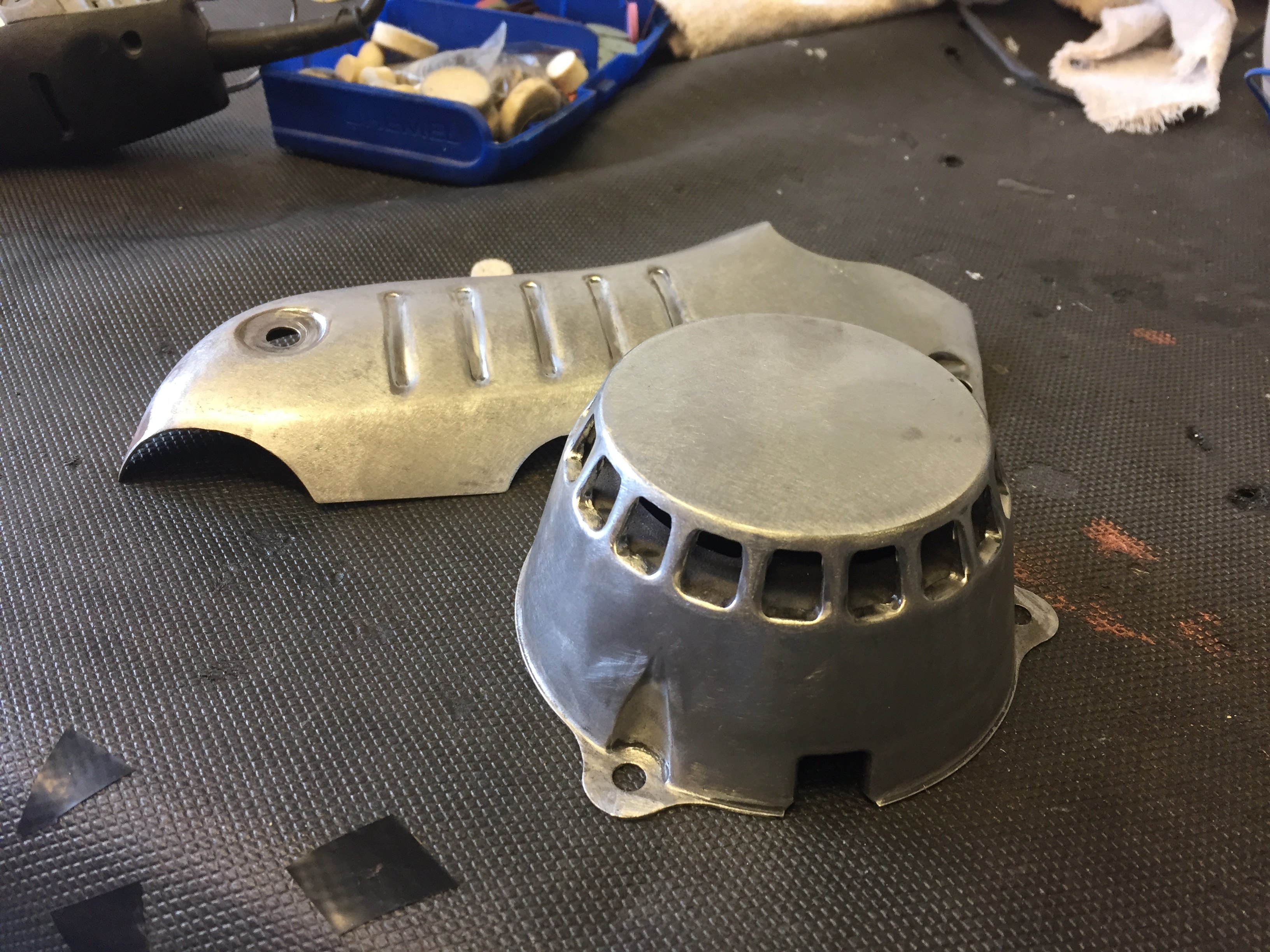

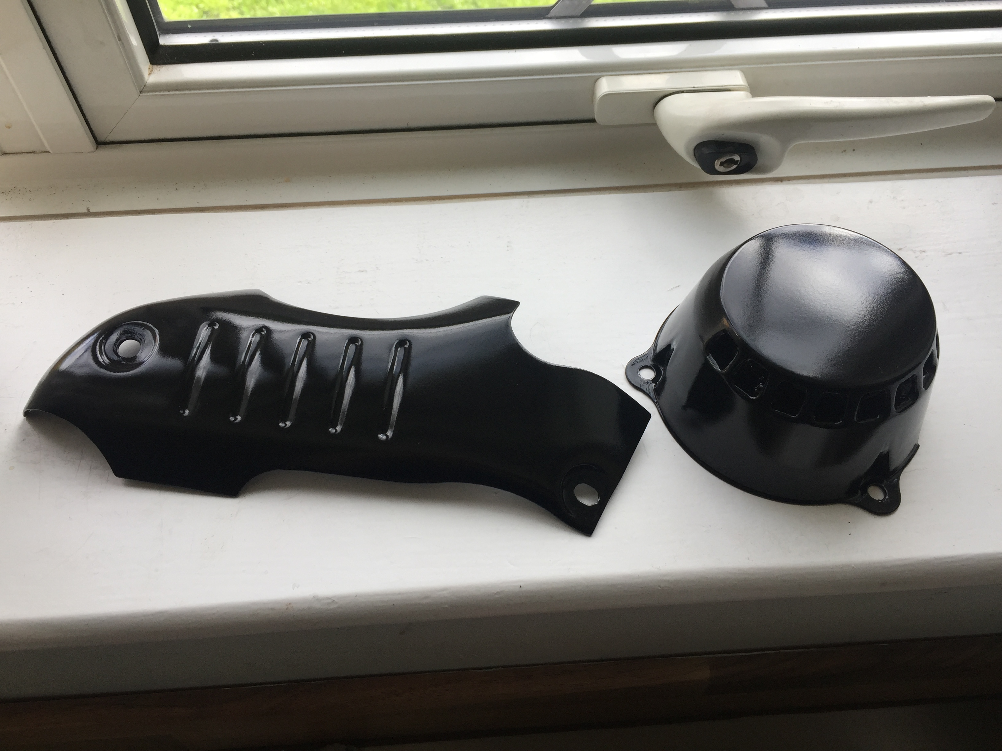

    The cooling system guard, and generator casing looked a bit tired and scratched
    Sanded down to the metal
    Three coats of primer
    Three coats of satin black
    Three coats of petrol resistant lacquer
    Will bolt on once the paint is dry after a week, also Matt it off a bit to blend in with the rest of the painwork

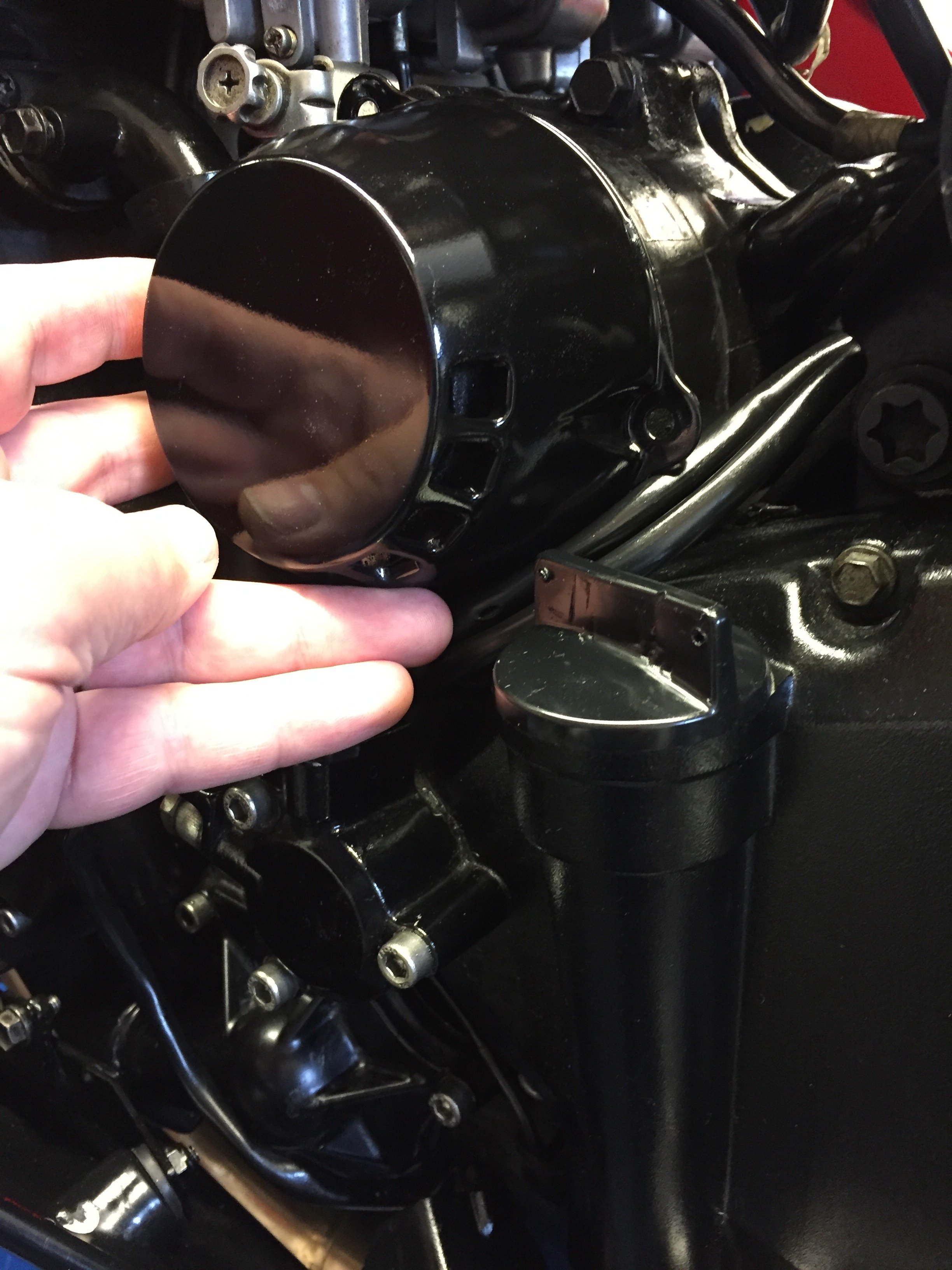

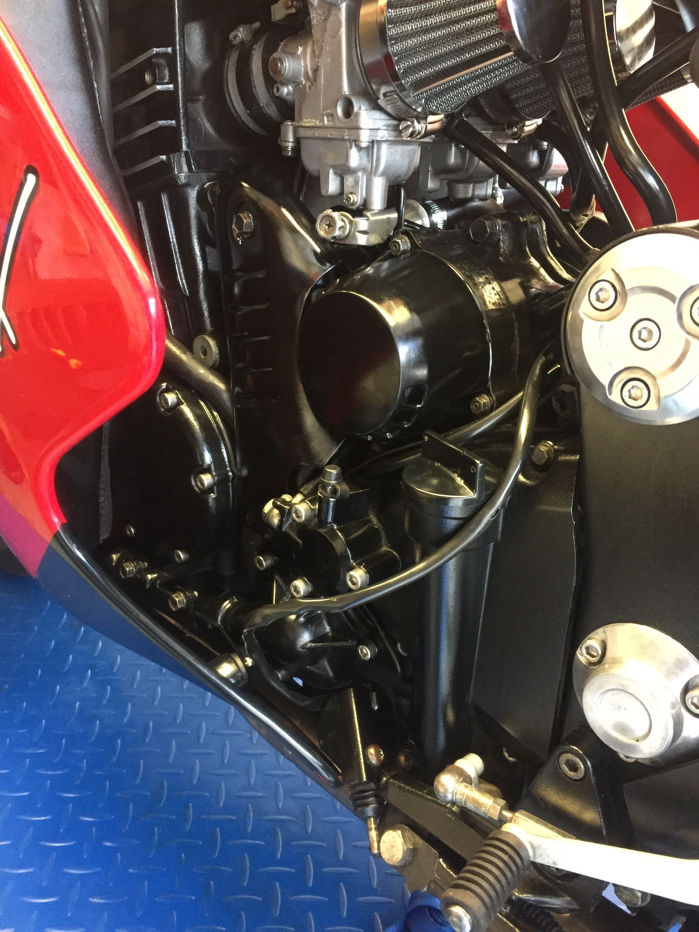

    Both mounted on
  11. dilligaf
    Very nice work mate....looking good :cool:
  12. Havit
    9,682
    I had mine powder coated as well as the chain guard and the swinging arm covers ect.
  13. Chris Timmins
    Chris Timmins Active Member
    Jun 7, 2017
    119
    Birmingham UK
    Cheers, powder coating is probably the way to go, hopefully it will stay on. The lacquer is supposed to be petrol resistant, we’ll see how resistant it is :)

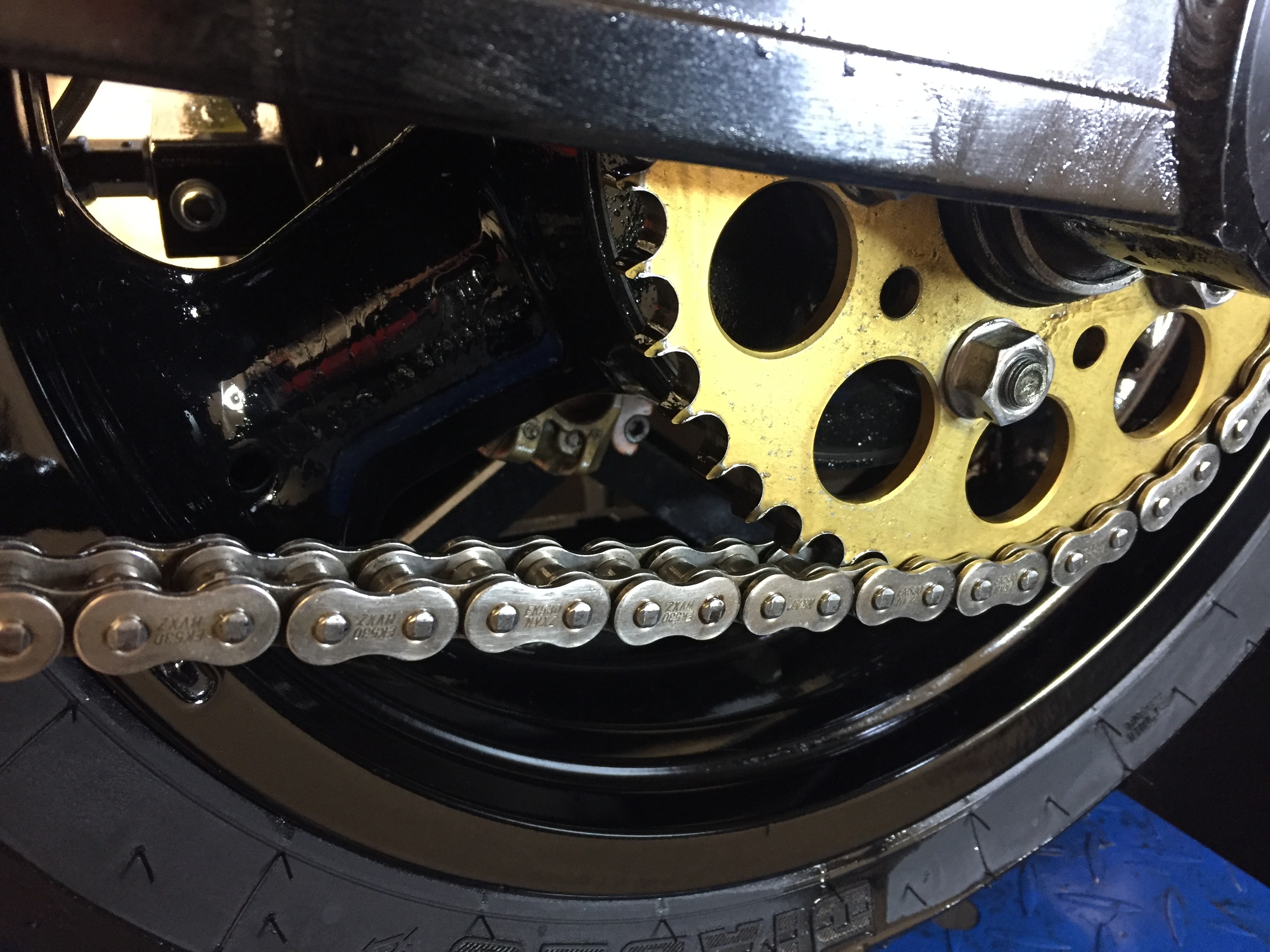

  14. Chris Timmins
    Jun 7, 2017
    119
    Birmingham UK

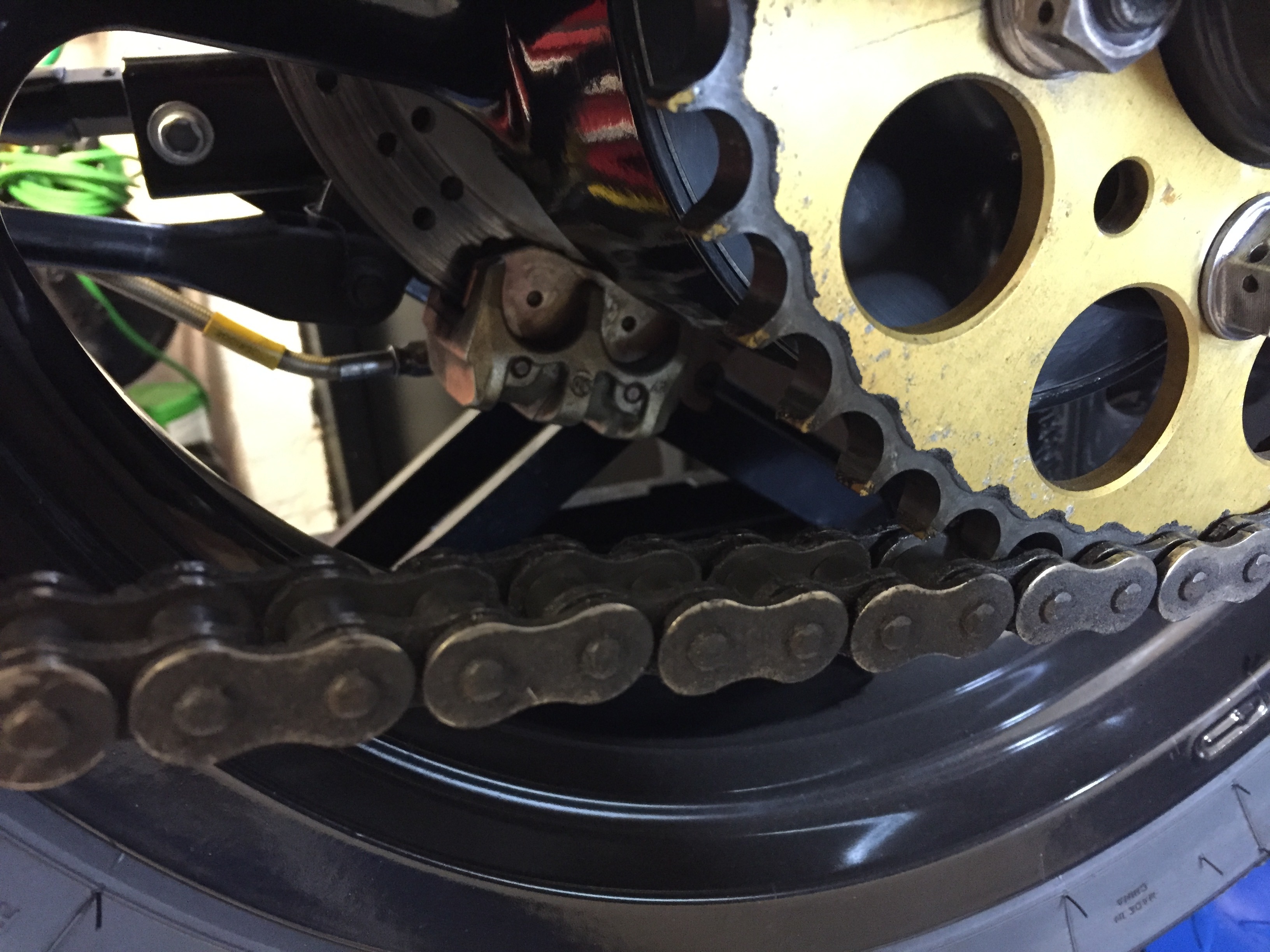

    The chain also needed a good clean, i’ve always used cans before many seem to use paraffin. Makes sense as it’s kinder to rubber leaving the O rings alone. Purchased a 4 Litre container from Homebase and a spray bottle for £7.
    And it worked a treat, with loads left and emergency heating:)
    Finished with chain wax
