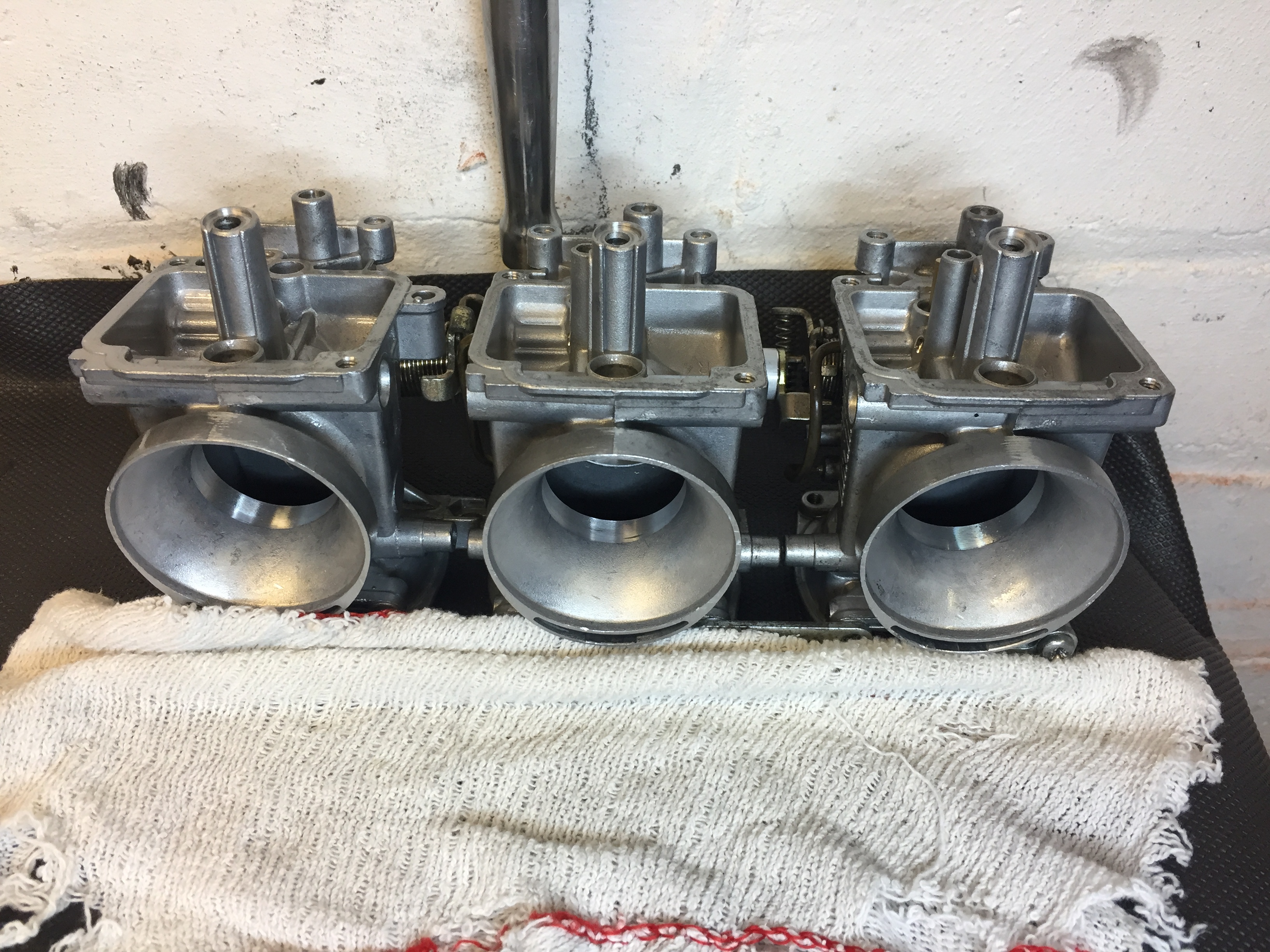

    Just carried out some more work on the Daytona 900, stripping, cleaning and re-jetting the main jet. I mentioned on the previous post that I thought the bike felt a bit flat and had more to give, and this work did the job.
    Removed the carbs and stripped out all the jets, much easier without the air box

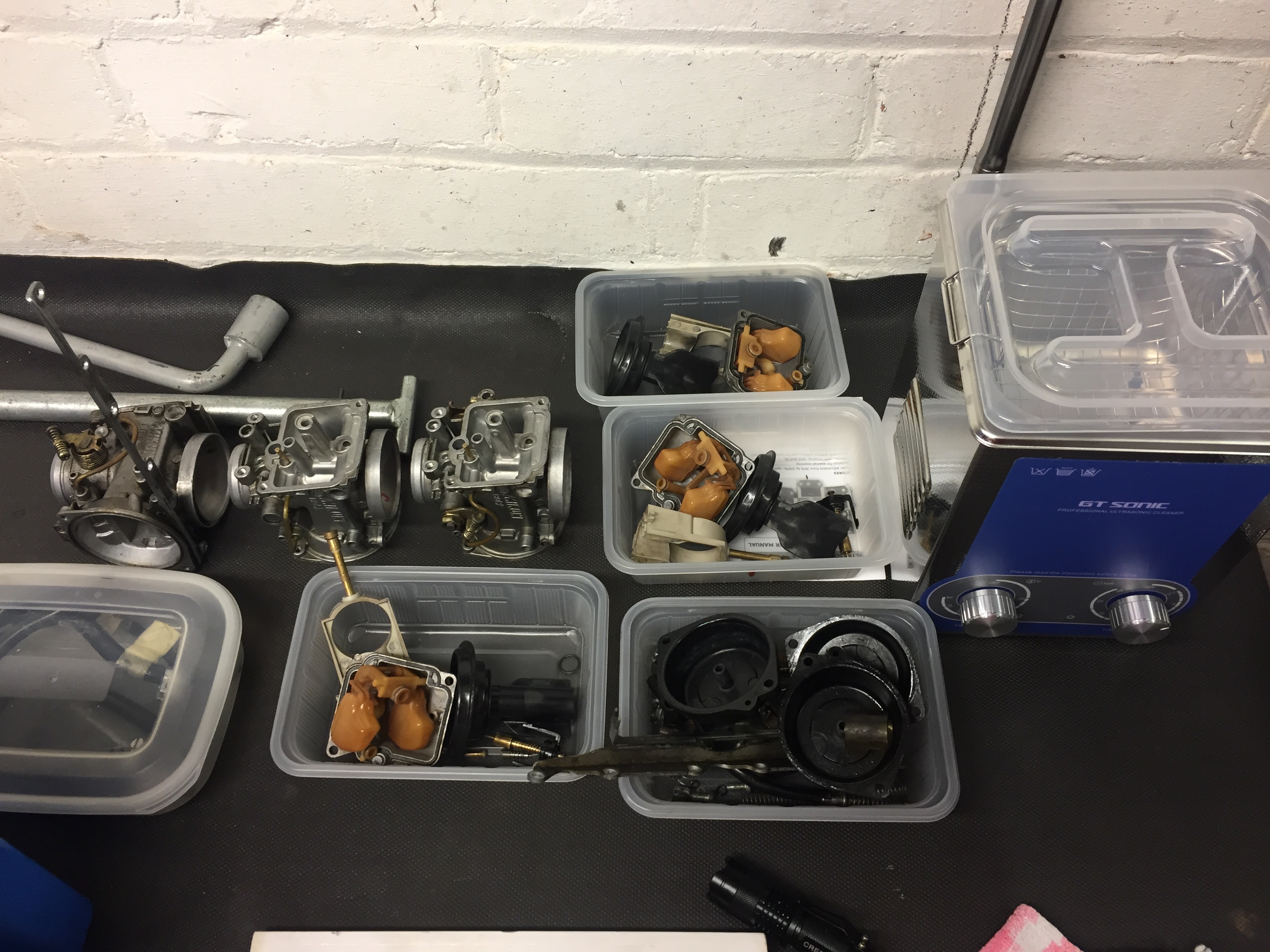

    I also split the three carbs so I could carry out some ultrasonic cleaning, these baths are great price on Amazon
    All the carbs dismantled and trayed

    used this stuff to clean the carbs, see what you think !!

    Big problem on these are blocked pilot jets.

    All three carbs cleaned

    The original jet sizes were 125, the new jet sizes increased to 135 which came with the air filters, new seals and O rings

    Putting the carbs back together was prity straight forward once you get around how small some of the jets and needle are

    Fantastic - 2 days work for a complete strip clean and service. I'm not a mechanic and learning on the way, makes sense why these Mikuni carbs are so highly rated. Restored all the jet setting float hights back to factory settings except the main jet and the bike feels 100% better a lot more responsive. The midrange jets looked blocked when I took them out, makes sense why all the jets need to be set up correctly to ensure correct fuel delivery see below
    Will re-balance the carbs post re-build and get back to you, but the improvement already is estonishing
