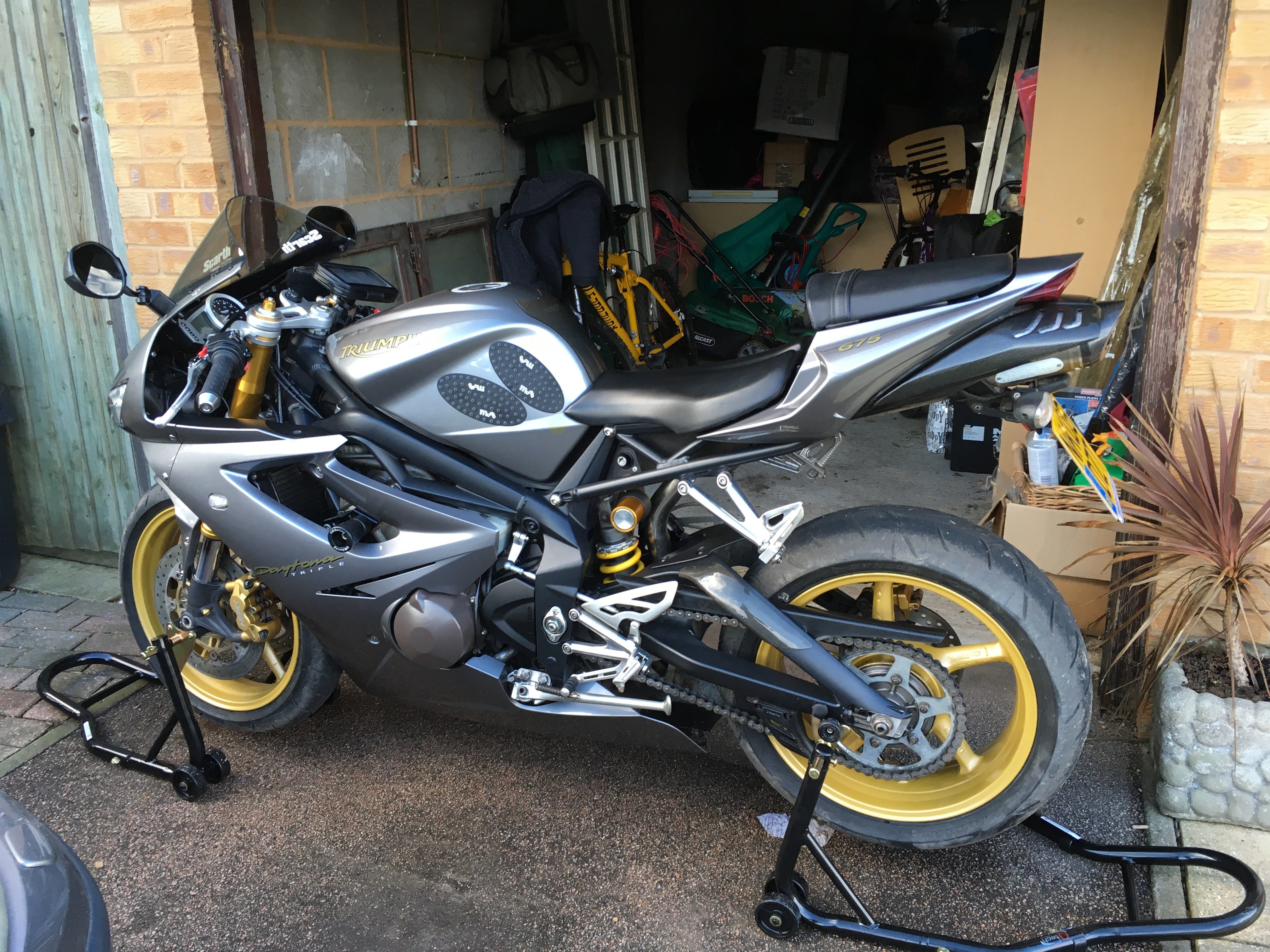

    I know...you used diesel didn't you:scream:
  2. keith tookey
    keith tookey Well-Known Member
    Jan 24, 2018
    Brighton
    Yea I tried in both second and third just can’t do it hopefully the recovery won’t be much longer

    hmm, could be rectifier or stator, but then there would still be a clicking as the solenoid tries to fire the engine...
    a multimeter would show the voltage in the battery...needs to be near 13v to start
    my bet is still on a solenoid

  7. Rich Bryce
    2,993
    Could very well be the battery hasn't fully charged. That's the first thing the dealer will look at for you.
    Fingers crossed it's a simple solution.

    So a quick update recovery turned up jump started straight away no issues but when he done his test on the battery while the bike was running no charge was getting to the battery his recommendation was the rectifier????
  11. Red Thunder
    Red Thunder Crème de la Crème
    Dec 2, 2014
    2,037
    High Wycombe
    could be...
    Rectifier or the stator is blown - either way it is an expensive piece of kit
  12. Red Thunder
    Dec 2, 2014
    2,037
    High Wycombe
    this could be a fault which develops gradually, if the battery was fully charged when you got it a couple of months ago, this could hide the fault until the charge depleted from the battery.
    You get a new battery (which is not fully charged) and this has enough juice to see you through 40m of riding but is then exhausted and also can't start the bike.
    What I am saying is the fault could be hidden by a fully charged battery, I hope your dealer is compassionate and will cover the cost for the part and labour....it would be difficult to prove this fault existed before you bought it....however, if it is indeed still within warranty that covers electrical faults you stand a chance

    I will keep u all informed but don’t know what I’m gunna do if it’s £100s may try and fix it myself

    agreed, if the stator is buggered, then the rectifier can't cope and usually gets buggered soon after

  17. Kom Larsen
    Kom Larsen New Member
    Oct 22, 2016
    2
    DK
    Hi Keith
    I am Danish but Will try my Best.
    Had the same experience.
    Turned out to be the switch for the side stand, positioned right next to the side stand fixing point. It was stuck in a position so the bike thought the side stand was down.
    Cleaning and a bit og grease solved the problem.
    Br
    Kim Larsen

    So just a quick update just heard from the dealer and it turned out the fault is the alternator stator
    Thanks for all your advice
  19. keith tookey
    Jan 24, 2018
    Brighton
    Woo hoo she’s back all fresh and fired up well done destination triumph in Washington
