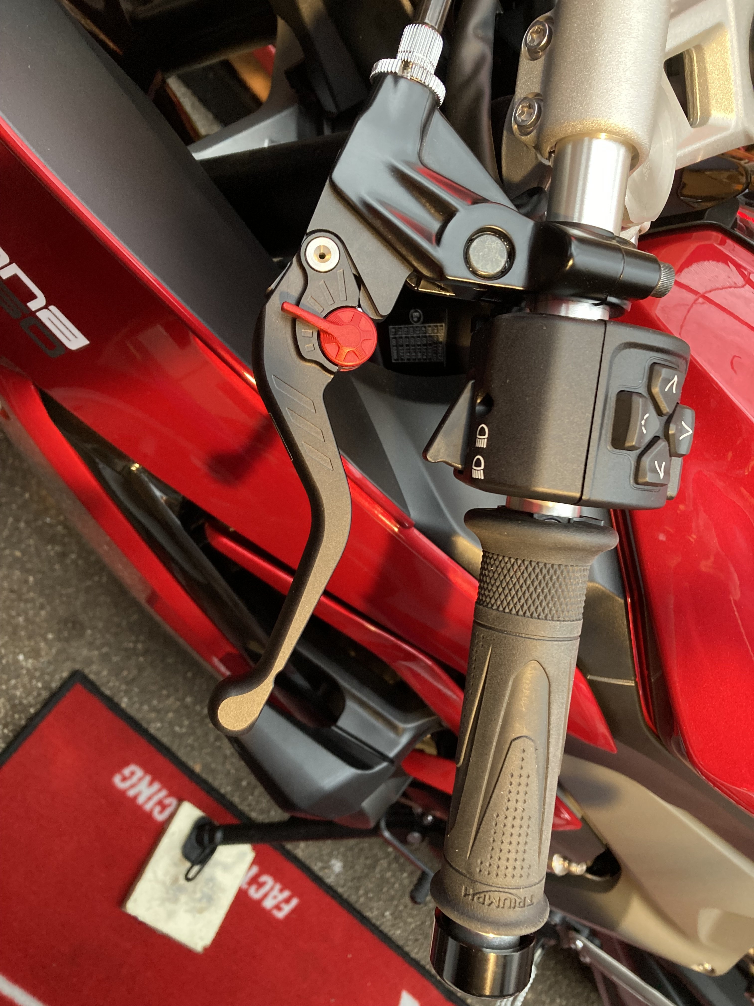

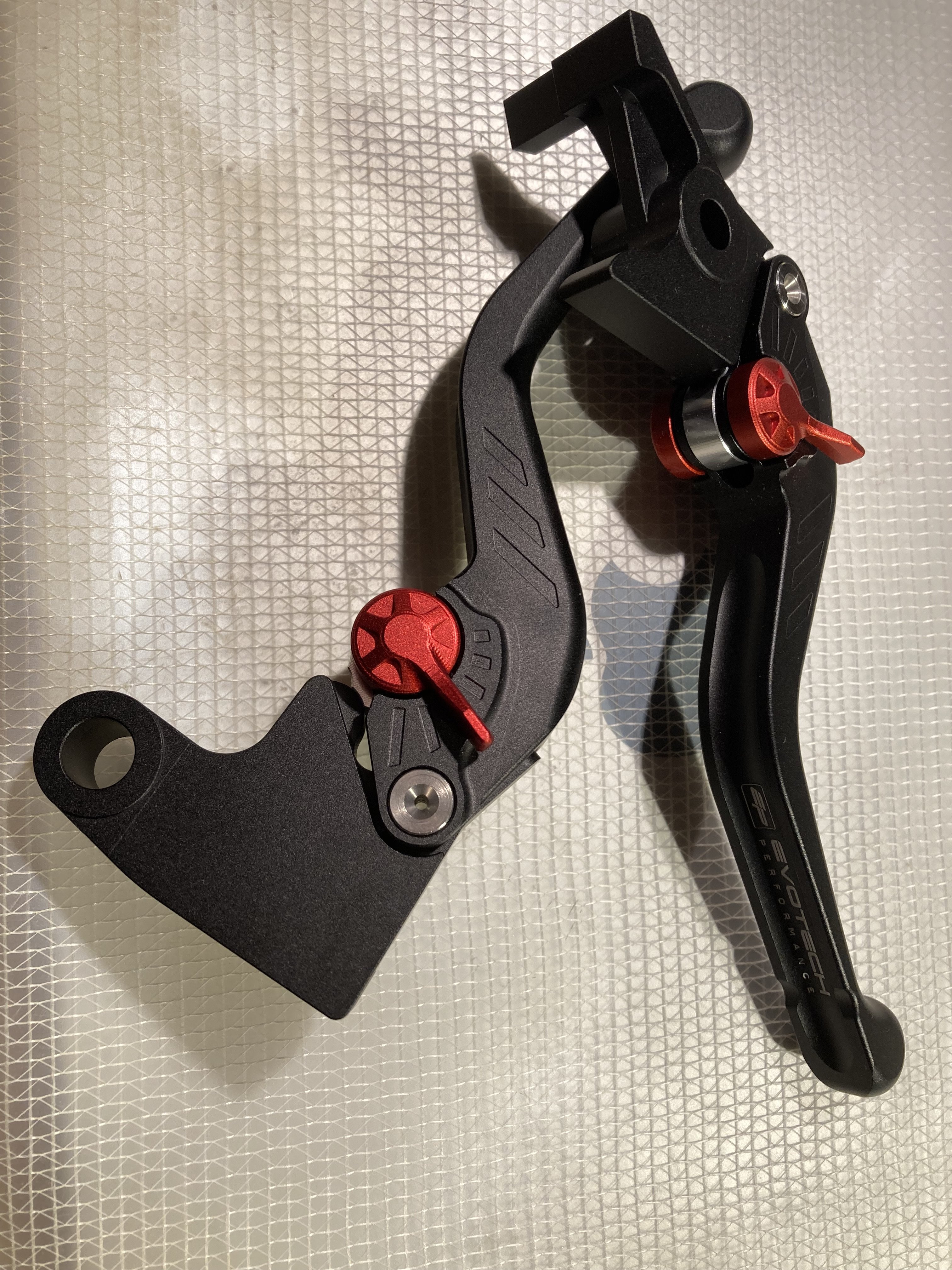

    These arrived yesterday. I'd like to say they were a late Xmas present but they weren't. There was a bit of a discount and I couldn't resist.
    I'll fit them in the next day or three and post a snap.

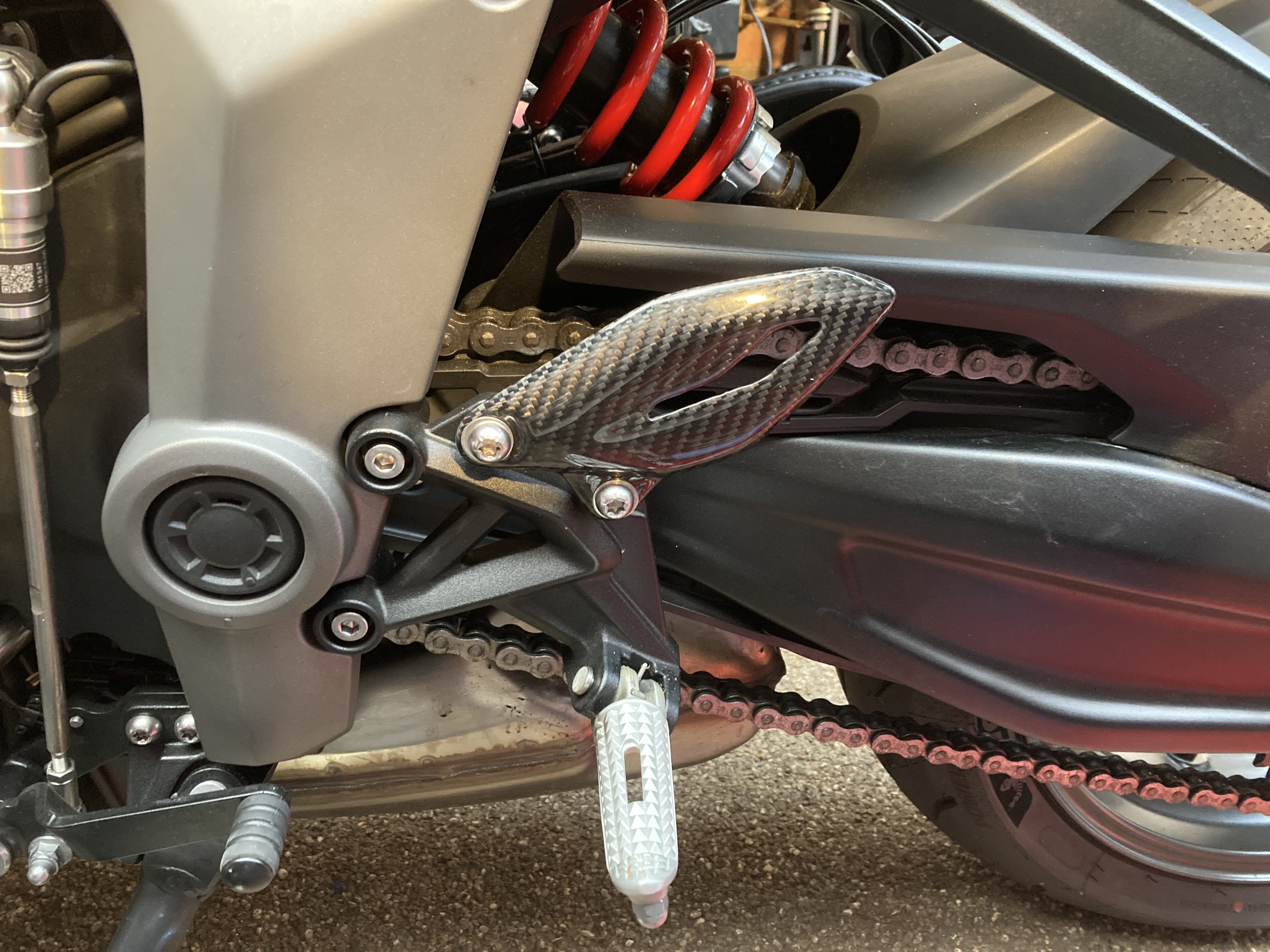

  2. beerkat
    beerkat First Class Member
    Aug 14, 2019
    1,080
    Cheshire UK

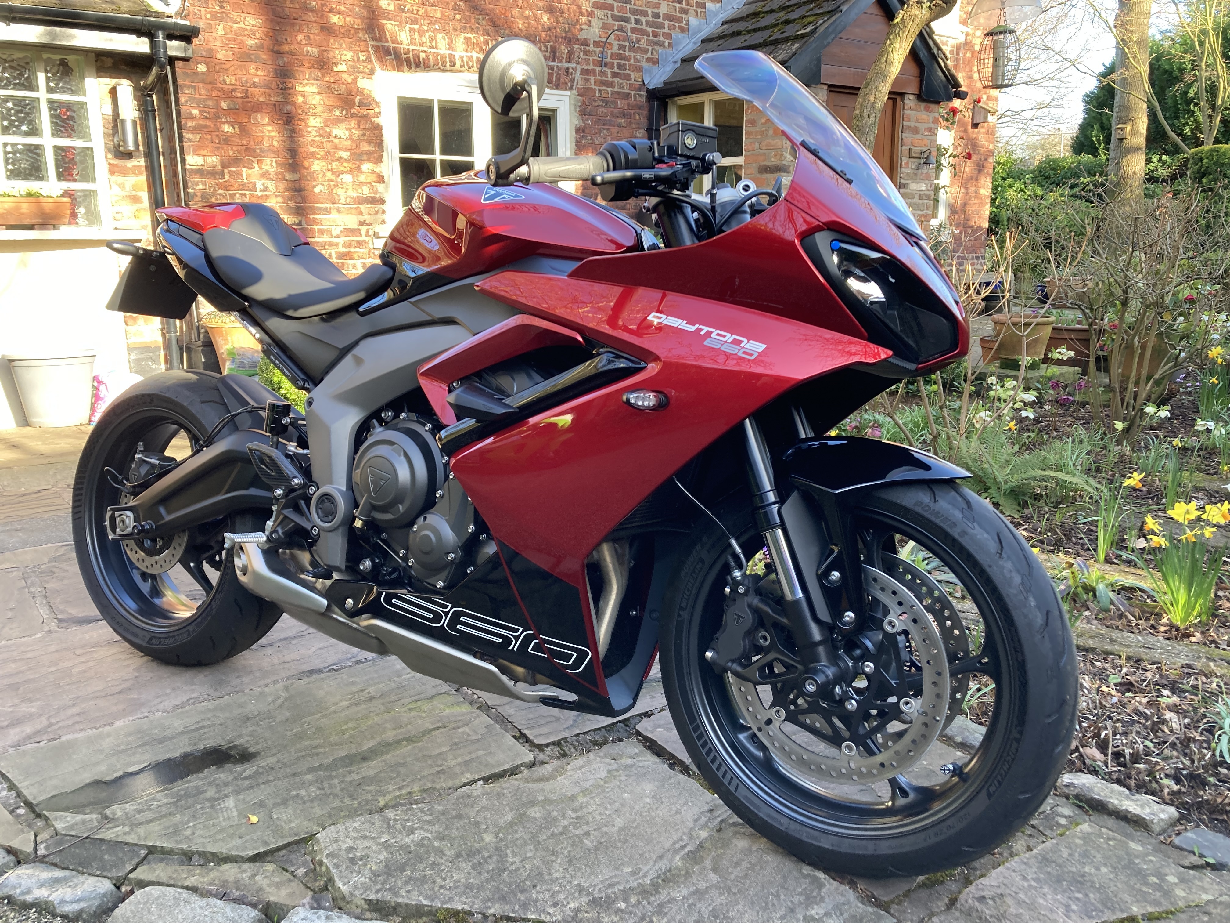

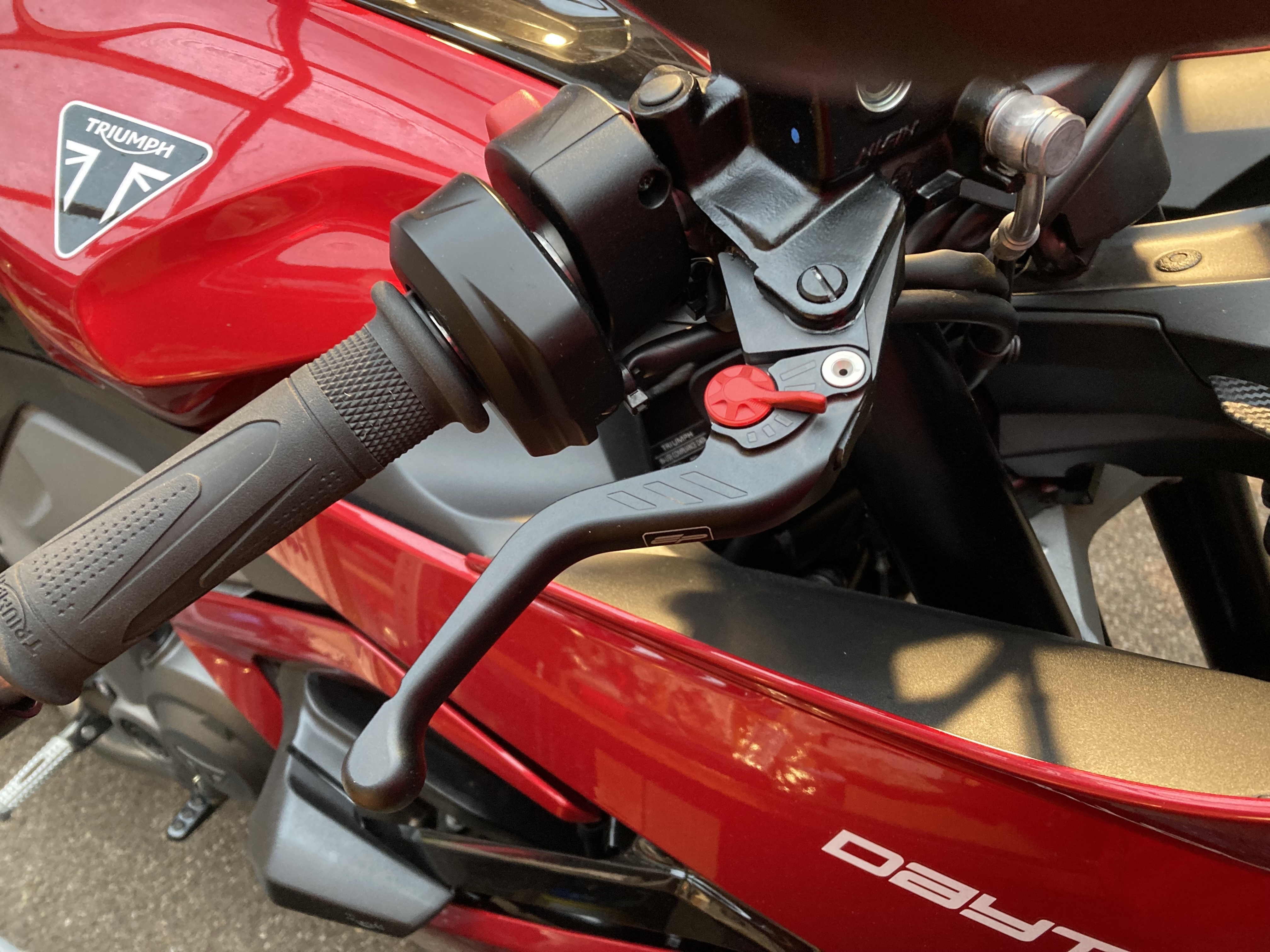

    All done.
    Just need to get the bike on the road to check clutch adjustment.

  4. beerkat
    Aug 14, 2019
    1,080
    Cheshire UK

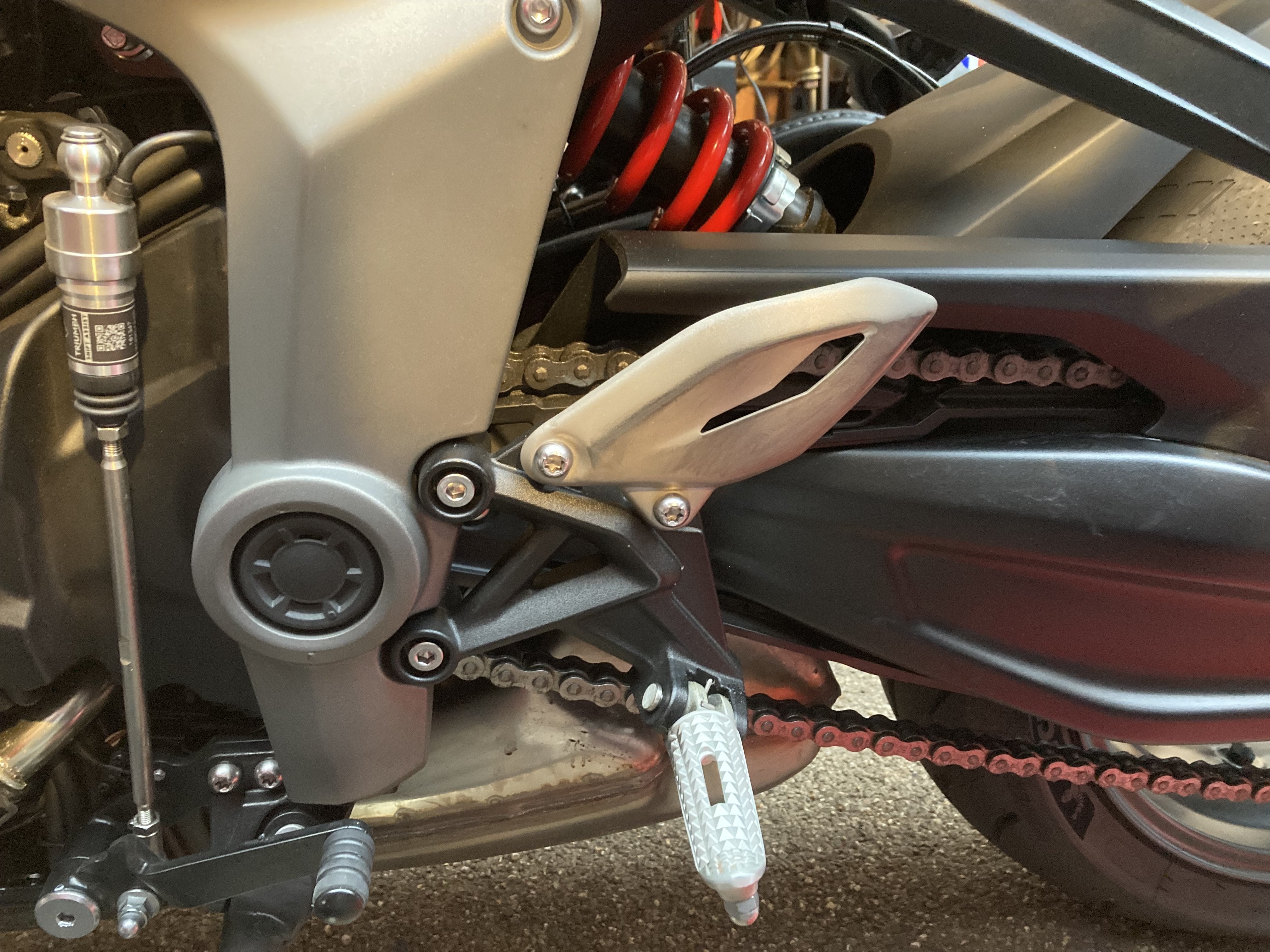

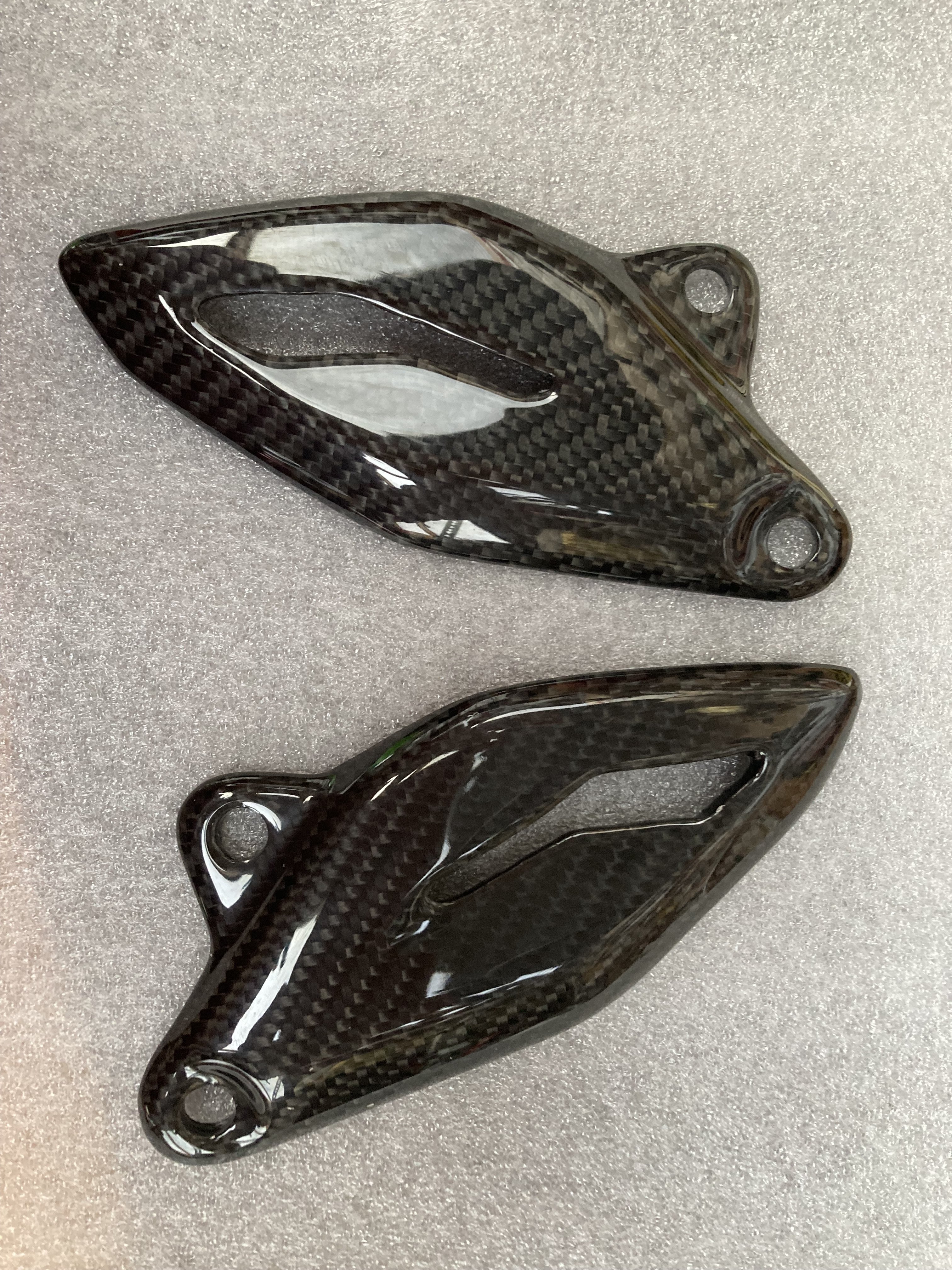

    What do you do when you've got a bit of spare time and the weather isn't conducive to wheeling the bike out of the garage?
    You browse the internet and get sucked in to buying stuff of course!
    These turned up today (proper carbon)..
    Before..
    After..

    Yes Fatal but nice. One question i have i see your chain sits loose like mine and i wondered what is the free play on the chain.

    I'll check it if I remember next time I go in the garage but the bike hasn't been used much since it's last service, so that's pretty much how my Triumph dealer (Youles) set it. I certainly haven't touched it since they did.

    @beerkat Thanks and yes similar to Bulldog and my 660. I used to think it was around a inch but i am an old fogey and know little about newer bikes.

    I think Triumph say chain movement should be 43-55mm on your bike Joe. That's way more than an inch. If you aim for 2" that would be more like it. One inch is going to be too tight.
    I learned the hard way about over tightening a bike chain. It snapped on my GPz750, two-up with luggage, on a dual carriageway at around 60mph. The chain went through the crankcase but fortunately the bike stayed upright. We missed the ferry to Spain though.
    So I've always been wary of over tightening the chain. An inch isn't enough.

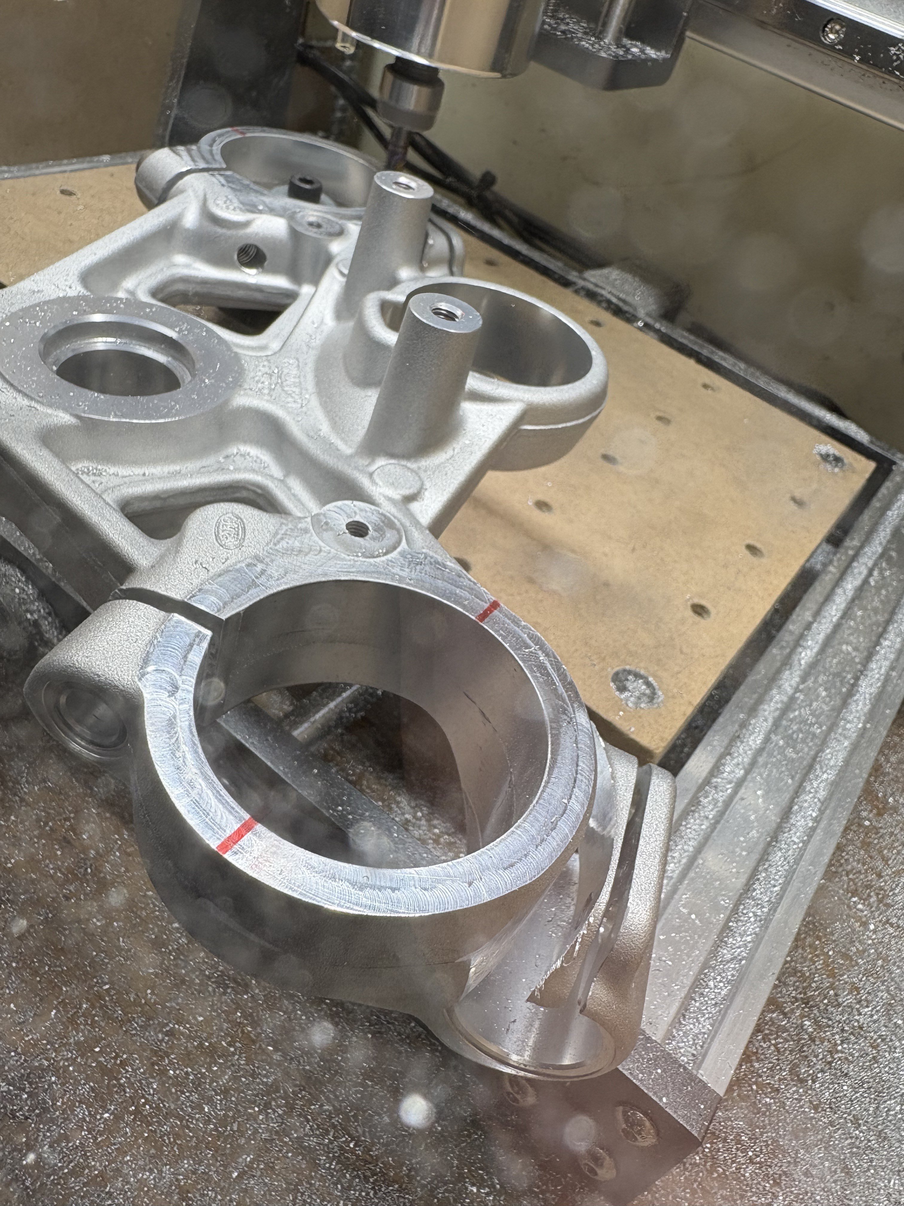

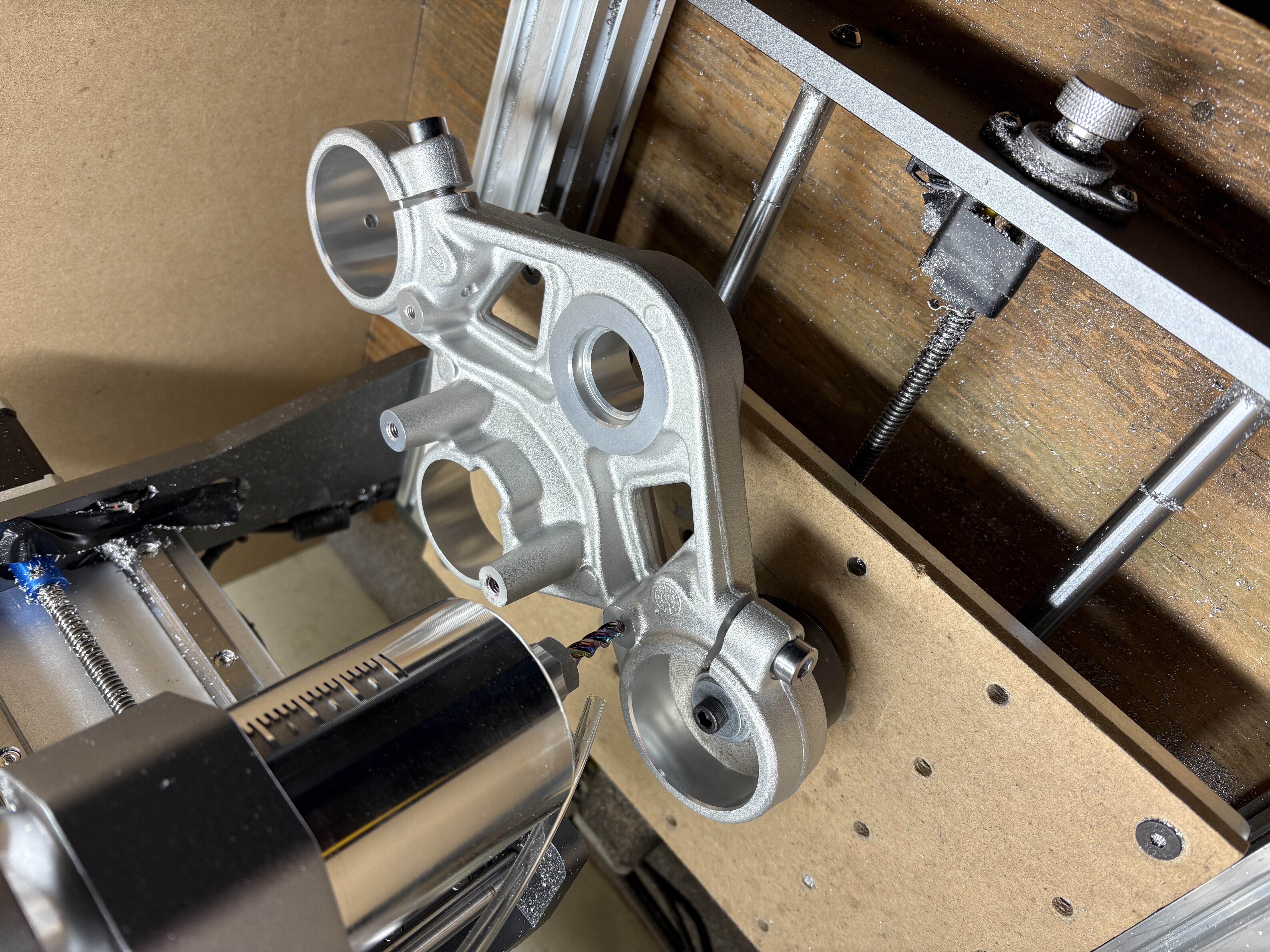

    Nice to see a thread on the 660, I'll try add interesting thoughts as I go through my race / track build.
    So far I think we can all acknowledge the bike was built to a budget, and that's fair enough, and honestly one of the major reasons I bought one, it was crazy cheap here in the states, compared to other in the class.
    Having said that, I think there are ways that we can enjoy tweaking what is a blank canvass to our own likings in equally cost effective ways.
    I also advise giving any new bike a very good once over for your own peace of mind, for me, that's probably more involved than most, my bike has only 24 miles on it, and yet I have basically been poking under every surface and begun plans to replace the key elements that will make the bike comfortable for my 6'4" frame, and help provide a sharper riding experience.
    I come from an era where forums provided such amazing information, where people thought outside of the box in terms of parts availability and swapping from other models. I do find pleasure in finding parts that others might not have thought of yet. Maybe you will see some on my project :)
    If any one wants to follow along, then I document everything on my youtube channel. https://www.youtube.com/user/mikeyjaxxx
    Right now I have some 1" raised clip ons arriving, that ultimately will aim to lower the bars a touch, but also allow angle changes. To do this I will modify the stock top yoke, which I understand isn't something we can all do ourselves, I have access to a home CNC machine, as well as a large Milling machine at work. I'd love to have found a top yoke that would simply swap over, and I am still searching for something we could find that would work, but as yet, still researching that.
    I shall stop rambling for now and will be back with some photos etc as I go.

    Hi mate,
    Well I certainly miss England for the availability of parts and race supplies in general, its not as big a hobby over here strangely. And yes also the local guys in sheds who can make anything :)
    I am doing my best and the video that goes up today will document the beginnings of my modification of the top yoke.
    I am now confident I can make aftermarket bar solution work so I'm going for it!
    You may be interested in suspension work when I cross that bridge, as that may help road riding. But I appreciate you following along. Cheers
