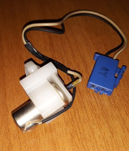

    Here's a picture of the sensor - can anyone tell if it's a float type? The tank spent quite a while propped up on its end so the sensor would have been in fresh air a while and could have jammed. upload_2019-4-17_15-25-36.png
    The wire end is downwards in normal service, I believe.
    Dave
  4. Sprinter
    6,027
    How long have you run the bike before you decided the sensor was not working?
  5. Larbertman
    Larbertman New Member
    Feb 9, 2019
    Larbert, Stirlingshire
    I’ve run several tankfuls now and it remains resolutely lit.
