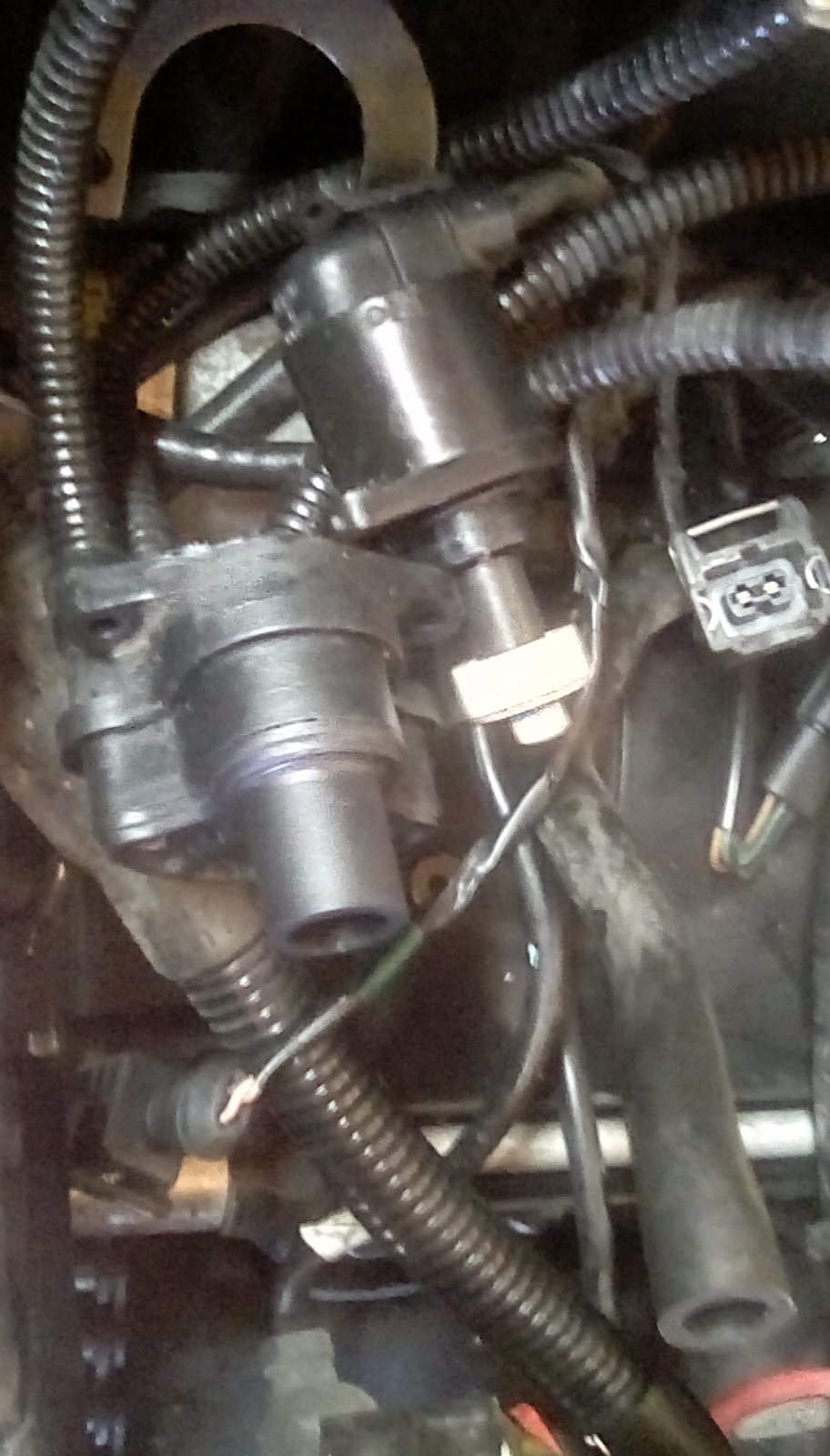

    That looks like an Idle Air Control Valve. If you’ve got it apart, what does it do when you switch on the ignition? I think it should move through a test cycle.
    If it’s not working properly your fuel mixture will be off which I presume would cause problems starting.
    Is it the Engine Management light that’s on? You need to read any fault codes it’s stored to get a better steer on what the problem might be.

    Done all this it s wanting to start but just won't pick up this solenoid was all stuck up and wasn't working what does it do ? It's connected to the air box and there are a couple of pipes missing it has had electrical problems and the alarm has been bypassed checked everything else can only be an electrical faul. It's been stood about a year.
    it was making a buzzing noise so i took it off to see what i could find it split appart and the plunger thingy was stuck in the top piece i freed it off with some WD but couldnt figure how it went back together . the plunger seems to want to screw into the solenoid bit . i have had it going thro some sort of cycle but it just spits the plunger out at the end of it! causing much searching for the spring and ferrule. the plastic in the solenoid seems to be worn as there looks to be some sort of retaining slot for the plunger

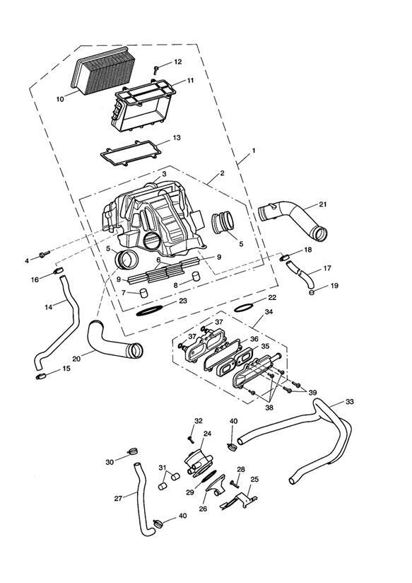

    Not sure about this model but the solenoid looks similar to the IACV on my Daytona 955.
    I’ve attached a diagram from World of Triumph parts which shows a valve at #24, and some pipes. I’m guessing this is what you’ve got?
    If it’s like mine, the plunger screws into the solenoid and the plastic housing that the solenoid fits into has ports for airflow to the intake manifold, and the solenoid is adjusted by the ECU to regulate that airflow.
