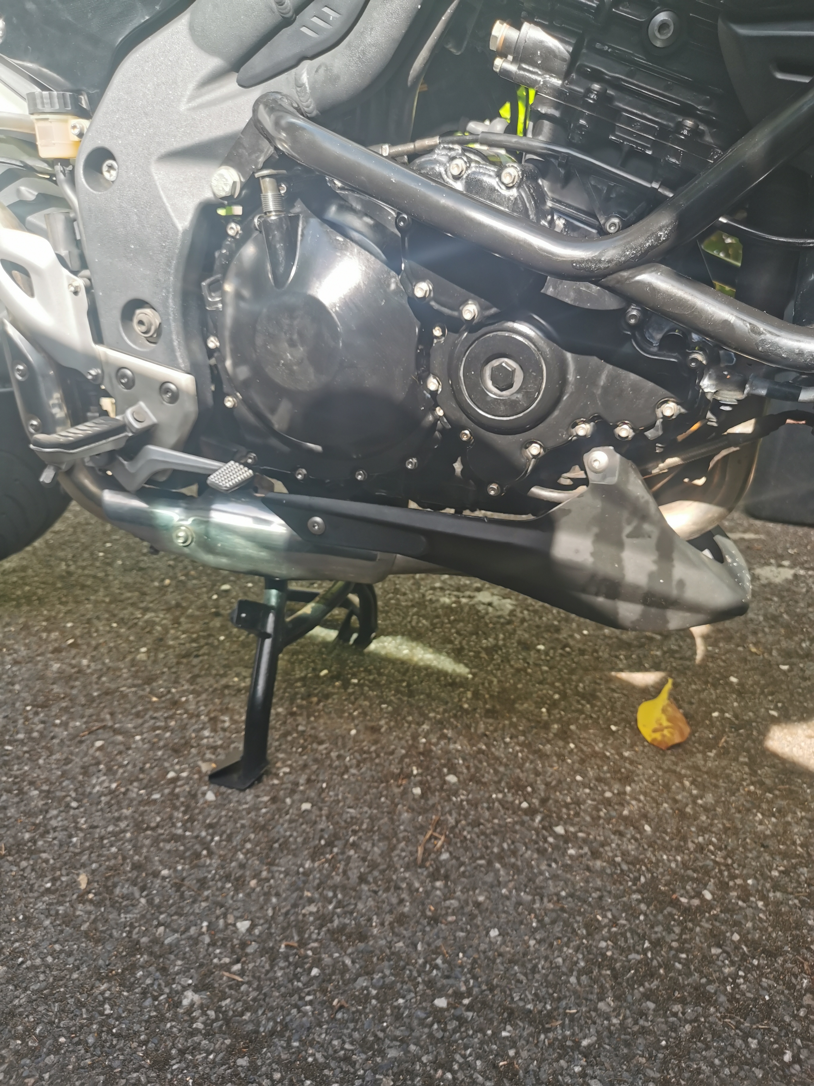

    As posted elsewhere...removing the old gasket material has been a bit of a ball ache...but all done now!
    Just need the friction plates to arrive and I'm ready to rebuild!

    All done!
    Torqued up, cable adjusted and test ridden.
    Now that's what a smooth gear change feel likes!
    Now I just have to get out and ride and try and fall in love with this bike!
