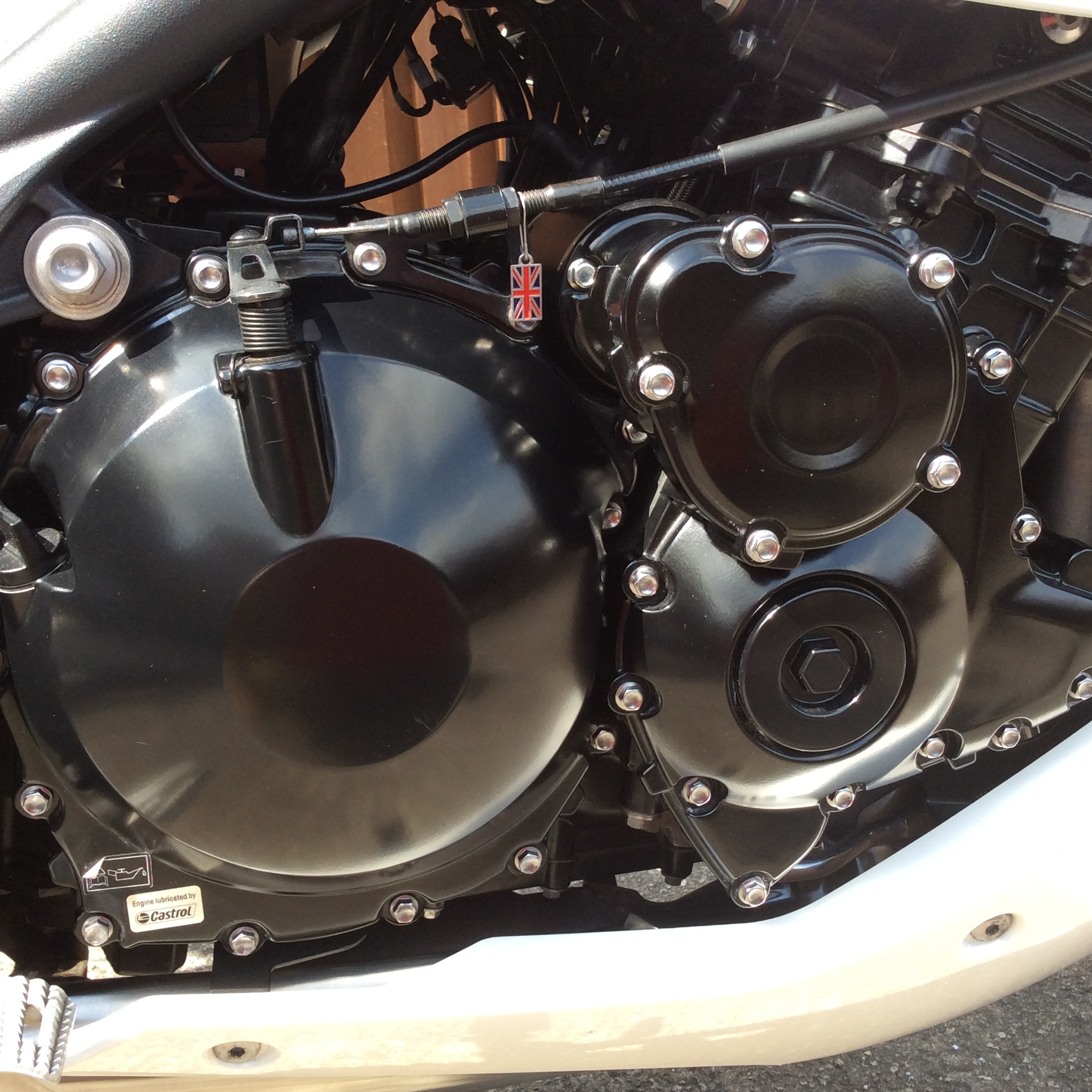

    If I remember right there’s a pry point bottom left as you look at the clutch cover, if your oil sticker is still there it’s near that. I’ll look for a picture.
  8. Yorkshireman
    3,403
    There you are, just to the left of the oil can sticker that’s peeling off.

  10. Yorkshireman
    3,403
    If you zoom in on the pic there’s another one about 4 o’clock, 4 bolts anticlockwise from the other.
