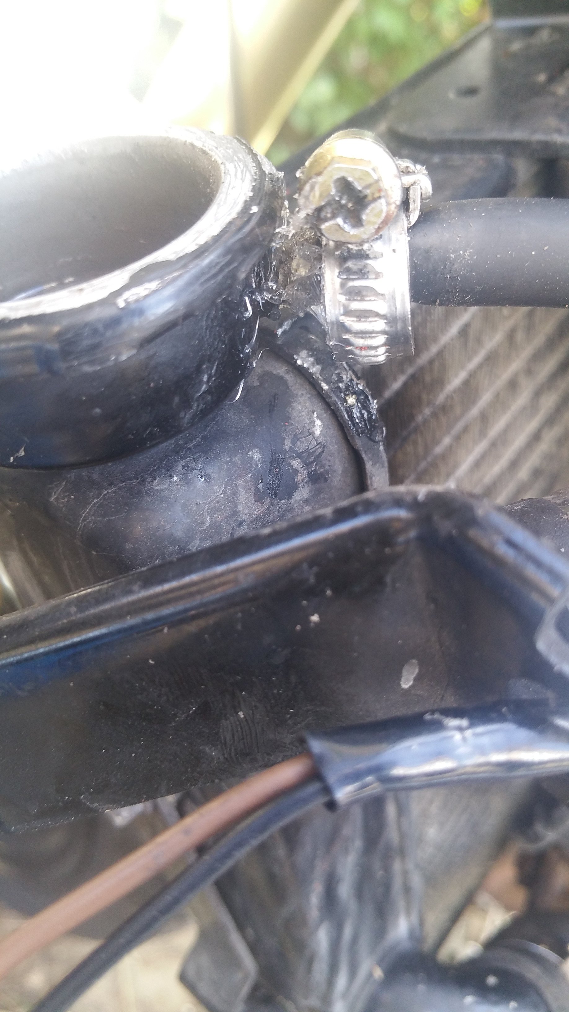

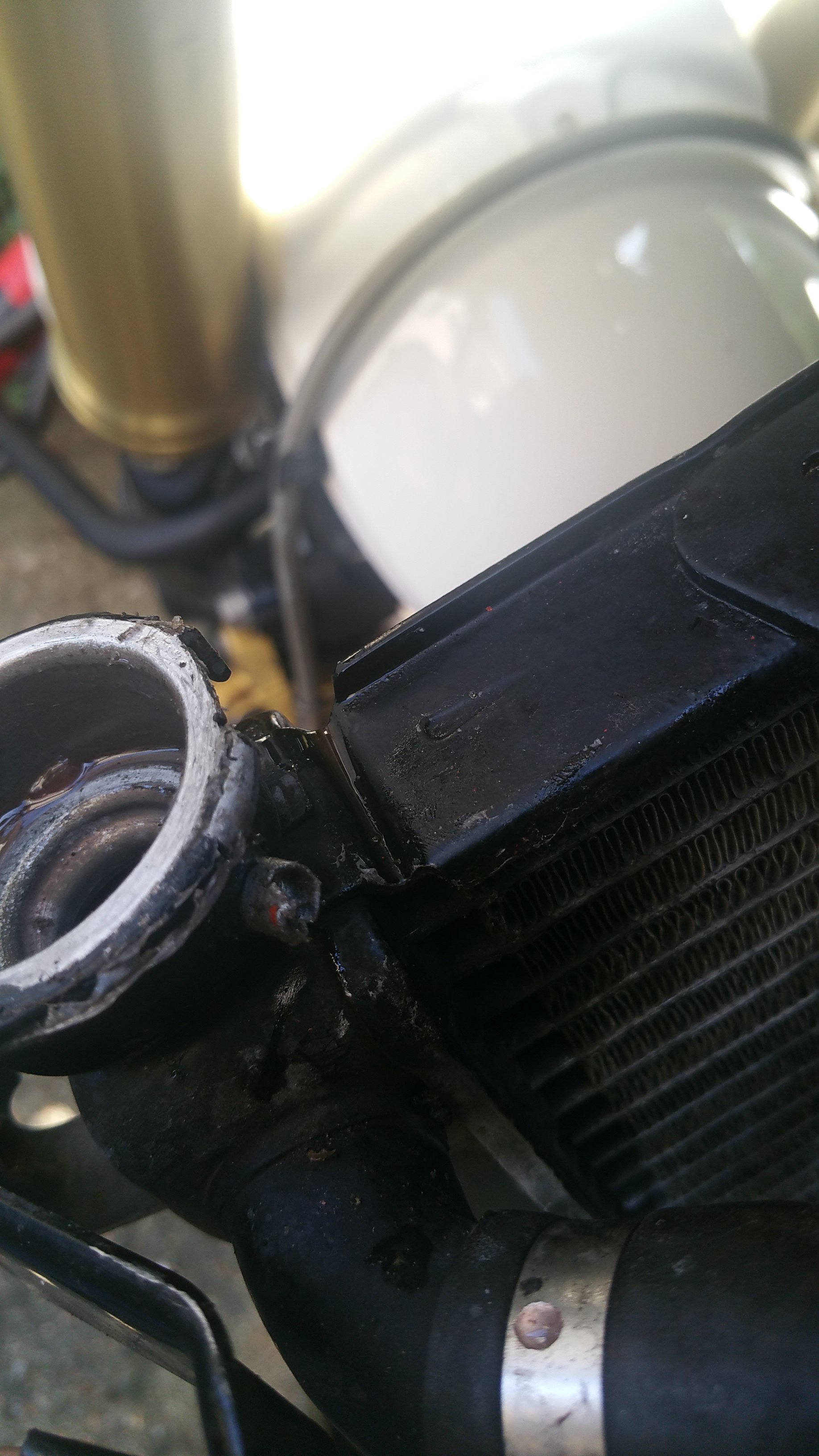

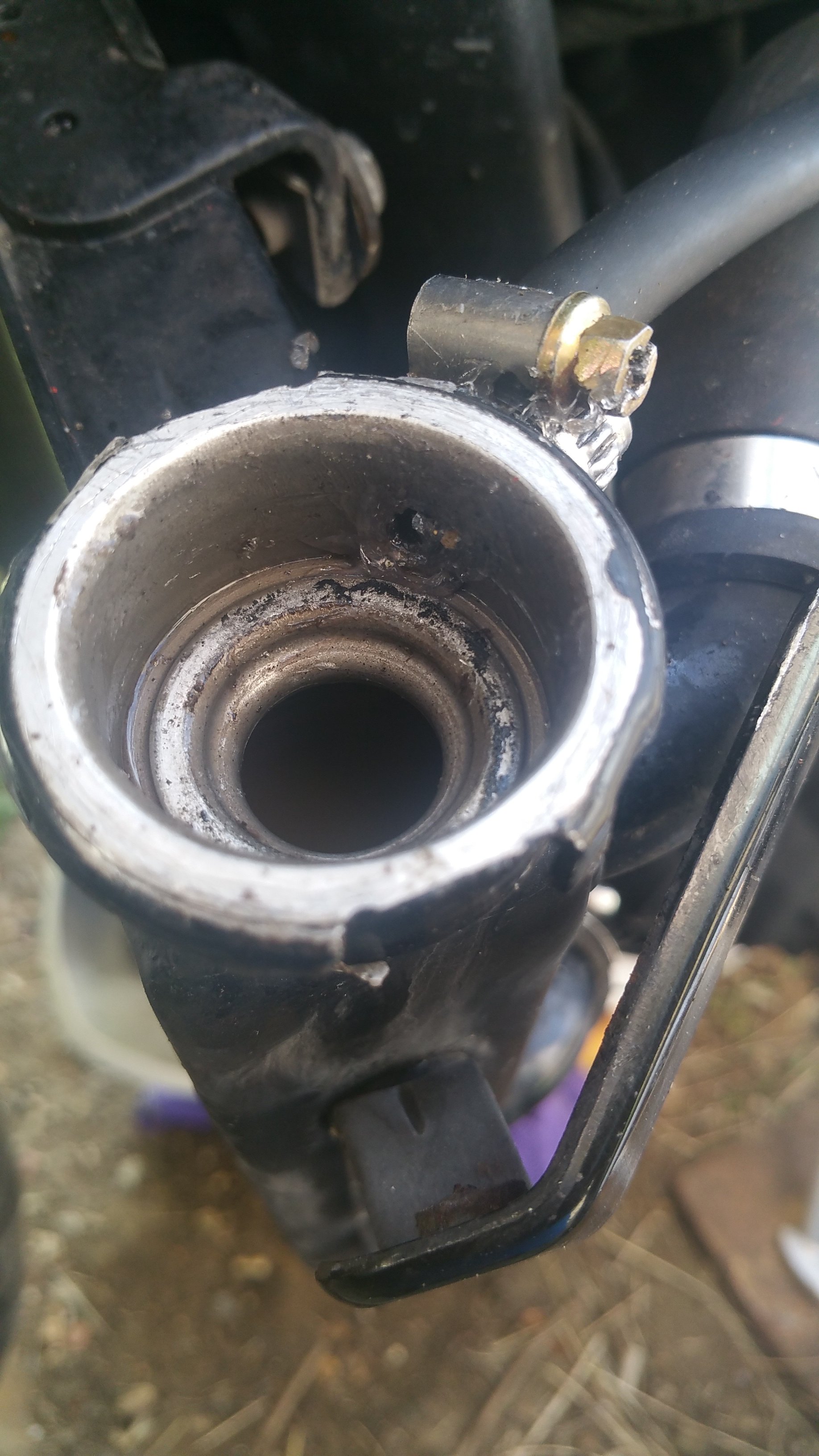

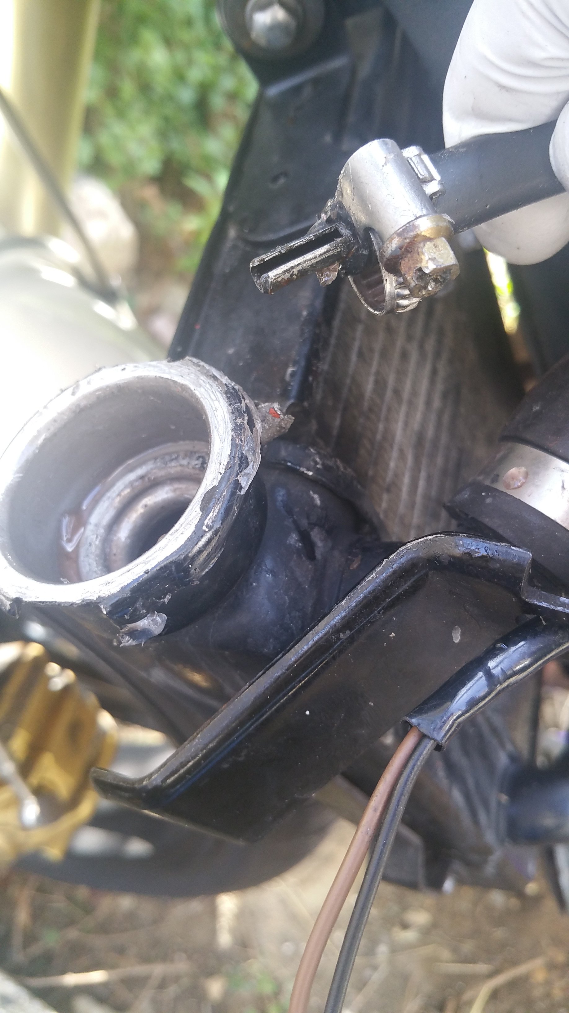

    Some images
  2. Dave_m141
    Dave_m141 New Member
    Oct 2, 2016
    essex
    What I have just tried is pushing the hose further up. Clamping it even tighter and putting some sealant around it. Going to try that until the cap arrives.

    Thanks for the photos, as they say, a picture speaks a thousand words
    Well, the pipe joint for the expansion pipe is defintly perished. Seems someone way overtightened the clip and shattered it!
    I couldnt work out what that was on the second photo, it seems something is jammed into the pipe and is protruding about an inch. That would certainly not be doing any good for the radiator cap if it is.
    There does appear to maybe be enough of the pipe remaining to attach the pipe, but you would need to get that pipe right butt up against the radiator and the clip too. Danger being of over tightening it again as it is already weakened
    From what I can see, I would remove whatever that is that is jammed into the pipe, I am pretty sure it should not be there.
    Slide the pipe onto the joint as far as it would go and tighten it gently, when you refill it, let it leak and gently tighten it until the leak stops. If it cracks and really buggers it up at least you gave it a go.
    Other than that it would either be a welding job to get a new connector on there, or a new radiator.
    Others may well say don't risk it and get a new radiator.
    One observation is that from what I can tell the coolant seems to be a dirty brown colour, if this is the case, please, please do drain it out, top up with fresh water only, run the engine for a few minutes to get it circulating, drain and then replace with fresh clean sweet smelling motorcycle dedicated coolant.

    You would need to remove all sealant from the inside of the cap area. It needs to be smooth so not to obstruct the new cap. Don't use rough sandpaper as that would cause the surface to get micro scratches which would mean the seal is compromised

    When I got the bike i found the reservoir under the seat to be completely Empty so I filled it up with motorcycle coolant . So it's got over a litre of fresh coolant in . And it's sitting up in the actual radiator with some bright coolant so not too worried about that. I have now only put gasket sealant around the external pipe . So will Leave it a while to dry. The cap does feel like it doesn't want to sit tight on there too properly.

    Regarding the cap, there are two stages before it is secure, in total it is a little under a half turn I think. You need to push the cap down for the final bit to secure it.
    But make sure that the whole area where the seal sits is clean and smooth, no gunk, sealant, or anything else in the area

    Quite clearly the pipe on the rad has been snapped off and the previous owner has bodged it with that piece of pipe to try and get the pipe back on, as this has to be airtight to enable cooling liquid to return to the rad under vacuum as well as let coolant escape to the tank i would recommend you remove the radiator and get a professional repair done with the pipe as it's an easy soldering job for a rad repair company. Clearly the rad cap has failed as well. As above nothing less than a full flush and new coolant are req as it's far better to do it correctly now than later after you done more damage :)

    And interestingly enugh what you have said about the cap. It's almost a full term for mine to lock. If not a bit more so could be that. Taking the radiator to a welder seems like a good plan. I will see the cap tomorrow and go from there .

    Evening! Coolant problem sorted. It was the cap . Replaced it and now no leak at all.
