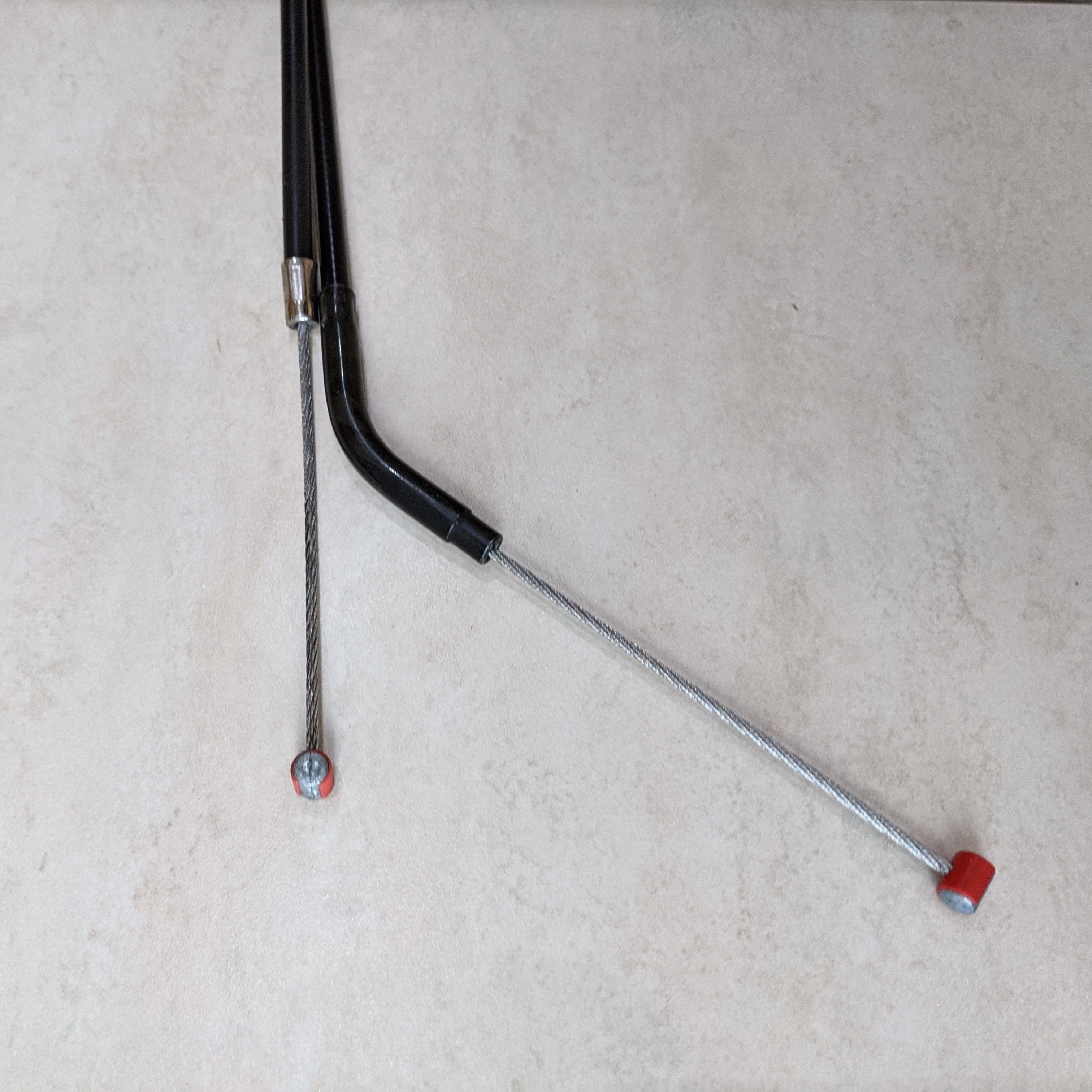

    This information may be useful for anyone changing their handlebars and wanting to know the differences in Clutch cable lengths.

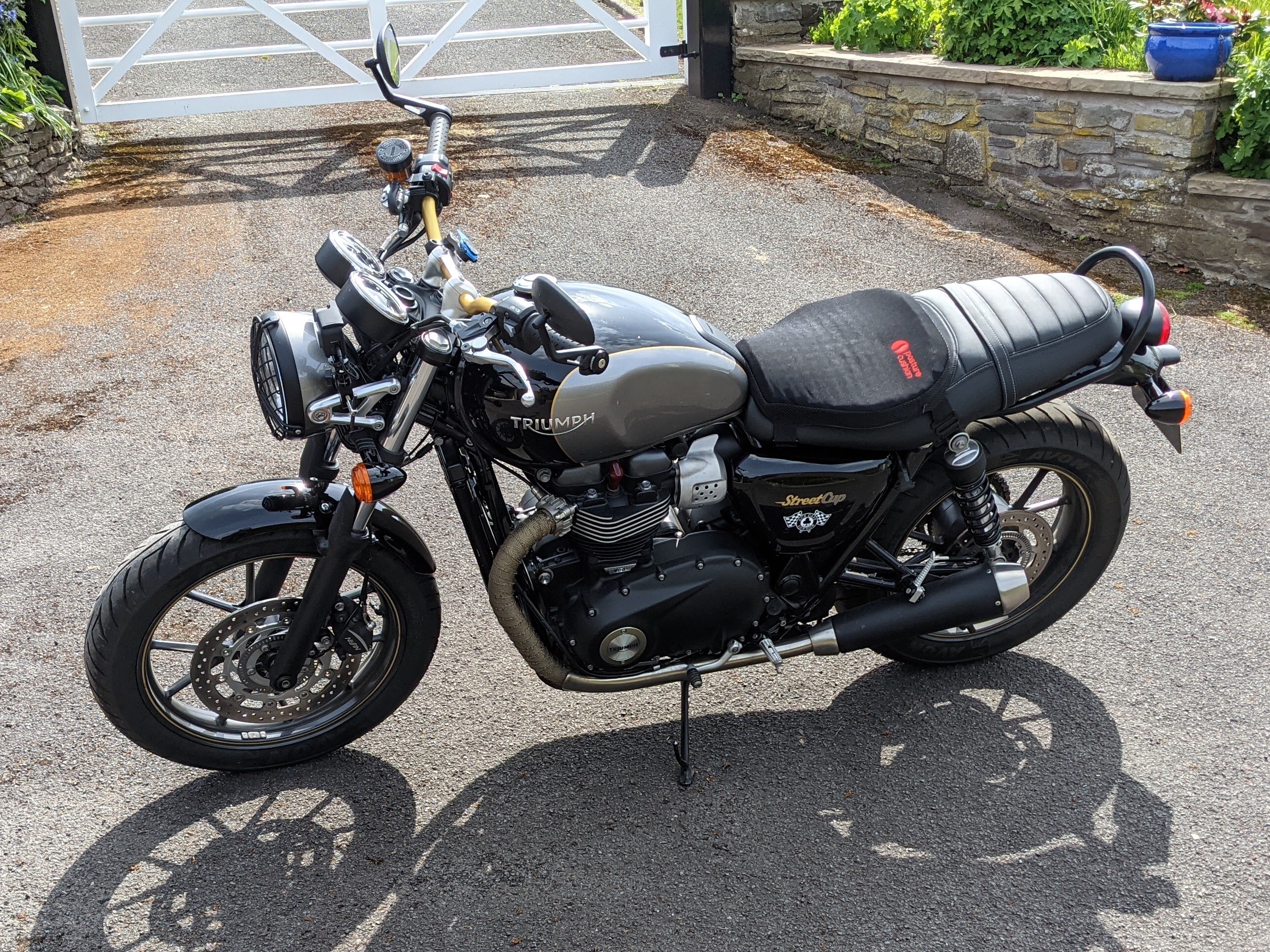

    I am putting higher bars on my 2017 Street Cup for a more comfortable Street Twin or Scrambler riding position. I have not made the conversion yet because my new Renthal bars are on back order. However, here are the differences between the standard Street Cup and Street Scrambler clutch cables.
    • Street Cup Clutch Cable (T2048890) - 108cm (black sleeve length)
    • Street Scrambler (T2048870) - 115cm (black sleeve length)
    • Street Twin (T2048869) - ??cm

    By way of an update, I have now fitted Renthal Road Ultra Low 758 bars (similar to the standard Street Twin height) and the longer Street Scrambler clutch cable (T2048870) I bought fits just fine. If anything it’s an inch too long but I got around this by routing the cable more generously under the clocks. I am sure the Street Twin cable would have been fine too but I was originally planning on slightly higher bars.
    Related to the bar change, I was able to get away with not changing the front brake line but it would not have reached with higher bars.
