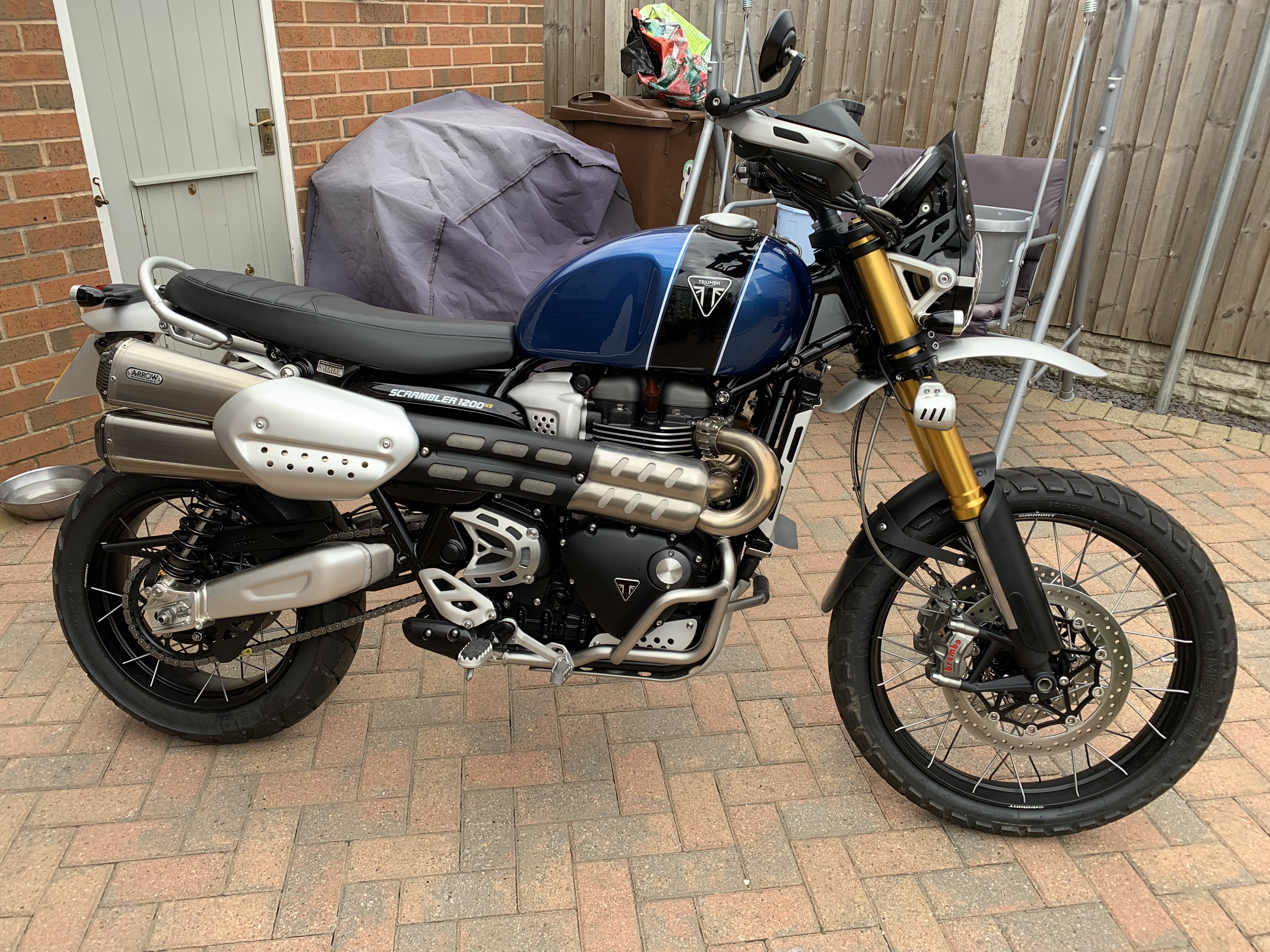

    Thanks mate got some on order now. It certainly looks good so i will give both a go and see which i like most. But looking at your bike i think it has to be good.

    Cheers joe, try it on your switches and plastic it keeps it looking like new, Tesco sell gt85 for £3 a tin.

    No more pics of your bike please as i am now considering chopping in my SS. ;)
