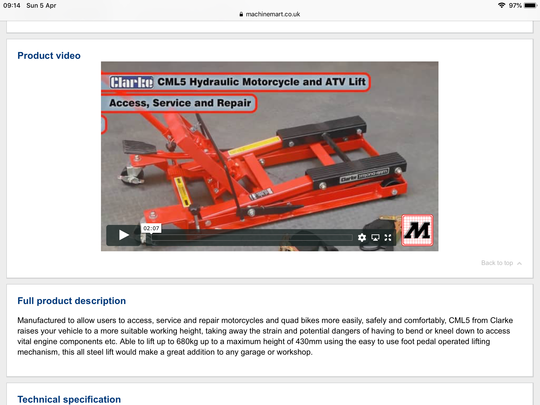

    I have searched the posts but cannot find much on this motorcycle lift.
    I am just considering a lift like this to lift my Speed Twin and also my new Rocket 3, I just want a lift to get both wheels up and get the whole bike a little higher for ease of cleaning and to enable me to be sat on a low stool. I am trying to find out if anyone uses one and how they find it? and of course anyone with any experience or knowledge regards compatibility with my bikes?
    Thanks in anticipation.

    I have had the sealey equivalent for about 20 years it's very handy and sturdy but more suited to naked bikes where the exhausts don't run underneath

    Ive got one and used it on my Bonnie without issues, just use a wooden block under the sump between the exhausts. Great bit of kit. Really well built

    I’ve got one that’s similar, bern great for my thruxton, with the 2-1 I have to use wooden blocks on the frame to clear the exhaust.

    thanks but that is a full length bench type lift - not quite what i was after.
    edit, i now see you put it was was the wrong link! sorry
