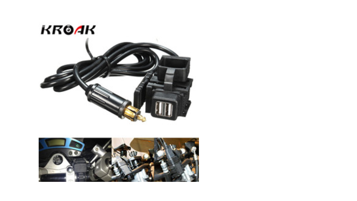

    Mine arrived today, looking forward to mounting it to use din socket.

    Nope still can not find a way to charge the Ghost X up .I brought a USB charger ,the standard plug with a USB port in the back but when I plug my Ghost X into the charger all it does is turn the Ghost X on and put it into record mode .It charges fine when I plug it in to my lap top .Might try one of those USB battery pack to see if that will charge it up

    Would something like this do the job ?
    External 200000mAh Charger Power Bank Portable LCD USB Battery For Mobile Phones

    That is what it does it goes into recording mode .I turn the camera off ,plug in the USB charger ,plug the camera into the charging mode ,switch the plug/usb charger on and the camera automatically turns on ,green light comes on then it goes red and starts recording but does not charge. The only way I can charge my camera up is to connect it to my laptop and it goes straight into charging It is a bloody mystery to me

    Must say Drift Customer Service must be the best customer service I have come across .I e mailed them last night ( Saturday ) and this morning ( A SUNDAY ) I received an e mail saying the problem was I had the Ghost X in CAR DVD mode and was told to switch the CAR DVD mode off. Which I have and BINGO it works .Thank goodness for that I hear you all shout .Thanks for putting up with all my going on and on and thanks for all your help
