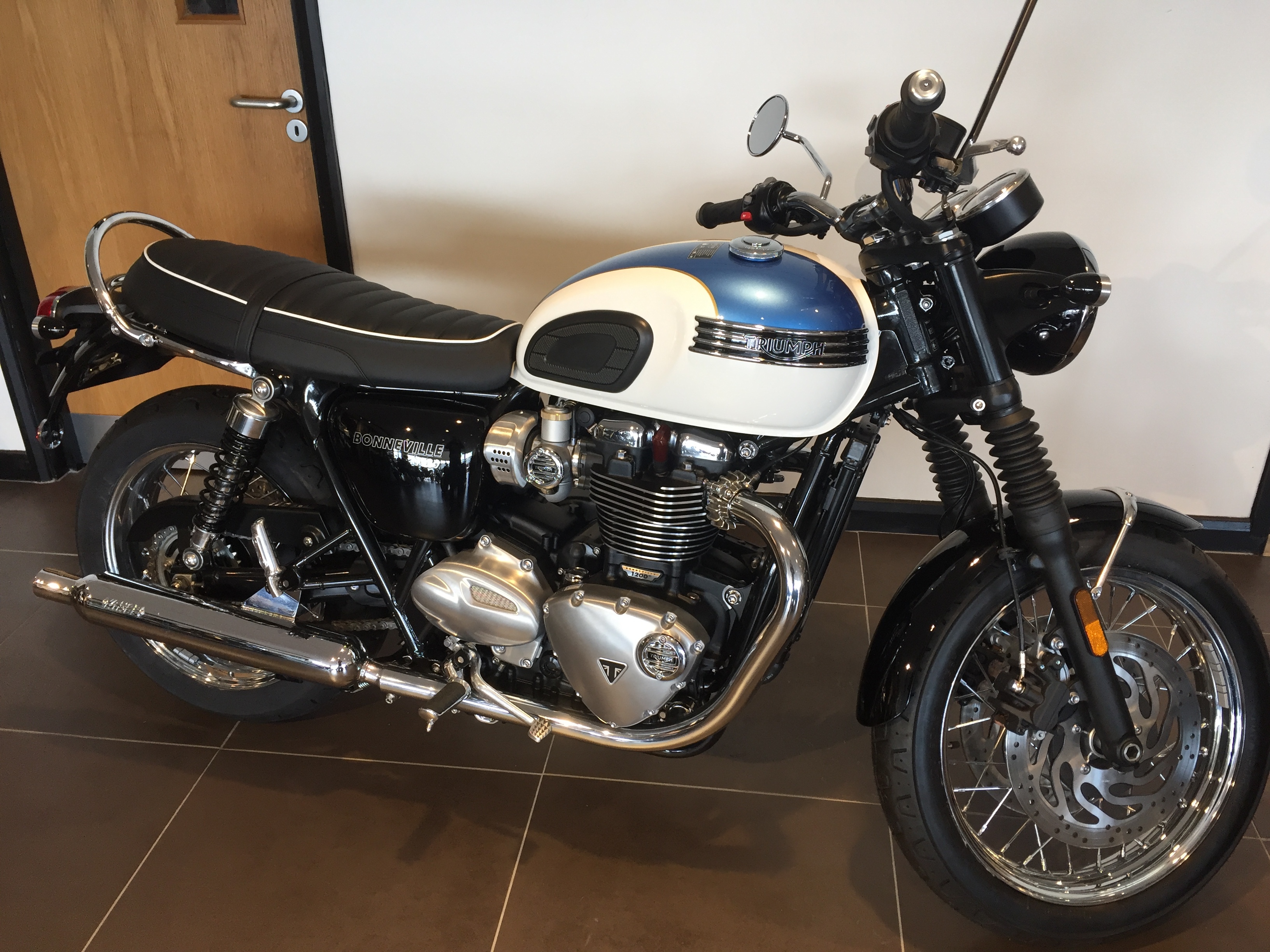

    Loooong story short: took a fancy to the Bonneville Speedmaster so took one out for a test ride, found it too low on the ground clearance but the memories of the 1200cc engine came flooding back...
    Back in the dealers there was a tricked up brand new T120 and after a bit of chatting I was offered it for the same price as a standard bike, so I've decided to trade in the LT and get back into the Bonnie fold again!
