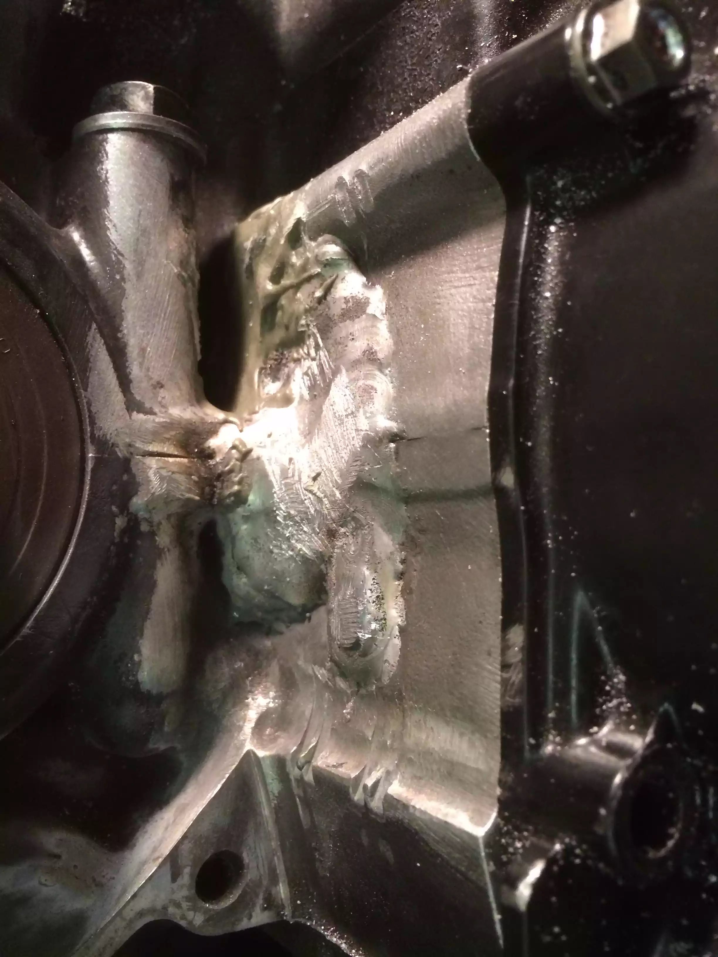

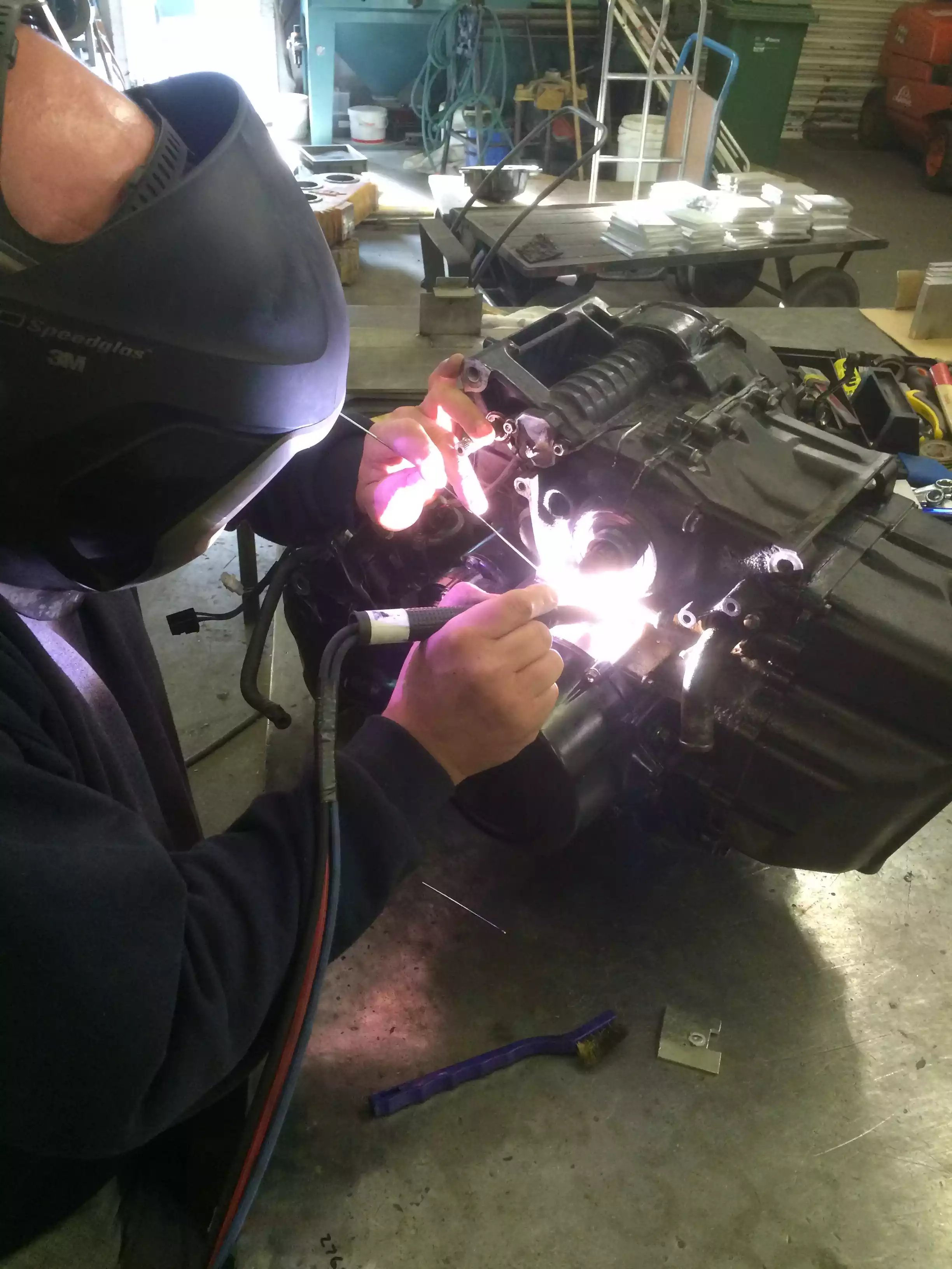

  5. James2015
    James2015 New Member
    Apr 29, 2015
    7
    United Kingdom
    #25 James2015, Aug 11, 2015
    With the sprocket off and an air dremel managed to clean the area up pretty well for welding. Took it along to this nice chap who wouldn't take my money off me. Will take a pic of the fix later but he's done a good job considering it was tricky to get at.
    The hole was actually over the parting line between the upper/lower crank cases so I dont think taking it apart would have been a good idea anyway. Fingers crossed I remember where all the wires go!

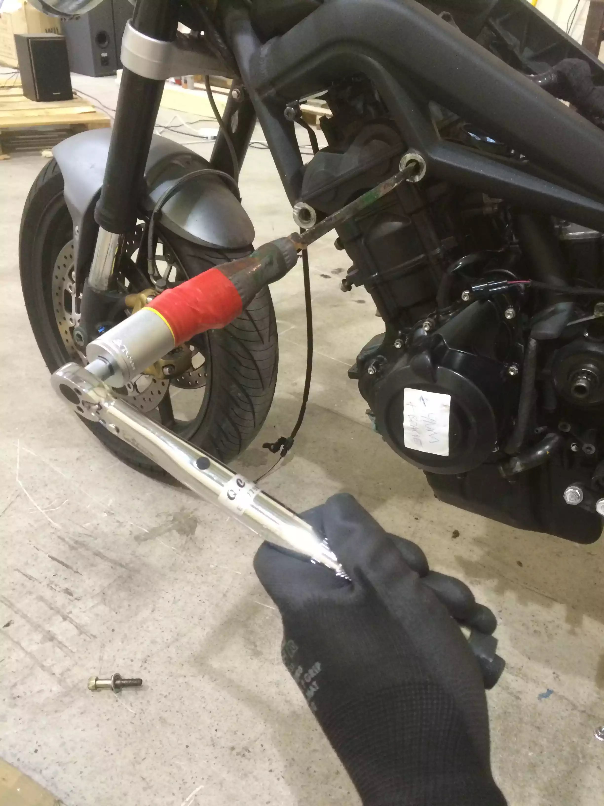

  6. James2015
    Apr 29, 2015
    7
    United Kingdom
    Anyone else used one of these triumph specialist tools? ;)
    Pic of the weld attached

  7. Havit
    9,702
    In short, no , any good?
  8. thebiglad
    5,072
    Someone has done a nice job on that repair ;):):)
  9. James2015
    Apr 29, 2015
    7
    United Kingdom
    in short, it's good for 10Nm....any more and you want to be thinking of upgrading to gaffa tape
  10. Havit
    9,702
    Back to the drawing board on that one, lol
  11. James2015
    Apr 29, 2015
    7
    United Kingdom
    On the contrary...10Nm was all those little spacers needed
  12. Havit
    9,702
    Then it's a good bit of innovation, the welds good by the way
