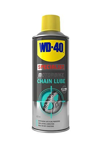

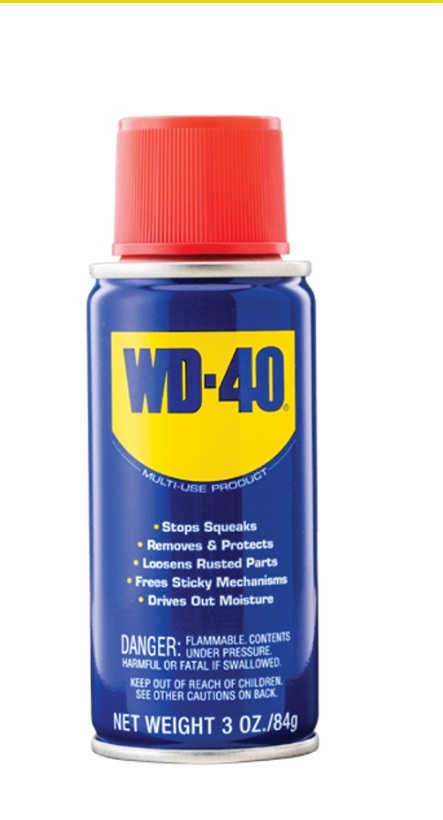

  9. Tiglet
    WD40 is a dam good degreaser, so any oil/chain lubricant will be removed with WD40.
    Don’t use it as a lubricant.

    Yeah, that's my point. If I use it from time to time to keep rust at bay I'm effectively taking off the chain lube. I think the solution is to lube more often and even just use my toothbrush n pot of gearbox oil inbetween full chain clean and re-lubes during the winter ! I just got to remember... don't eat yellow snow n don't put that toothbrush back in the bathroom
  16. Tiglet
    The guy was talking about using WD40 to clean his chain,,,,,so
