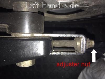

    no u were right i do have the LC version not the older adjustment

    i have the LC version, it isnt a thrux its a bonny but i know the LC version all have the same adjustments...i think, but yeh urs definitely is different from mine. i think you guys still answered my questions tho, thanks! ima give it another try today.

    Take no notice of my posts, they’re for the air cooled so the torque setting is probably wrong

    For air cooled 865cc - Delboy to the rescue
    I assume 2018 Thruxton is the same basic concept (probably more sportbike like now) but google the different torque settings.

    I use a collapsible wrench designed for car wheel nuts plus a 27 mm socket....I carry this in my Tiger 955i panniers. Don't like the idea of a puncture in a long run with no way of getting the wheel off the bike.

    Paddock stands for the rear wheel aren't that expensive, I've never tried adjusting a chain without the rear wheel being off the deck, I realise it can be done but its a lot easier with the wheel up in the air.

    True but don’t forget you might have adjust the measurements to compensate for the wheel being off the ground
