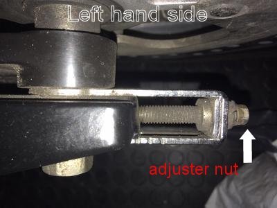

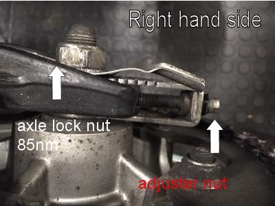

  17. crispey
    7,198
    Not such a stupid question as we've been confusing you all the way through! Just checked my thrux and there are no lock nuts, they are different. I'm assuming you have an aircooled thrux
  18. Vectis John
    Vectis John Well-Known Member
    Apr 17, 2019
    88
    Isle of Wight
    Sorry I wrongly assumed you had a new LC Thruxton. The adjusters are different. The principles are the same, adjust both sides as above. Sorry to confuse you. Good luck!
