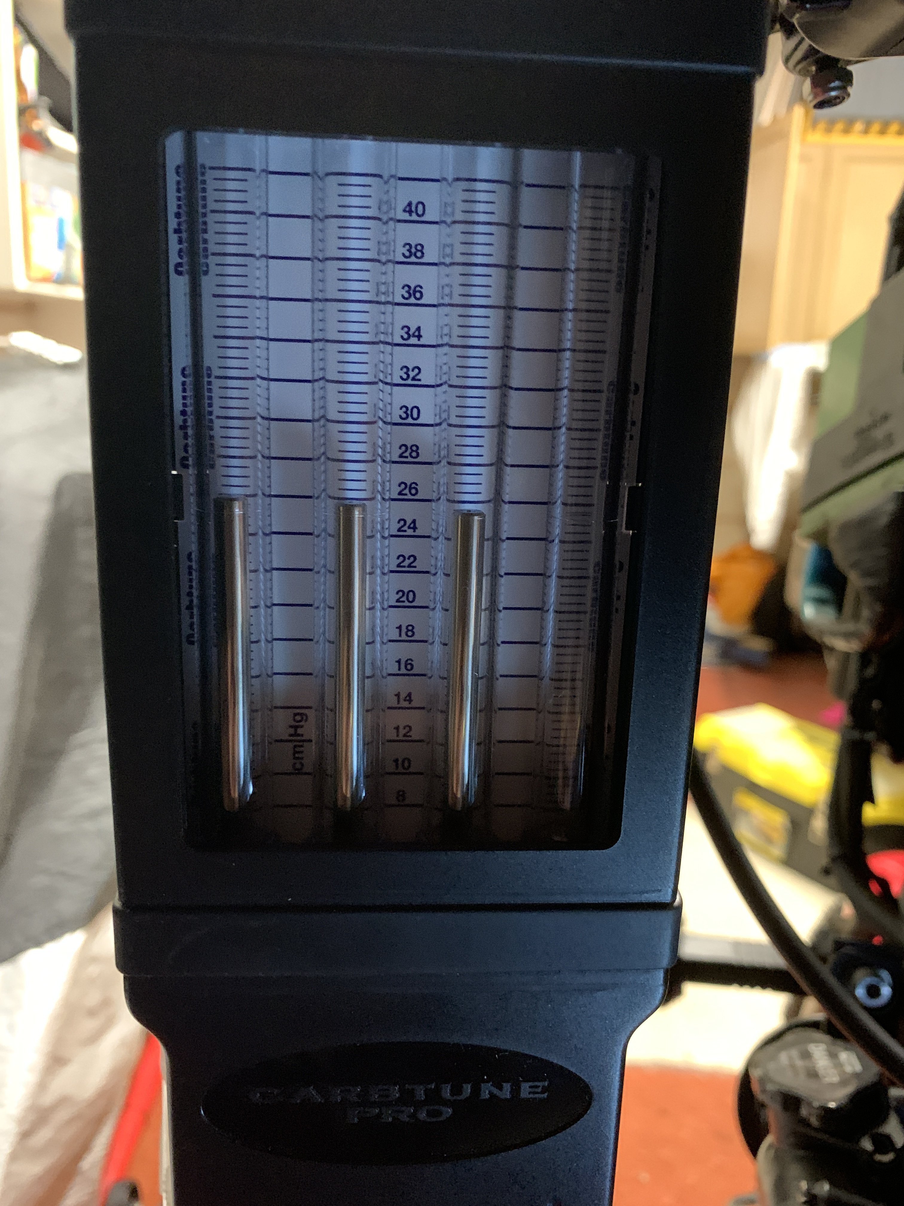

    Does anyone know what number of turns out the mixture screws are set to when they come out of the factory ? My carbs were 1 3/4 turn out but I'm sure I read somewhere it should be 2 1/2?
  12. Simon Logan
    Simon Logan Active Member
    Jun 13, 2020
    138
    33
    Sutton Coldfield - UK
    Hi Joe, I assume the nunbers don't really matter so long as they are all the same on each gauge ?
  13. Rocker
    Rocker Elite Member
    May 1, 2016
    1,667
    Suffolk
    Correct
  14. capt
    capt Elite Member
    May 8, 2016
    3,051
    western Australia
    The higher the numbers , the greater the vacuum ! Higher vacuum reading = healthier motor ! Shows how good seal on rings and valves are !!!
    Fluctuations in vacuum can be highly indicative of valve seats or spring condition on cylinder that 'bounces' at higher rpms of course.
  15. Simon Logan
    Jun 13, 2020
    138
    33
    Hi, I didn’t know that. Do the readings look ok? I had the valves checked and adjusted along with a compression check which was also good. I know nothing about carbs so was really happy that I managed to strip,clean and replace all the parts and it still runs !! There was brown gunge leaking from somewhere underneath the carbs which has also stopped. The O rings in the mixture screws for 1 and 3 had perished which is where I think the gunge was coming from. I’m an expert in getting the carbs out now....30 mins

    In the vid he should have gone back to 1 and 2 again I'll guarantee they would be slightly out again.
  18. capt
    capt Elite Member
    May 8, 2016
    3,051
    western Australia
    All 3x are almost = and we'll within specified normal range.
    There was a chart that gave likely caused for various vacuum readings and when vacuum fluctuations were in evidence , what different ranges of fluctuation levels were caused by.
    I think I'll look through my course work/notes see if I have a copy
