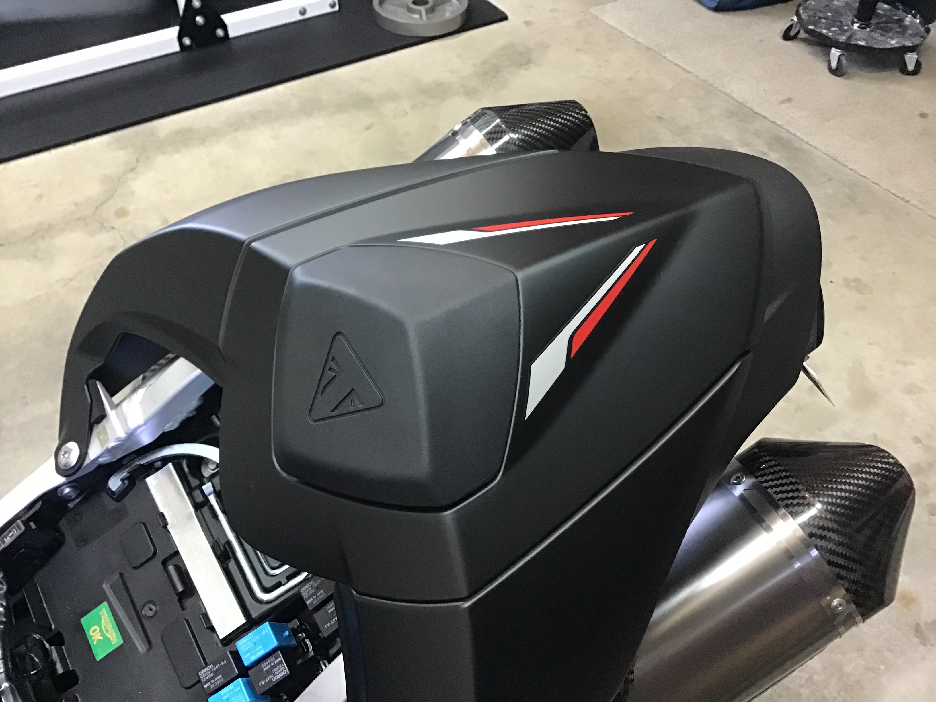

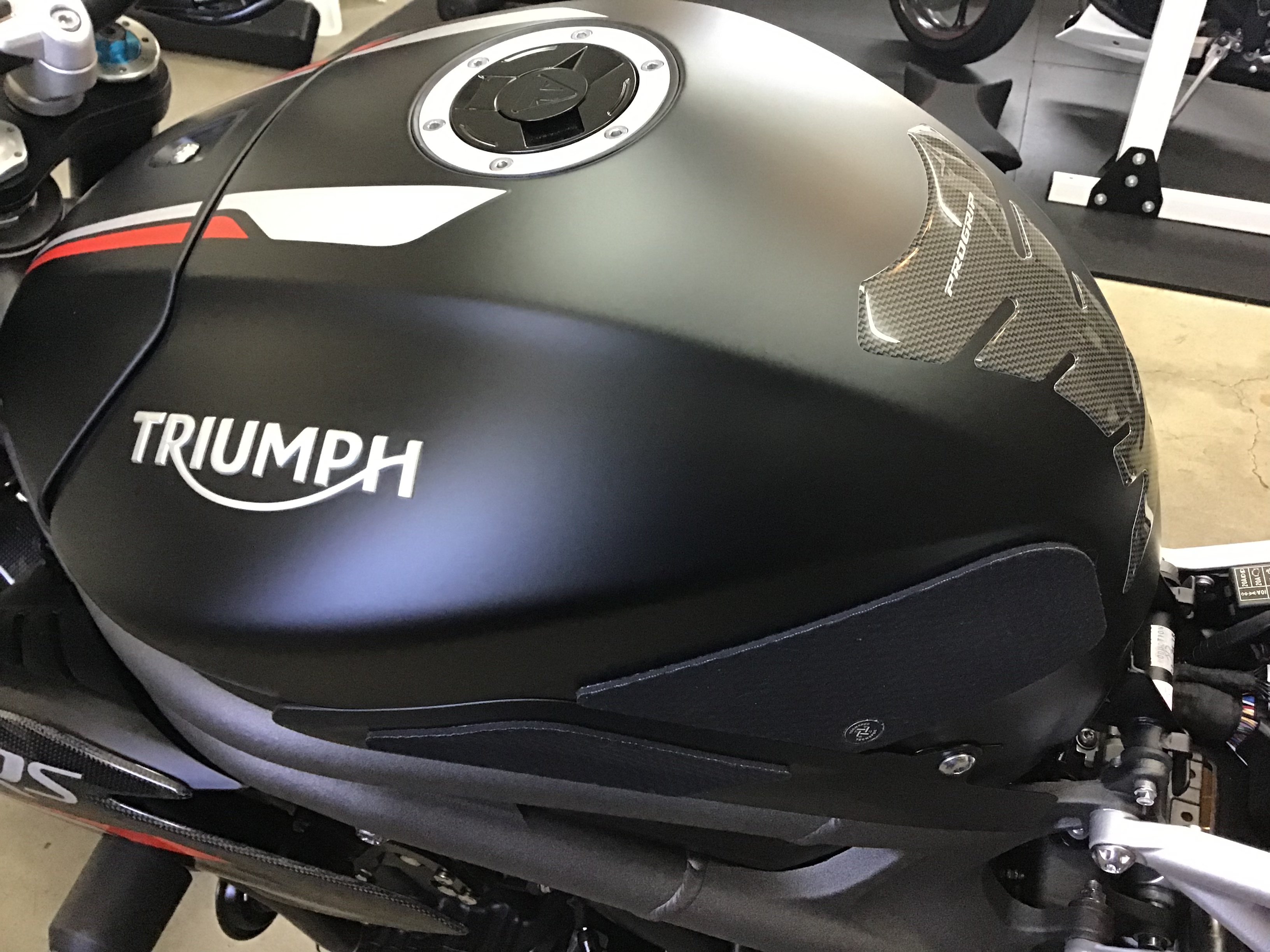

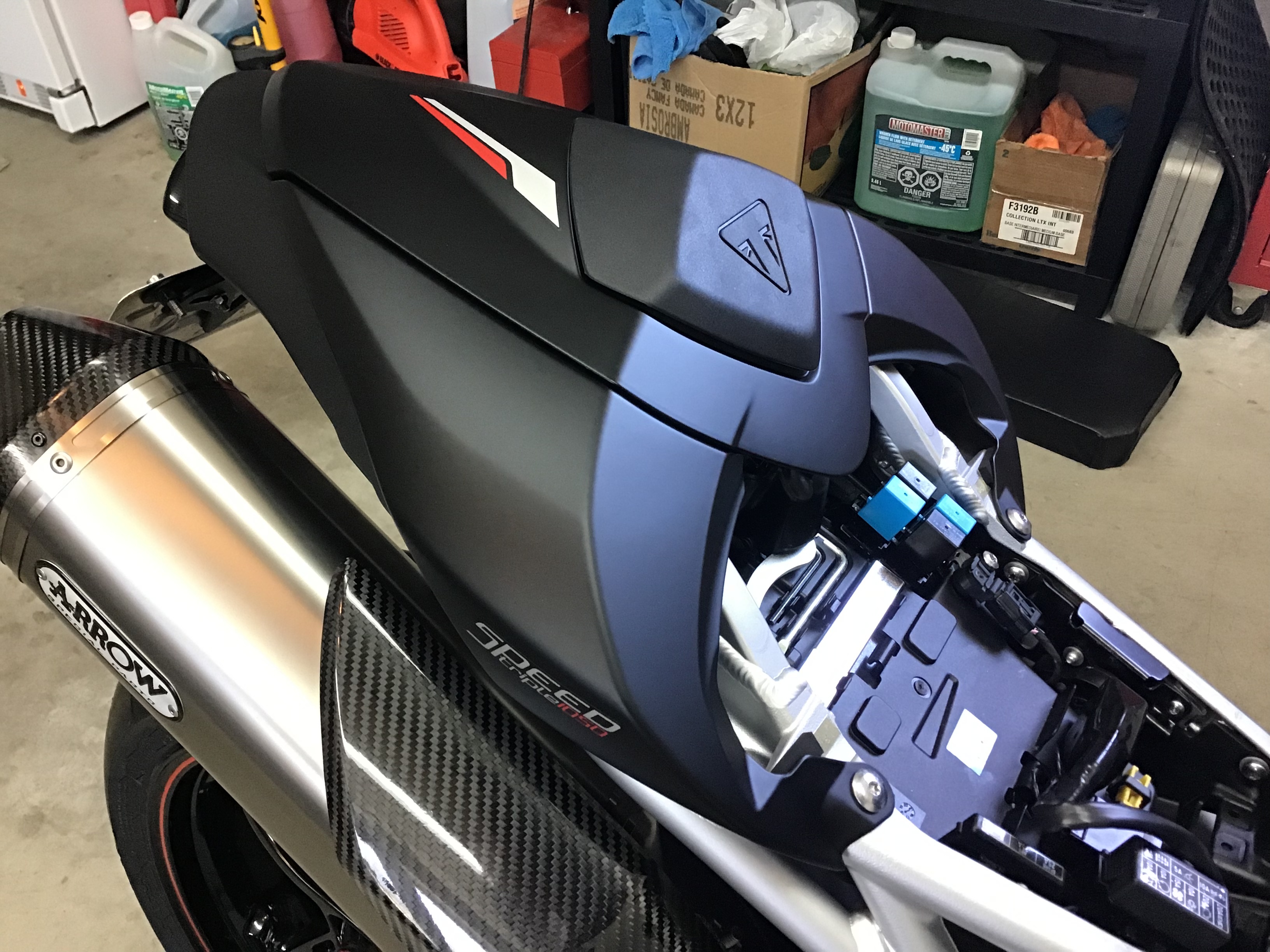

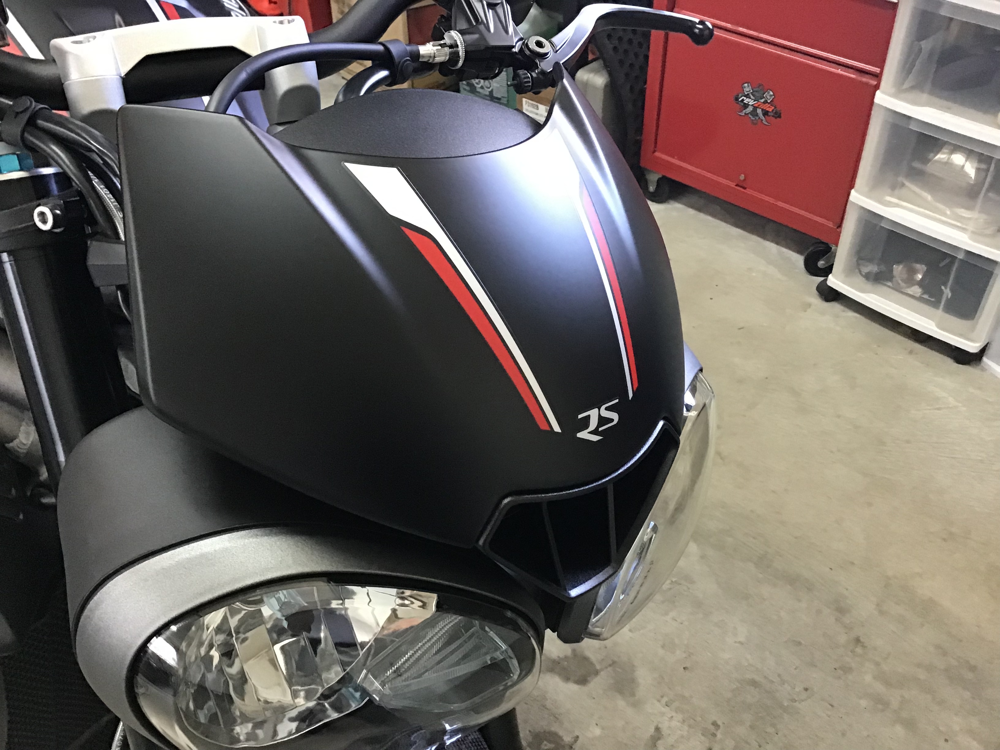

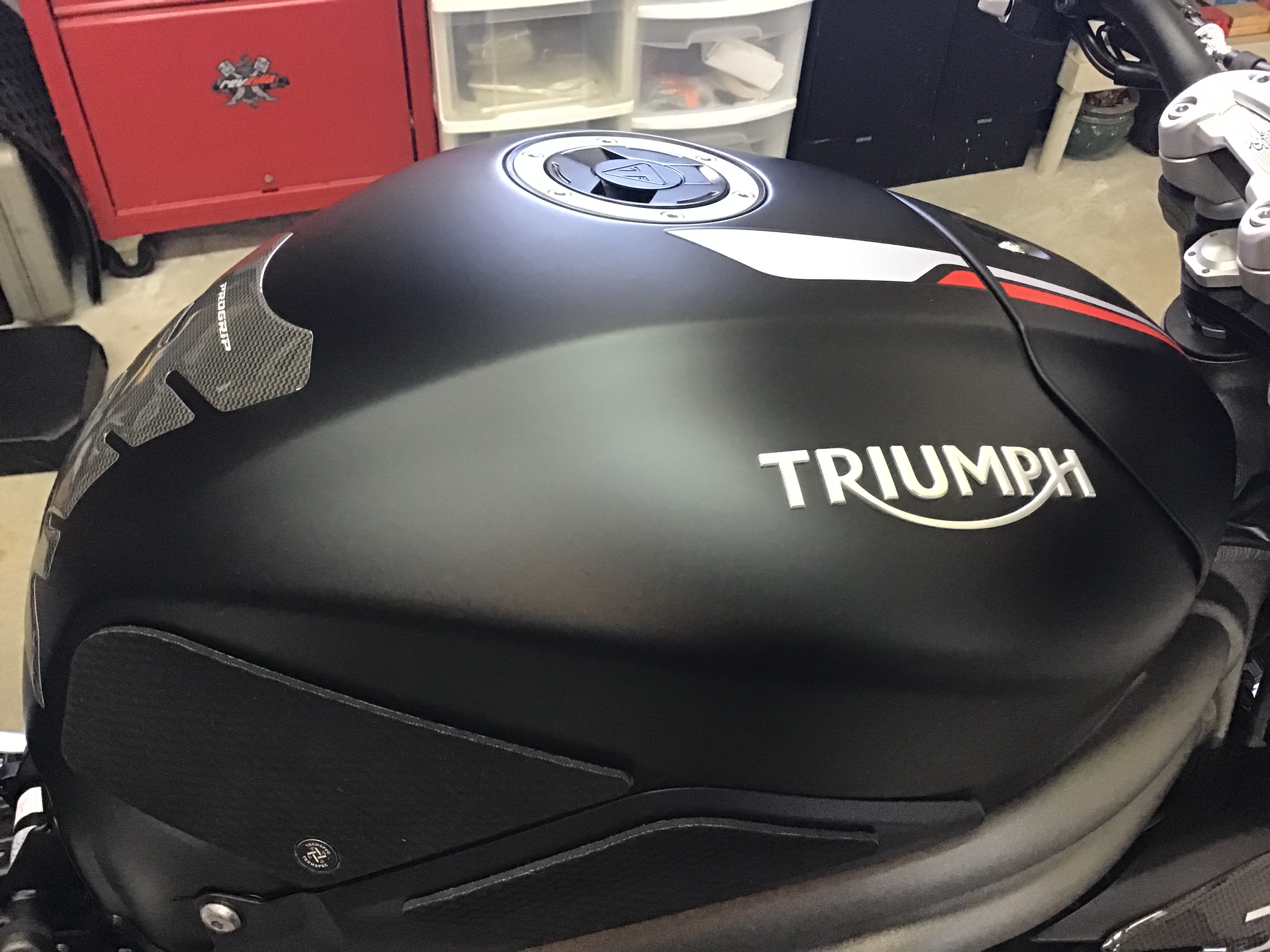

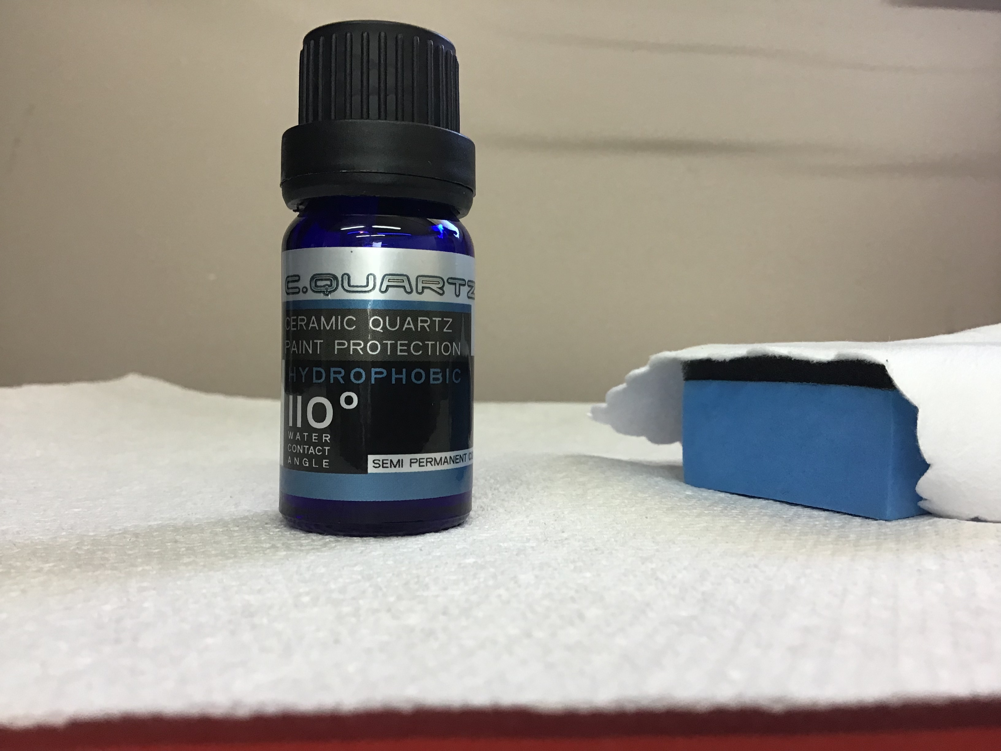

    Finally got some semi-permanent paint protection today. After researching everything out there I decided to order C.Quartz Paint Protection. It provides additional UV Protection as well as being very hydrophobic. It was $30 Canadian for a 10 mil bottle, of which I only used about a third, and it was applied to all the black paint as well as all the carbon and the front callipers. It’s a semi-permanent clear coat that lasts up to 2 years and adds up to 50% more scuff resistance (micro marring) to the paint. A good idea for Matt paint in my opinion. It’s applied with a suede cloth in a crisscross pattern for even coverage, then allowed to flash off before a gentle wipe with a microfibre cloth to knock off any thick areas. Although there are a few products specifically designed for Matt paint, this is a more permanent product that can also be used on Matt paint. As you will see in the photos it doesn’t add any additional shine to the paint, but it does make it slightly darker, which l like. For some background here I use to operate my own detailing business for over a decade and have applied these types of coatings many times, so I have a bit of an advantage I suppose. These coatings have to be applied correctly otherwise the outcome may not be desirable. If the high spots are not evened out they will be obvious when it dries, and because it’s basically permanent you can’t repair it on Matt paint, as it would have to be sanded off then polished. Anyways, enough of the rambling about the process and on to the photos. You may not notice any difference at all, but that is a good thing. In person during the process it is noticeable though.
